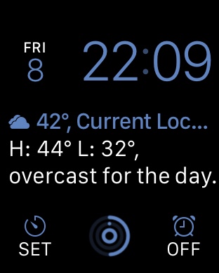

My location info has been showing/working all day. I have been in the same location for the past 6 hours. Now all of a sudden the complication says "current location" even though the app properly states my current location name. Manually updating the app and manually selecting my current location won't update the complication even though the app says it is. Is this a bug? The location data is set to always.
59f658553145aa5e3a92e910d4fb1caf.057623
147daf12ce1120b3040b66c1f447339f.727935
I got that today a few times. Also got "unknown location" a few time. For the most part it worked and updated. I was in Nashville for about 2 hrs before it updated once but still worked.
Yep, it happened to me as well while I was out. Will look into it for the next seed.

Ok so I have been in a different town for 2 hours and just picked up my watch only to see the old location still on the screen. It never switched to my new one. I tapped the complication and the app refreshes itself to the new location. Then the complication changed. So even with background app update on and location services set to always, the location and weather data isn't updating as it should. Mostly the location data, since the weather data corresponds to the location.
