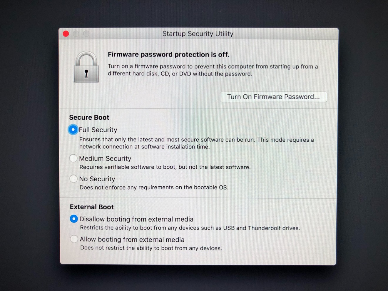

Before you attempt anything like this, be sure to disable security and allow external media boot so you don't get locked out...

According to the article unless you boot into recovery and specifically disable the 'trusted operating system' security setting the machine will not let you install 10.12...Searching the web, this seems to be the overall consensus... 10.12 can't be installed on the newest MBP and iMac Pro due to the security requirements of the T2 chip...
