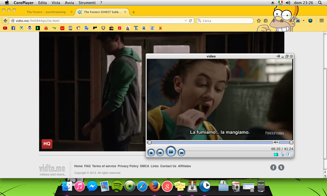

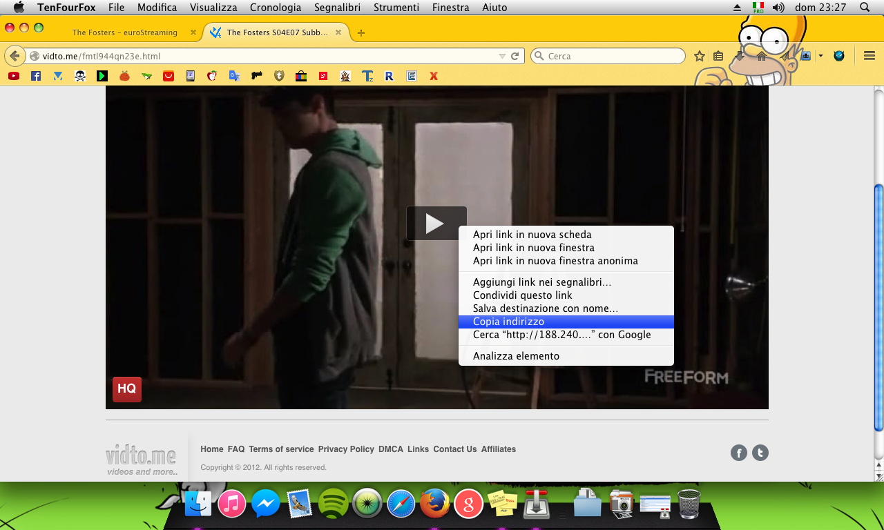

I get "HTTPS protocol not supported" when I've tried streaming with it.
just tried, it works beautyfully
Yeah sorry, i did not specify it earlier. I have user agent overrider to make sites think i have a smartphone and since on them there is not the flash player streaming sites often give you direct links to download the movies... Just copy these links in coreplayer or vlc and it will play. This thing works also with every direct link to download a movie.
