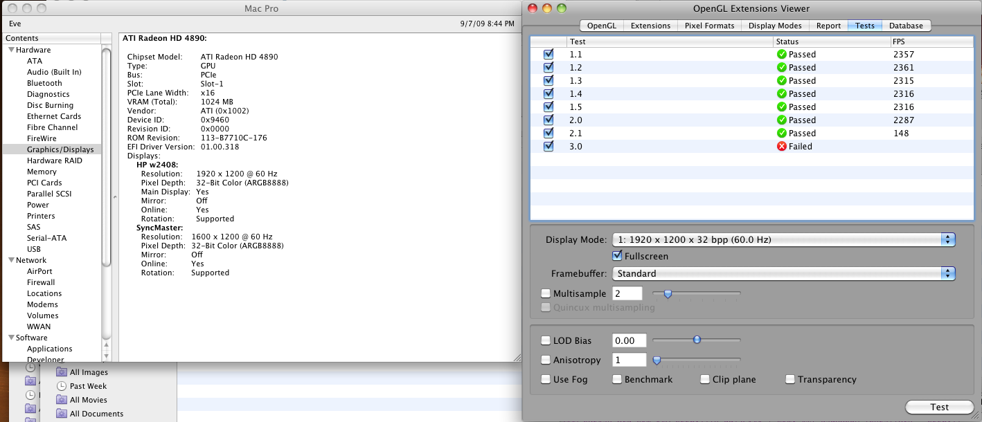

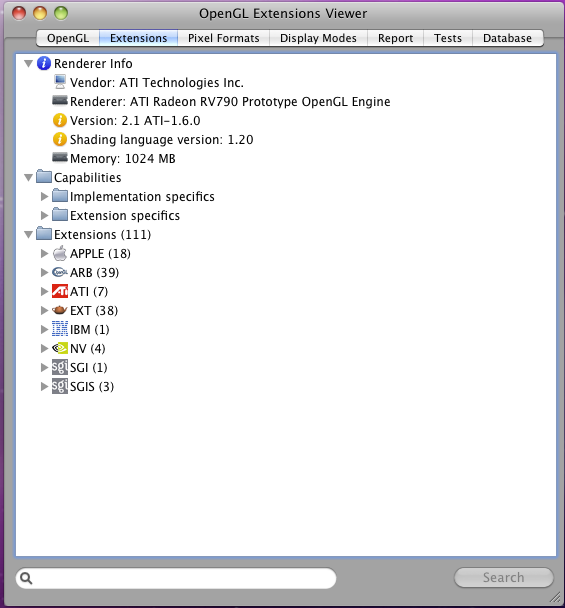

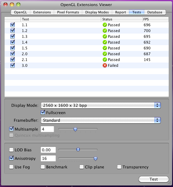

Just did a vanilla install of Snow Leopard on my 2008 Mac Pro and flashed Sapphire 4890 with excellent results.
Worked out of the box - just no QE/CI.
Installed the Modified Kexts and that solved it.
Here are my results from benchmarking:
