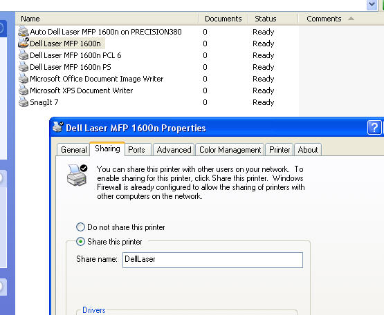

Wired Printer?
Has anyone gotten this working on a wired, non wireless enabled printer? It works perfectly on my wireless HP, but when I try to print from my wired lexmark, I click print and it just says waiting for printer.
I downloaded the elpam,my printer now shows up on IP4, but does not print. Shows the lock symbal, but I have it shared. I also have the printer wired to the back of my router, I can print from my pc and playstation but not the phone. Any ideas for me??????
what OS?
elaborate on how you have it shared?
I have XP, and have a network printer shared VIA my XP machine. (having a network printer alone is not enough).
(note, if you have done this already - I have no further advice - sorry)
Must be shared a la
