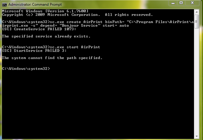

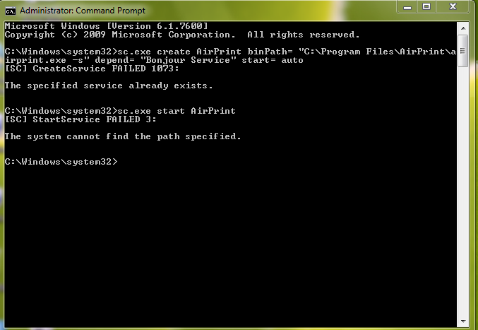

I ran the following to remove the service:
C:\Users\Jim>sc.exe delete airprint
[SC] DeleteService SUCCESS
C:\Users\Jim>sc.exe create AirPrint binPath= "C:\Program Files (x86)\AirPrint\ai
rprint.exe -R _ipp._tcp,_universal -s" depend= "Bonjour Service" start= auto
[SC] CreateService SUCCESS
C:\Users\Jim>sc.exe start airprint
SERVICE_NAME: airprint
TYPE : 10 WIN32_OWN_PROCESS
STATE : 2 START_PENDING
(NOT_STOPPABLE, NOT_PAUSABLE, IGNORES_SHUTDOWN)
WIN32_EXIT_CODE : 0 (0x0)
SERVICE_EXIT_CODE : 0 (0x0)
CHECKPOINT : 0x0
WAIT_HINT : 0x7d0
PID : 10064
FLAGS :
after that I run the AirPrint.exe and get the same error as in the quotes.
