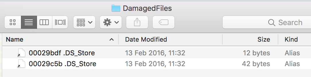

Once, I noticed that there was a "DamagedFiles" folder on the root of that drive with two tiny unreadable files in it.

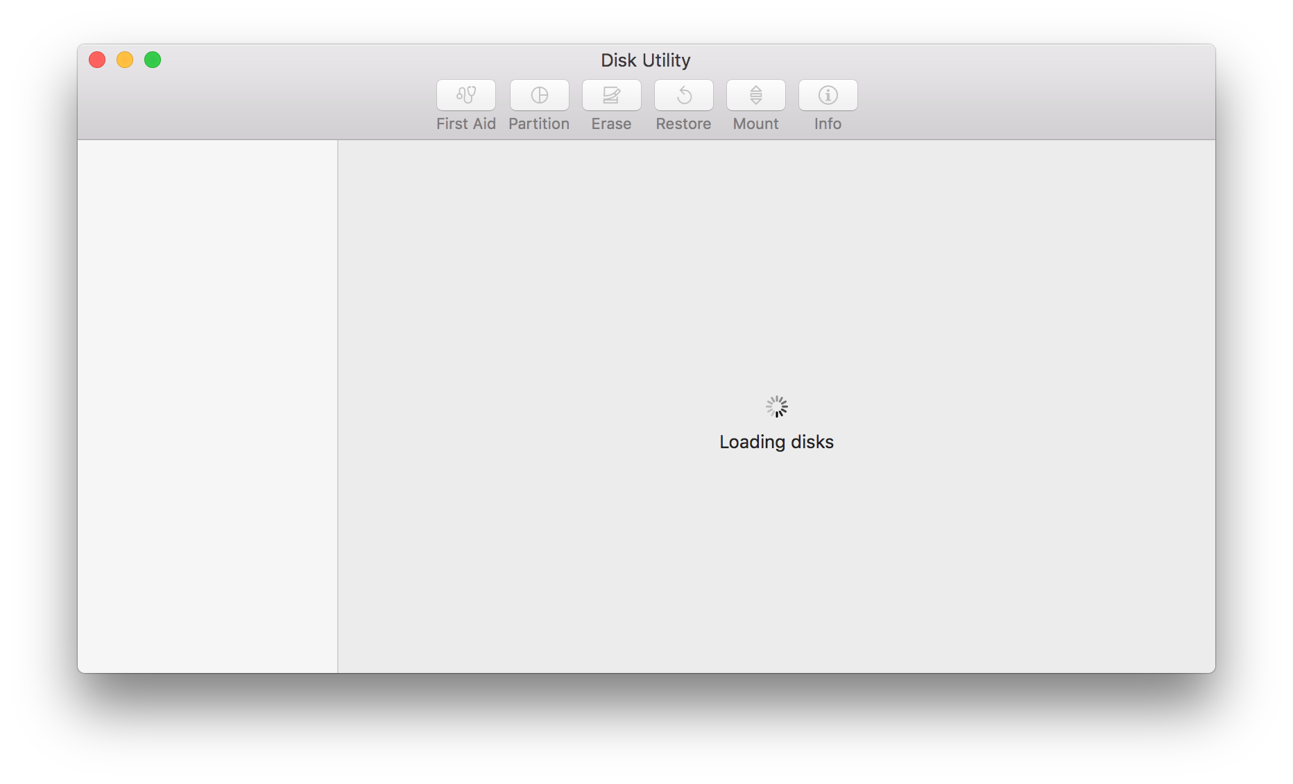

When I open Disk Utility while it's plugged in but not mounting, Disk Utility refuses to load anything, it just says "Loading Disks" and I can't use it at all, like this:

Then eventually (in about 10-20 minutes) the drive stops whirring, fsck_hfs stops taking up 70% of CPU, and the drive mounts on its own and Disk Utility starts working again, reporting no issues.

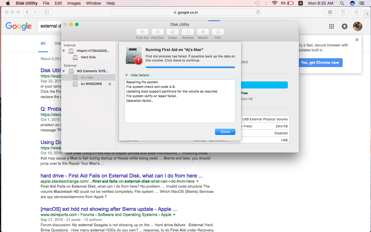

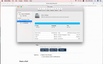

I then realised that it shows Free Space : 0kb on this partition. Hence backed up my immediate next partition Aj Mixed and then deleted it to increase the size of Aj's Mac. It stands at 895 gb now and still greyed out, with Aj Windows still mounting.
Also tried First Aid, result in the picture attached.
Please guys help me out, i really need this partition, its got all my DATA! :(

Leave it plugged in for an hour or two, maybe it's the same issue as what I was posting about. Is your disk apparently "doing" anything (blinking LED, noise) when it's plugged in, even though it's not mounting? If yes, then let it sit like that for as long as necessary, and maybe eventually it will mount. If it mounts, back it up immediately and replace it.
