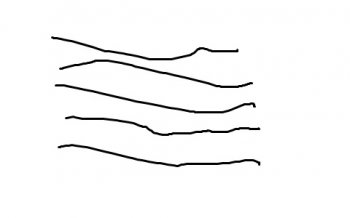

Whenever I do a 3-finger drag and then let go of the trackpad, sometimes the cursor "jumps" a few pixels in a random direction upon release. This makes it hard to use the drag function for precision movements.

When you release a three-finger drag, there is sometimes a slight jump of a few pixels. Please let me know if you see the jumpiness. It only happens at the very end, upon release.
I drew some lines in Microsoft paint to illustrate what is happening. If you notice the ends of the lines, sometimes there is a slight up or down movement caused by the jumpiness.
@santokki: yes, of course there were changes since September. I just responded to you via email, sent the test version where small square of finger is ignored for 3-finger drag. But have to tell, I did the paint test before and after, and to me the behavior of 3-finger drag was OK as is. Also there were no such reports from other people yet. Maybe something also depends on the very individual characteristic of the fingers, like if I play guitar too often the fingers definitely change. Please check and let us know :)
Hi Vladimir, thanks for the quick assistance! I tested out the new version you sent me, and it seems to help a lot. It doesn't completely eliminate the jump upon 3-finger release, but it seems to make it smaller, and sometimes it does eliminate the jump occasionally.

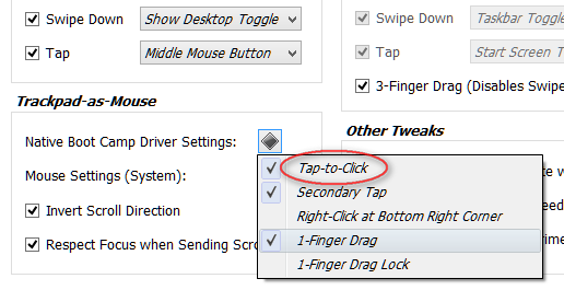

Thanks for the program. Before I send a donation I need to figure out a few things. First, I can't seem to make the one finger tap work for me though it is working on the Dell laptop (Windows 10) at work. I have a MagicTrackpad2 and successfully installed your software a couple of weeks ago. I'm definitely new to PCs, so this will help me function better on the Dell.
So, the one finger tap is a must, and I don't see it on the ExtraMagic preferences.

@pmbooks: 1-finger tap is there and shall be active by default. Please click the rhombus button in the ExtraMagic Settings app in order to access the shortcuts to all basic settings:
2-finger scroll is also there and in fact cannot be DEactivated. As I understood, something went wrong, because the basic features do not work for you. Please note that those are only controlled through ExtraMagic Settings app, but they are actually the features of the Apple-provided Boot Camp driver (Step 1 of the ExtraMagic installer).
Maybe try to re-run the Step 1 of the installer, and then Step 2, to make sure all is installed properly.
