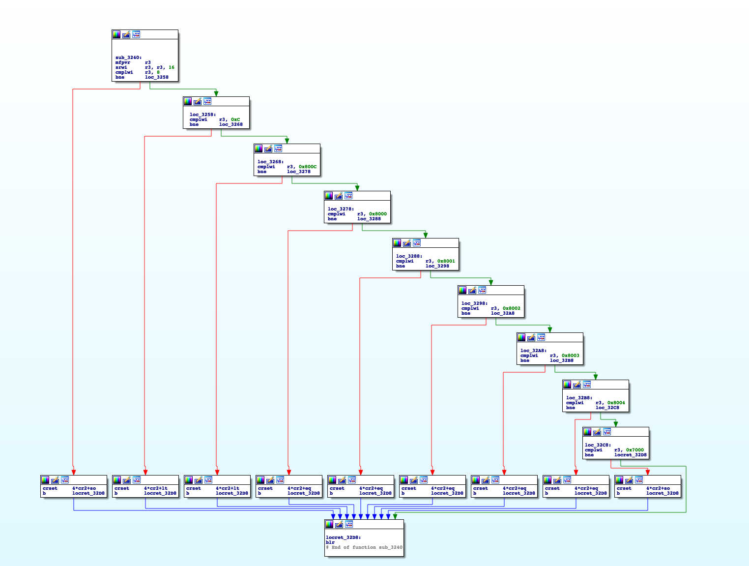

And yeah, they way Apple implemented this check is really weird. All they do is check whether or not the PVR is "greater than", "less than", or "equal" to the CPU PVRs Apple determined were compatible. All it does is set the condition register 2 (CR2) to have either the "gt", "lt" or "eq" bit set based on this determined state (or "so", "summary overflow/exception"). The calling function then checks if the "eq" bit is set, and if so, proceeds with boot. Otherwise, system halted. The "lt" and "gt" bits are never checked.

I would not worry too much about DFS, since AFAIK its only sets it if the BootROM knows what the CPU is , and even once patched the Mac does not fully know what the 7448
note the iMac calls the 7448 "PowerPC 60?" because although the BootROM is patched not to halt on the unknown CPU, its still not patched to actually recognise the CPU (although in theory that could be patched in too)
(the PowerPC 60? is the name OpenFirmware gives to an Unknown CPU as you can tell from the fact it says 60? it goes back to the earliest PCI Mac days :) )
so in the case of a PowerBook I suspect it wont know that the CPU supports DFS and there for wont enable it etc
(but on the Mac Mini front indeed I have set-dfs-high and set-dfs-low as words, but OS X nor Linux sees the CPU as DFS capable, do wonder if you could manually poke the register and force it DFS low or such)
and on the DLSD, its well documented that it handles power management and CPU speed scaling in OS X differently from all other PowerPC macs
and last night I got a Dump of my DLSD's BootROM to @dosdude1 where he disassembled it and found that the DLSD does look to natively support the 7448 which is very exciting!
this means in theory all we need to do is solder a 7448 on and it should work out of the box with no BootROM patching :)
I had a theory that the DLSD may have supported the 7448 natively because even tho it never shipped with it, it was clear apple was flirting with the idea for example if you look at the schematics of a DLSD they do make reference to the 7448 and its options
so its very cool to see it referenced in the BootROM as well :) which you can see in this chart @dosdude1 put together of the CPU support in the DLSD's BootROM
and I have often wondered if the unique Power management of the DLSD in OS X was a remnant of leftover 7448 support and its DFS 1/4th mode,
it is worth noting tho that OS X will not natively boot/recognise on a 7448 like it will on a 7447A, you have to include additional NVRAMRC patches for OS X to boot on a 7448 (which we take manually from the newer-tech firmware patcher as the GigaDesigns one does not apply it)
but I wonder if the DLSD takes care of that automatically or if we will need the NVRAMRC patches still, will be very interesting to see :)
