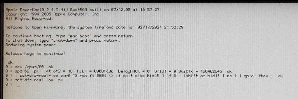

I can try it if you'd like. So I boot into OF, then type all that, then what?
Boot into OF:
Code:
dev /cpus/@0 // Make the CPU the active package
spd // Check the HID1 to see what DFS mode we are in( full/half/quarter)
: set-dfs-real-low pvr@ 10 rshift 8004 <> if exit else hid1@ 1 1f 8 - lshift or hid1! 1 ms 4 1 gpio! then ; //We define the word and the function of set-dfs-real-low
set-dfs-real-low // We try to invoke setting HID1 bit 8 to 1 and wait 1 ms for the GPIO
spd // we check the status of HID1 agian, and if things work we will see that bit 8 is set
Note: Everything after // is just my notes, don't type // or that which comes after.
This is on the mini:
It locks up at this point and doesn't do anything until I reboot it.

Ok we would expect to se HID1 = 808xxxxx, so I've got the code wrong for our set-dfs-real-low function.
Let me ask around and see if anyone can help out.

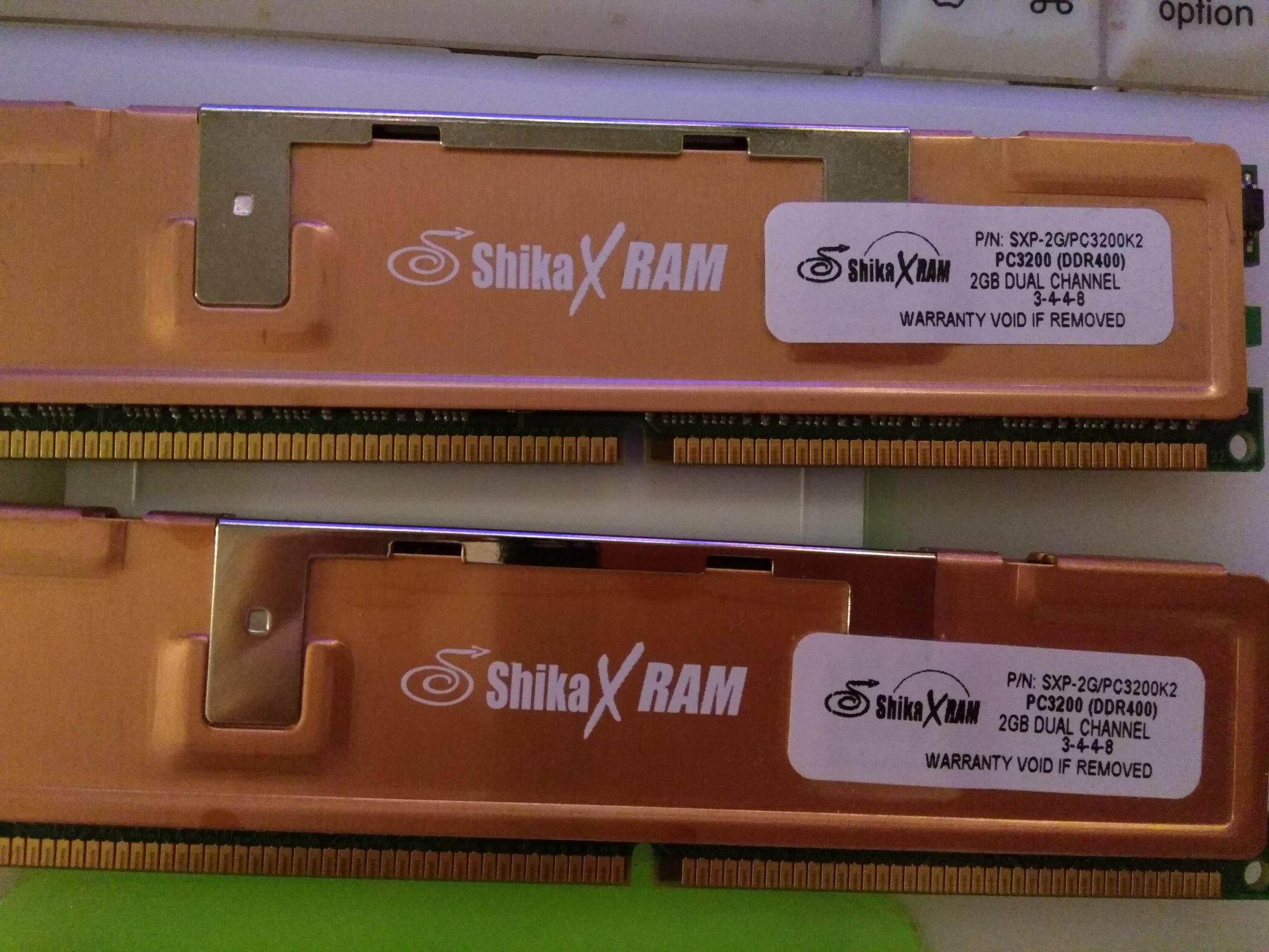

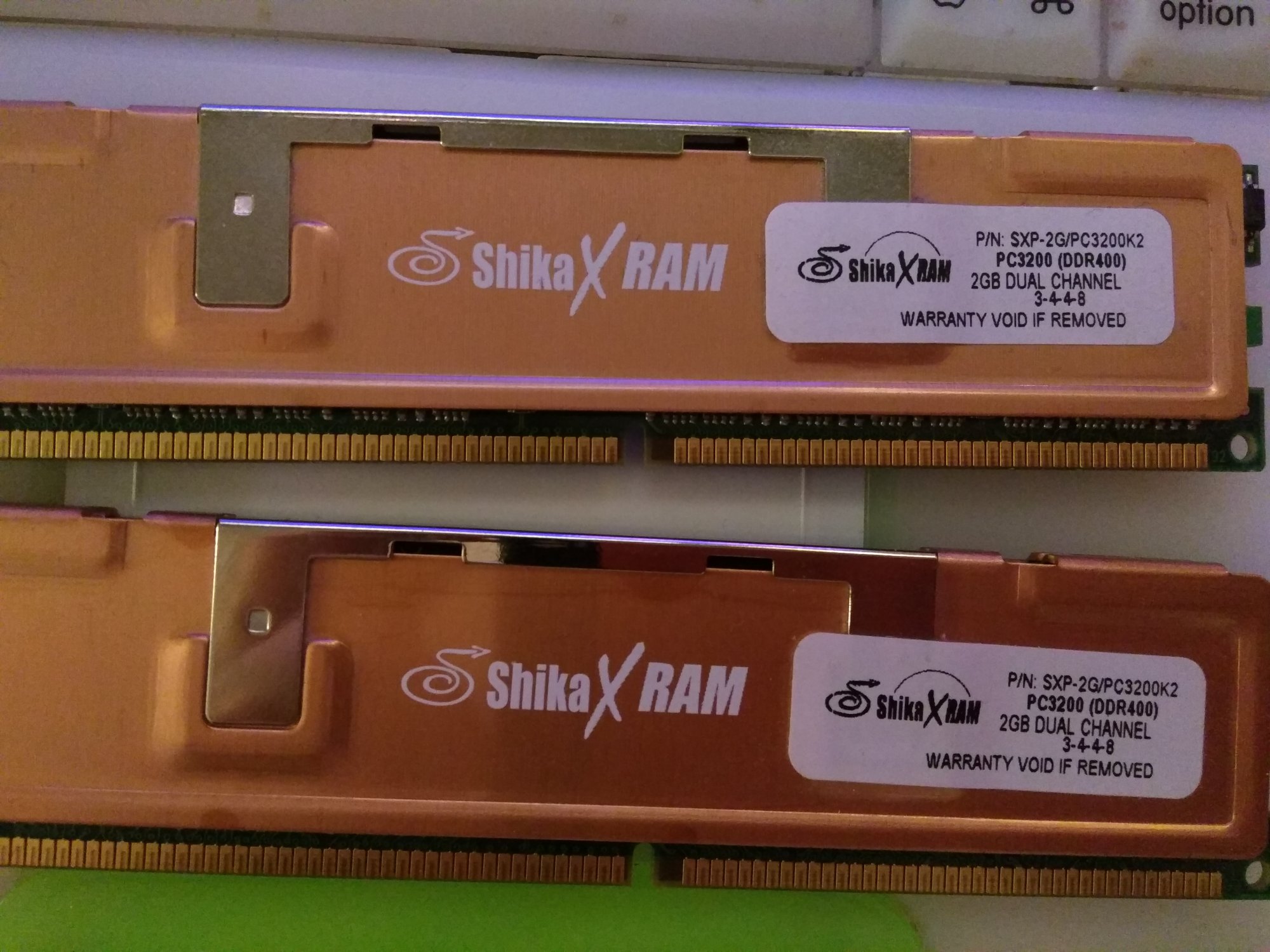

I’m pretty certain that’s what I pulled out of my June 2004 G5 (following contortion-level troubleshooting behind the probable cause(s) of KPs due to overheating in my nominally hotter-than-average tower. I pulled them out because all the other slots were filled with PC-3200/333MHz 1GB sticks, and these two were the oddballs (and were only recognized as 1GB DIMMs by the G5).
Was this what you were looking for?

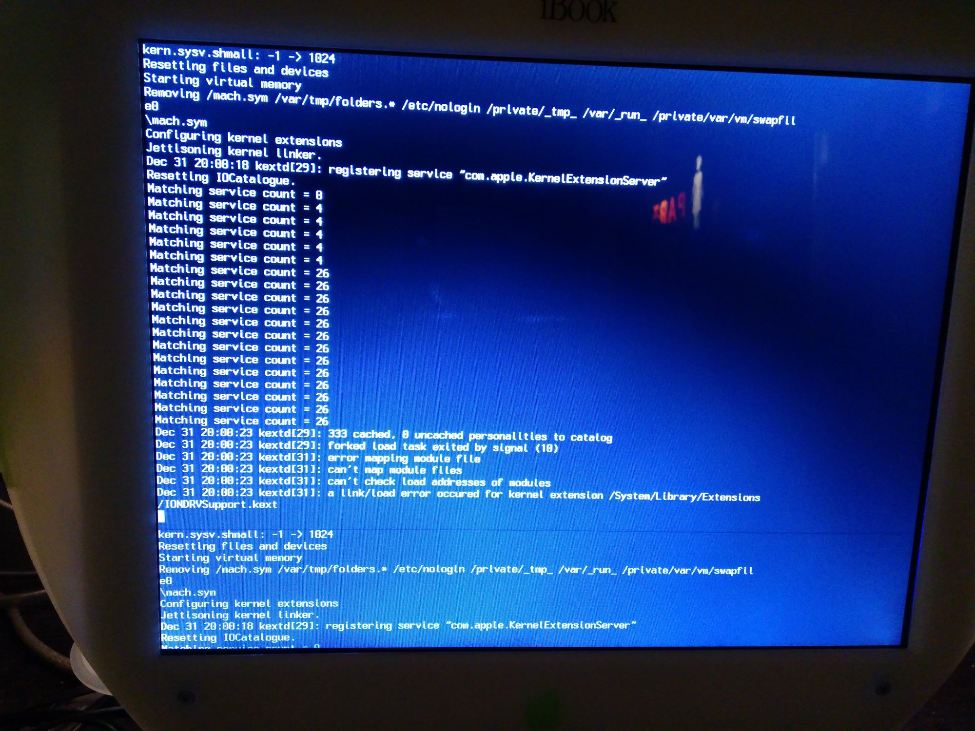

By using this thread’s graphite pencil method in lieu of the resistors, I finally got past my hesitations and went ahead to try to overclock my key lime clamshell iBook the other day to the next step (from 66MHz bus clock to 82.5MHz, using this guide, which would yield a 577MHz CPU clock speed).
The good news is I can attest the graphite method works. It works flawlessly.
The bad news is I can get to Open Firmware and can execute a few basic commands or a partial verbose boot before the system freezes (with the latter producing an odd link/load error associated with IONDRVSupport.kext which does not occur when the bus speed is set to OEM 66MHz).
So the overclock didn’t work, but it afforded me a chance to replace the CPU and memory controller’s OEM thermal pads (which were oily and crumbling) with some Noctua thermal paste, so the experience was still an overall good outcome.
I dont think so, I suspect those where sold together as a 2GB kit and so the sticks where labeled with the total capacity of the kit
Kingston are known for doing this as well which is very annoying/frustrating at times

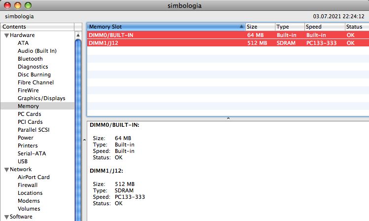

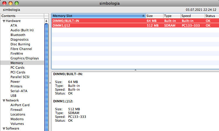

Trust me, I have no PC-66 RAM anywhere in my home, and this 512MB stick I’m using consistently tests the quickest with both Xbench and GeekBench (of all the 512MB PC-100/PC-133 SO-DIMMs I have handy). It’s a Samsumg unit with 16 discrete RAM modules (instead of the usual 8) on it, and I think it was sourced from OEM memory on my long-dead PB Ti G4/400.
EDIT: Though, now that I think of it, the on-board 64MB is probably 66MHz RAM. If so, then I‘d be perplexed how any past overclocking successes with other clamshell iBooks managed to ever happen at all.
id double check the actual speed of the onboard RAM chips you may find they are 100Mhz rated
these G3 CPUs dont generally tend to overclock very far, so im not surprised it fell over at 577Mhz
On the first, I think you’re right. I found this in web archive which reveals those DIMMs were indeed probably 2x1GB and marketed all sly, but it is noteworthy that they were also the only pair in my G5 which were rated at 400MHz and not 333MHz:
http://web.archive.org/web/20060107...e/details_en.asp?prodtechmate=SXP-2G/PC3200K2
As for the onboard 64MB on the iBook, do I know of a way to verify their rated clock speed? System Profiler, my go-to, simply shows the speed as “Built-in” — and given how the logic board is set to 66MHz, I doubt Apple would have gone out of their way to put in faster-rated (and at the time, undoubtedly more spendy) RAM for on-board.
Via firmware, is it possible to deactivate onboard RAM temporarily and to force the system to run only on the added SO-DIMM? If so, then I might try to move the bus clock speed back to 82.5MHz and test-boot without on-board memory.

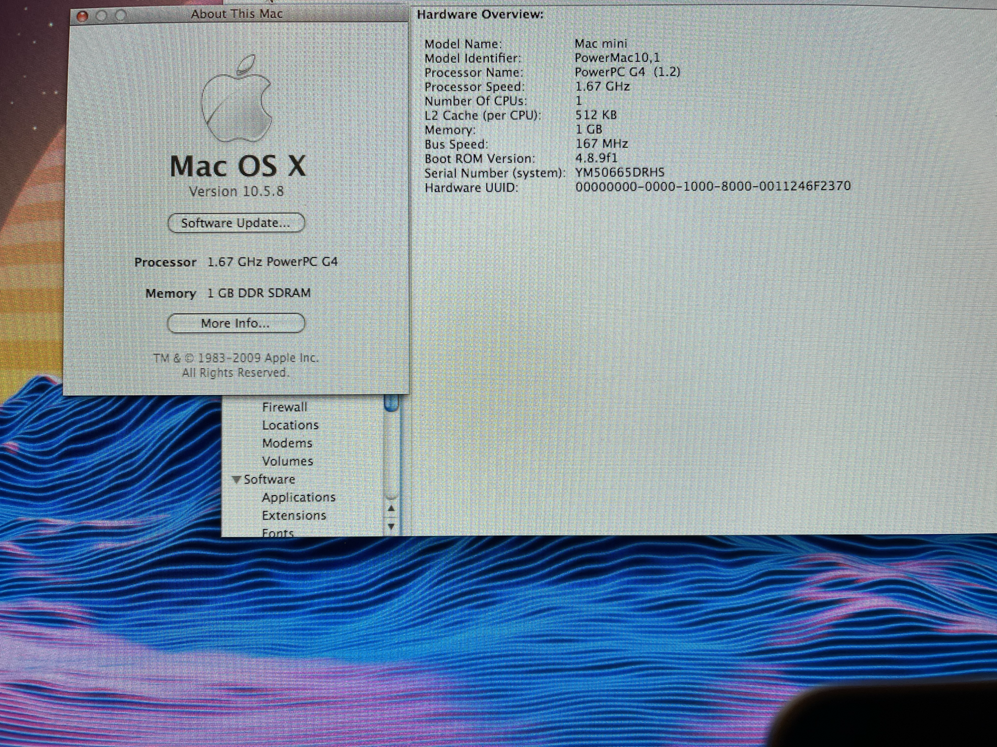

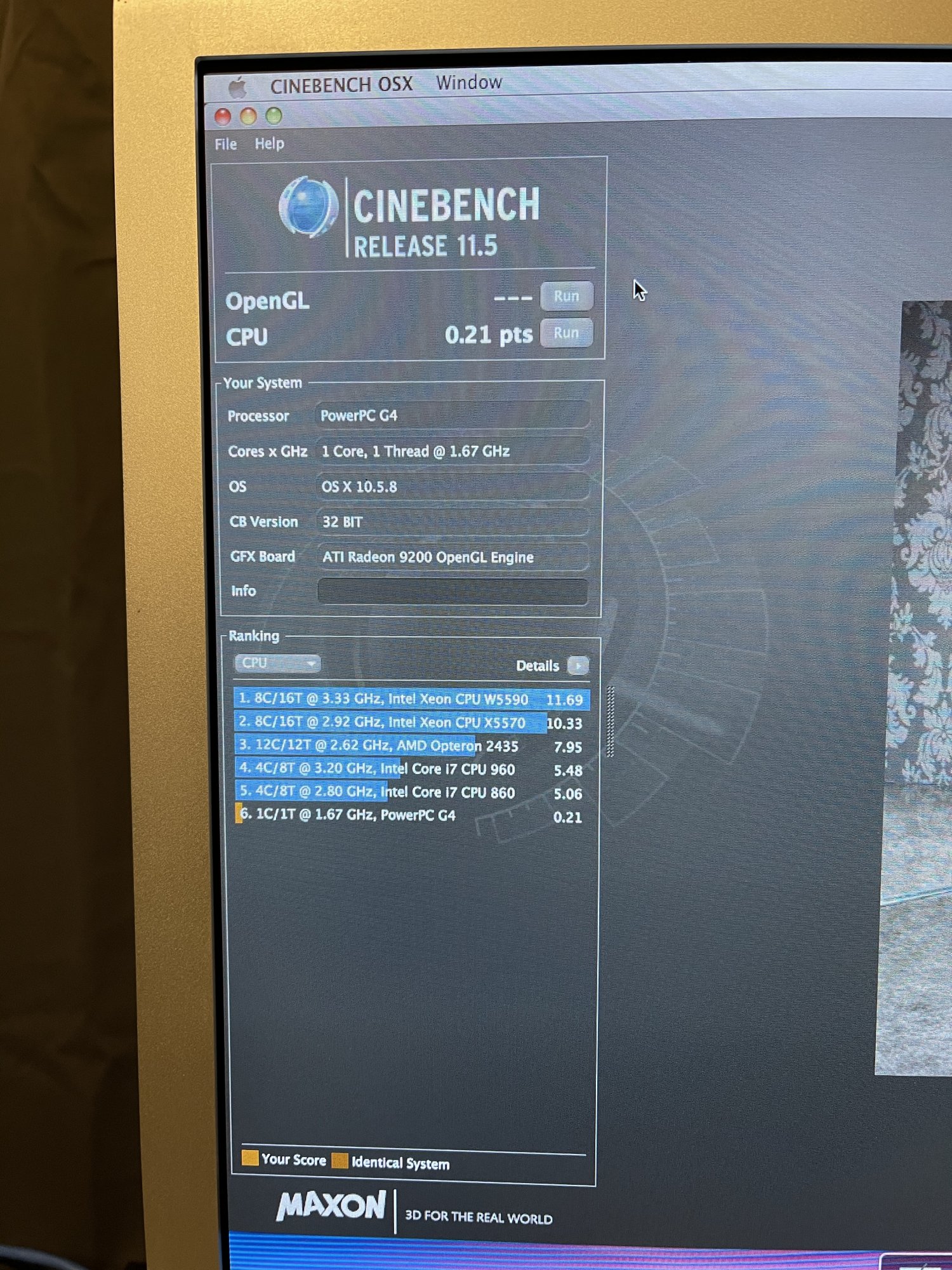

Decided to try some of this overclocking on my 1.42GHz G4 Mini and it runs great at 1.67GHz. I used a tiny blob of solder instead of a pencil though. Not because I wanted to, I just couldn't actually find a pencil in the house.
Edit: Well, it made it through a ~30 minute Cinebench run so I’m calling it stable.
