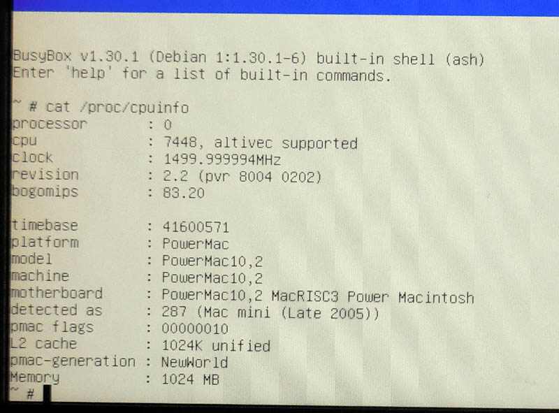

Thanks for looking at the ROM. Based on your reply I went ahead and put in a 7448. It sort of works. It will bong and boot to OF, it will boot the linux image, but it will not boot OSX. How do I edit the NVRAMRC now? I have a powerlogix firmware CD, but when I boot that it doesn't recognize the system and there is no opportunity to apply the NVRAMRC patch.
oh wow thats F*cking amazing to see it works
do you have a picture of the 7448 on the Mac Mini Lobo? :)
I sadly dont have it on this Machine but on my Mac Pro, I have the NVRAMRC patch I manually dumped from my Sawtooth, ill grab and post about that tomorrow unless @dosdude1 has it on hand (its how I got OS X to boot natively on @dosdude1's 7448 iMac)
it makes sense OS X does not boot as it does not have native 7448 support and the NVRAM patch basically makes OS X think its booting on a 7447A
if you use my custom 604 tiger kernel that will get OS X booting (but without any proper CPU support note About this Mac will just report PowerPC) but should be enough for you to get the NVRAMRC patch in place
so you can get OS X to recognise the CPU as a G4 and then put the stock kernel back (and Boot 10.5.8 etc)

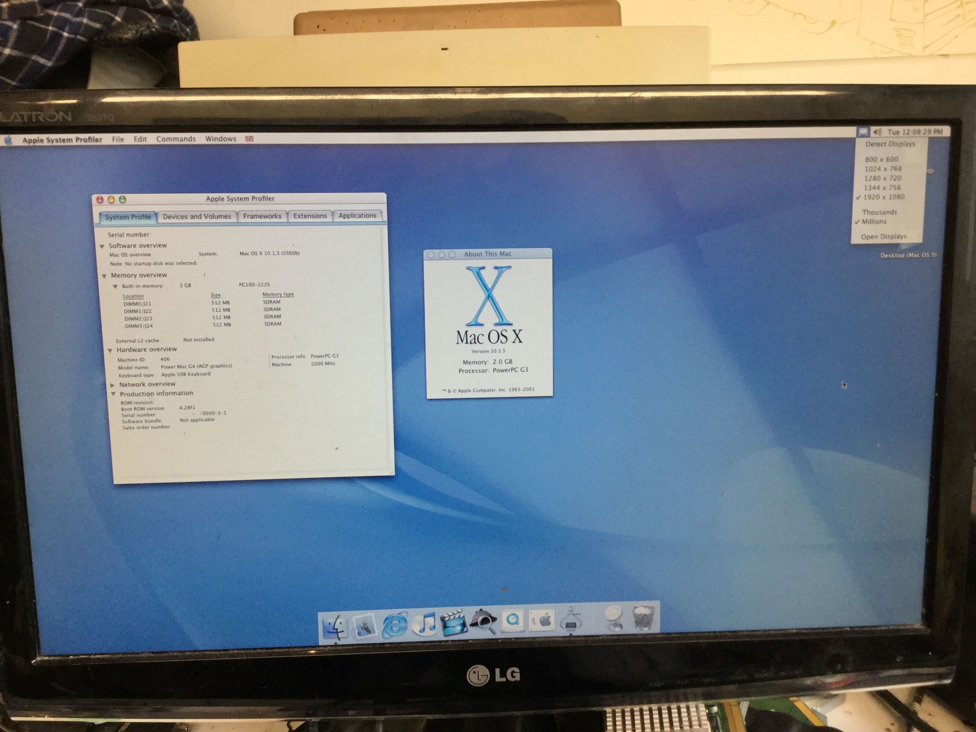

Thanks for all the help. I was able to boot 10.4.11 with mach_kernel replaced, and I ran the nvram commands. Following that it will no longer do anything but bong. No video and no light on the mouse. I did have to set the date at the beginning of the experiment so maybe the battery is low. I'll buy a new battery and hopefully that will fix the nvram.

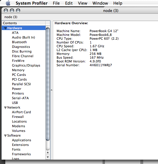

YES!! Thank you dosdude1!!! This was the whole reason I got into BGA soldering chips:
I applied the NVRAMRC patch and it still booted. I applied the ROM patch from dosdude1, and it still booted. I swapped the chip, and it still booted! I'm very pleased with this.
The 7448 sits significantly lower than the original CPU, so I'll have to shim or modify the heatsink. I have it pretty rigged right now just to see if it would boot. DFS is working and this powerbook uses a MAX1717 to control the Vcore. The voltage is different between high/low speed so I'll have to experiment with what voltage/speed settings will work in the powerbook. All of that should be relatively easy though...

oh that is very Awesome! :) Really happy to see the manual patching works, pretty epic stuff by @dosdude1 right there
and well done to you for stripping down a PB G4 12 inch and soldering successfully BGA soldering a CPU :)
and very glad to hear that the NVRAMRC patch works for the PowerBook at least
(I have a feeling it does not work on the Mac Mini because its BootROM fully recognises the 7448 so the patch might be trying to set values that are already set or change values that are only there when the CPU is not fully recognised and its causing the machine, the Mac mini to hang)

Nice, so it is specifically the 1.5 GHz PowerBook6,8 patched ROM we have up there, not any other 12" model's. Good to know which one it is, so no one wastes their time with an incorrect ROM.
I wonder if this can easily be resolved for the PowerMac10,2 models by flashing @dosdude1's ROM (which is based on PowerMac10,1) and then apply the NVRAM patch. Only thing to keep in mind is that that would change the model identifier to PowerMac10,1, too, for what it's worth, and whatever else that may change between the firmware versions.
But then, this also means the DLSD models face the same challenge as the PowerMac10,2, don't they? How should that best be dealt with? Different firmware patching? Flashing an earlier PowerBook's firmware into them? Changing the NVRAM-based patch?
Reactions: Amethyst1
yeah I do wonder if Mac Mini PowerMac10,1 and 10,2 firmwares are interchangeable, but I dont want to try on my machine because I dont want to have to try and wrangle a 40 pin parallel EEPROM to unbrick it if the worst happens LOL
yeah will be very interesting to see how the DLSD does, hopefully the NVRAM patch can be worked out and adjusted for machines that already recognise the 7448 :) (the DLSD is a unique machine so no opportunity for cross flashing boot roms sadly)
