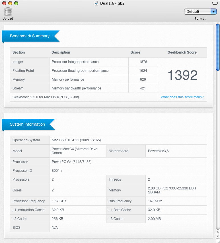

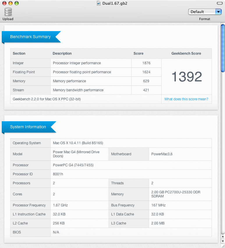

You should run that setup with Geekbench 2.2.7 to see how it sizes up.
I don't have results on Leopard because I always ran dual boot OS 9.2.2 & Tiger on it, but here is the 2.2.0 score on Tiger:

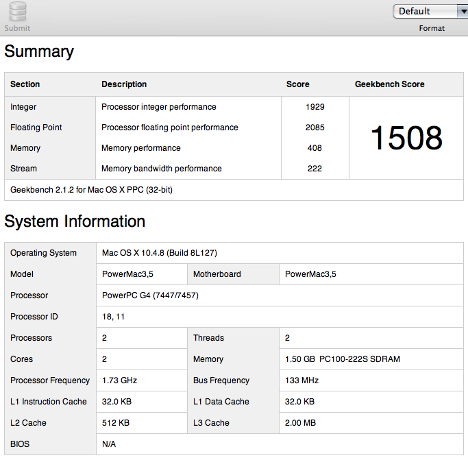

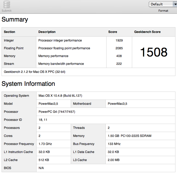

Hrm, not quite the punch I was expecting.
Mind you, I’m referencing this against the GB2 benches on my 1.67GHz single CPU 7447 in my two late 2005 PowerBooks (984 on SL-PPC on the 15-inch, and 996 on the 17-inch running Leopard).

The 256 KB of L2 is probably the main limiting factor of the setup. I have tried out dual 7457s to make up for this since they have 512 KB of L2, but I have never witnessed a 7457 that will actually run stable above ~1.58 GHz, so I usually don't bother with them. Too bad Motorola didn't make a "prototype" 1400 MHz rated 7457 as that would have been incredible!!
Regardless of Geekbench scores though, "feel" matters alot too with these machines. With a 64-bit SeriTek card and an SSD, this is probably one of the snappiest PPC G4 Macs I've seen yet.

one of the things to keep in mind is GB tests both the CPU and Memory bandwidth of the system and uses both results to calculate the final score
and memory bandwidth of G4's aint fantastic due to MAX bus which was showing its age somewhat, and esp with 2 fast CPU's like this can get somewhat congested
note that if you look at the actual processor sub scores, they are much higher then the memory sub scores
and these lower memory scores can skew a Geekbench result somewhat
so where your doing work which entirely resides in L2/L3 cache and does not require too much communication between the CPU and or back to main system memory, this system will be very performant still I imagine 🙂

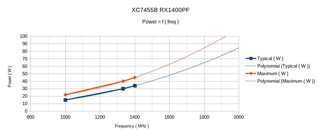

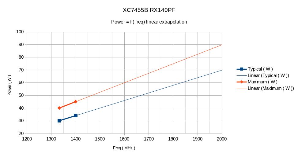

Before CPU swap I look into power consumption of overclocked CPUs to check cooling conditions.
All datas are from NXP/Freescale technical data sheets and exactly match CPU partnumber.
1. XC7455B RX1400PF = real CPU used in Powermac G4 2x 1.42 GHz:
Unfortunately XC7455B datasheet has only two Power consumption values - for 1333 and 1400 MHz. The third one ( 1000 MHz ) is from CPU type MC7455A RX1000LG and used for calculation of polynomial trendline.
Graph form two original data points is only linear aproximation and looks:
2. XC7455B RX1400PF - linear
If we replace CPUs for more modern ones ( but with lower nominal frequency ) it looks like:
3. MC7457 RX1267LC - new CPU candidate:
Of course, these results are theoretical calculation, but not far from reality.
So if I have frequency somewhere around 1600 MHz
7455B: 63 W max
7457: 33 W max
And if @socom_22 said that he used stock copper cooling for 1667 MHz. i.e. 2x 70W, it is safe to use even the aluminium cooler for 7457 CPUs.
Fortunatelly I have 1.42 version with copper cooler, so at first I try overclock 7455B, and then I use second CPU daughterboard to 2x7457 CPUs.

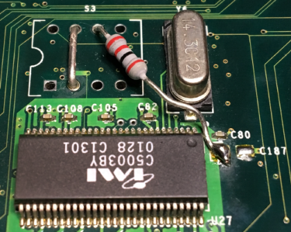

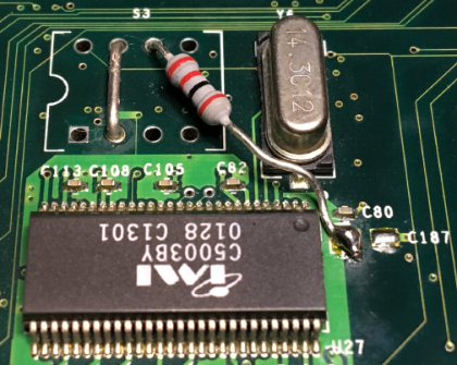

I soldered a DIP switch into the S3 position on my Gigabit logic board today to try overclocking the bus. I started with a 7400 set to a 4x multiplier. Bumping up to 120MHz does actually boot. Mac OS does report the CPU speed at only 400MHz and the bus at 100MHz regardless. The benchmark results really surprised me though; I saw about a 20% improvement over stock in CPU and floating point scores in MacBench 5. I also tried 133MHz and the machine actually chimed, but only resulted in a black screen and no further sounds. I'm going to try again with a 7410 when I get another working one in a few days, but I doubt I'll be able to get 133MHz working. The clock multiplexer for the memory (PI6C180) is only rated for 100MHz and probably can't time the RAM properly at 133MHz even if the CPU can support it. There are the pin compatible PI6C180A and PI6C180B that support faster clocks, but they haven't been manufactured in years and are probably impossible to track down. If anyone ever gets a hold of one though, I'm inclined to believe that one of these early G4 Power Macs could actually run a 133MHz bus with a better PI6C180 installed.
I also dug up a schematic of an iMac G4 that uses the same C5003 clock chip as the Quicksilver. It does actually look like it supports up to 150MHz. Pins 18, 19, and 20 are the controls (likely wired to the S3 holes, but I don't have a quicksilver to confirm). Pin 18 pulled low is the default for 133MHz, but removing a resistor from it and pulling pin 19 low instead should set the bus speed to 150MHz. None of the stock CPUs and most memory available aren't rated for that speed, but it isn't much of a jump and will probbaly work.
