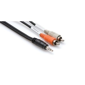

I'm a beginning guitarist and just getting a chance to play around with Garageband a little bit. A question though...
I've been able to plug the iPad into my Audio Engine powered speakers using the mini RCA plug and the Garageband app sounds great. But I do have a guitar amp...a small Roland...can I hook up my iPad to the amp? How?

You're going to want to get a 1/4" to 1/8" adapter (they're around $2 at Radio Shack and a ton of other places). Plug your guitar cable into the adapter, then put the adapter into the iPad's headphone jack.
Run that guitar cable to your amp's Line In, if it has it. Line In jacks usually bypass the amplifier's pre-amp, removing a lot of tone coloring. Since you're using the amp models in GarageBand, you want the raw signal going from the iPad to the power amp section of your amp - so that essentially it just makes it loud. ;)
If your amp doesn't have a line in, or CD In, just stick it in the input and set the EQ flat and you'll still have decent results.
^^ Actually, if you've got a Roland cube, you need an 1/8inch to 1/8 inch (6.25mm) stereo lead. Just plug into the Aux in on the back.
That/s more reliable than trying to go from a 1/8inch stereo to a 1/4inch mono.

Thanks for the info. I thought I had an adapter somewhere...after a long search...I came up with a 1/8" to 1/4". So I need to make a trip to Radio Shack. Couldn't find a Line In on my Roland AC-90 but I better check my manual. I haven't had much time to fiddle around with my setup...but I want to get back into it.

Actually, your amp is a full range one - since it's an acoustic amp not an electric guitar amp. The lead you need to plug your iPad in is an 1/8inch to 2xRCA. You can get these at any electrical store or Apple store. Like this:
Right on...got one of those! Got it working...sounds sweet. I'm starting to sound like Jimi Hendrix.
