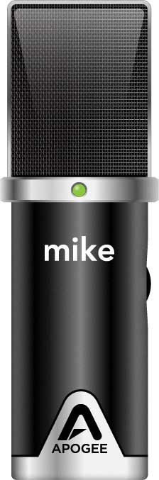

Anyone looking for a quality Microphone option for iOS might want to hold off for this little guy. Apogee makes some great products and I'm hoping Mike will follow suit. No mention of price yet, but I'm speculating around $100.

I'm really enjoying Garage Band (works great with iPad 1) but I was stupid enough to buy the little MIkey to sing into but it says it's not compatible and doesn't work. You'd think the Apple Store guy would have been able to tell me that (I asked him).
