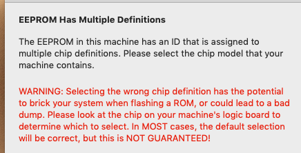

OK, I’ve made it as far as trying to save the ROM but I got the following message when I open ROMTool and try and dump the ROM:
“The EEPROM in this machine has an ID that is assigned to multiple chip definitions. Please select the chip model that your machine contains.”
The pull down menu has these options:
MX25L3205(A)
MX25L3205D/MX25L3208D
MX25L3206E <—— That one is checked
Do I need to open the system up and look or can I find out with with system information?
Dumping the rom works without knowing the chip.

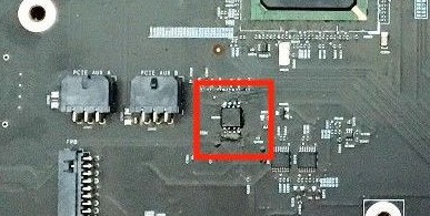

The chip is position u8700, 8 pins near the two pcie power connectors for the gpu.
Knowing the type is important for writing a firmware file back in the chip.
Not every board has a flash chip what needs to be checked, btw.
MX25L3205(A)
you will find it here (U8700):
mostly:

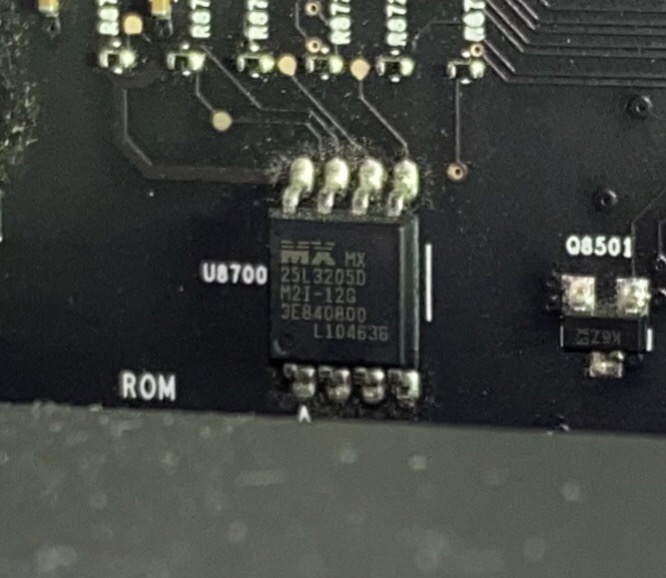

4,1 (2009) MX25L3205(A)
5,1 (2010) MX25L3205D/MX25L3208D
5,1 (2012) MX25L3206E

Thank you so much for all your help... so what do I do next? I took a pic of the chip. Looks like it’s: MX25L3205D
since I have a 2010 that matches up huh?
