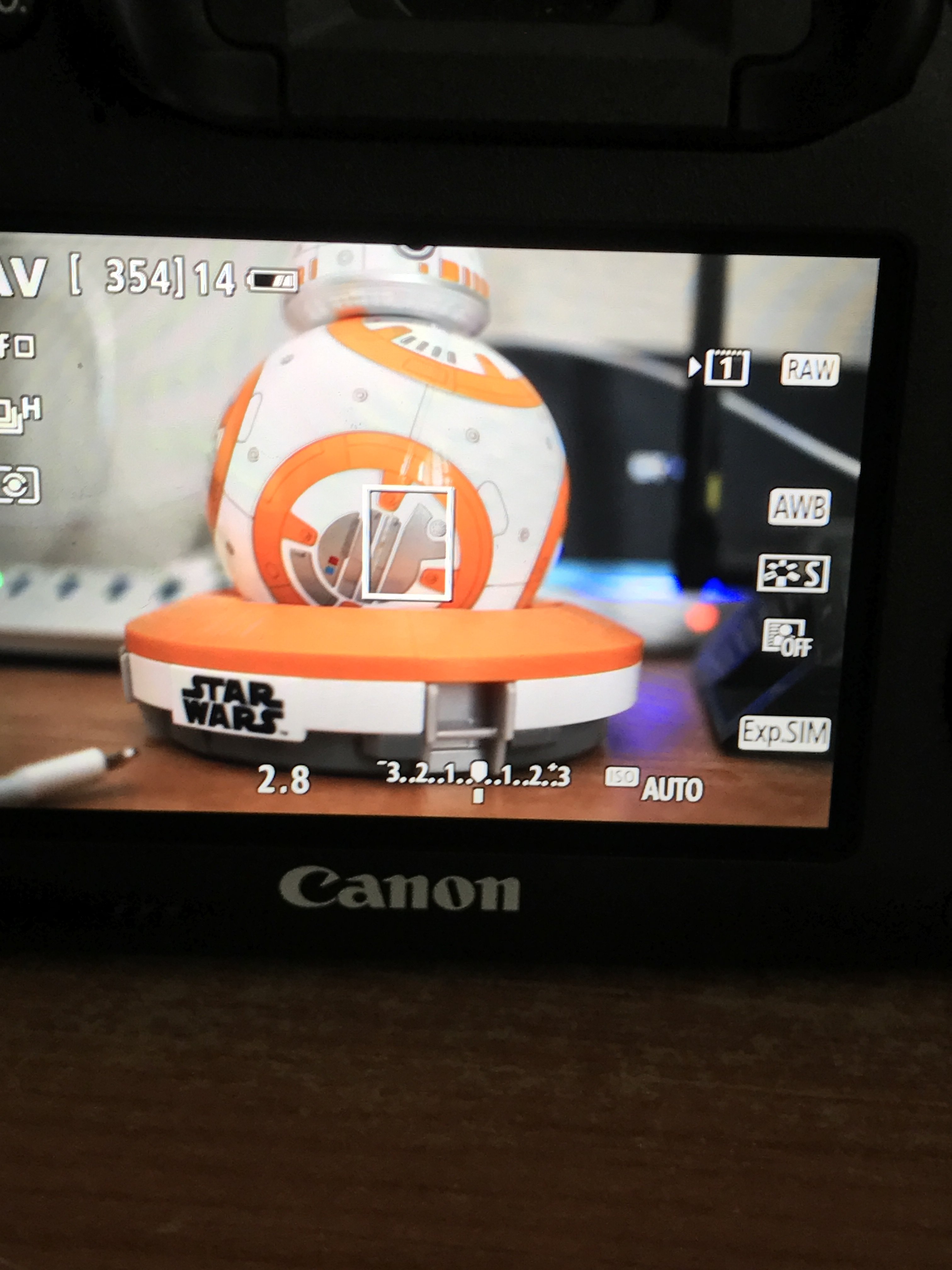

I don't understand why I keep reading/hearing that DSLRs can't show depth of field live. Of course they can - it's not an effect that requires processing using a DSLR, it's just the natural characteristics of the lens optics and aperture. If this were true, you'd never be able to manually focus an image using live view mode on a DSLR.
Yes it's quite ridiculous how badly researched these claims are. With mirrorless cameras especially, you have no trouble fully previewing the actual final result. However, it is worth noting that a DSLR makes it impossible to see the actual depth of field for larger aperture lenses due to the fresnel effect of the pentaprism apparatus. Basically what happens is the maximum aperture size is limited, specifically it's about f/2.8 for a 35mm full frame camera and f/4 for APS-C cameras.
So if you had it in your mind that you were shooting with an actual DSLR (not mirrorless, not rangefinders) with a lens at f/1.4 (or equivalent if using a non-135 format camera) then it's actually true that it's not possible to preview the final result through the viewfinder.
Of course, I haven't seen a DSLR that couldn't also shoot in live view mode if you wanted to do that. And the in-between design of the Sony SLT cameras has no such limit on maximum aperture that can be previewed at any time.
Basically, even with the caveat mentioned, this is an incredibly ignorant claim (and not one that Apple is making, afaik.)

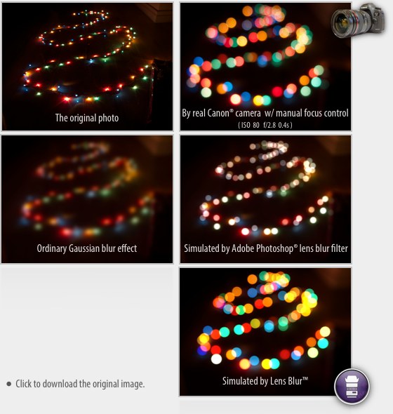

I'm a DSLR shooter, and I'm impressed by the results. I hope they tweak it to allow different bokeh effects in software rather than the plain gaussian blur. (it can be done rather easily)
Here is an example of what software bokeh effects can look like: http://www.lens-blur.com/

If he said it, he is dead wrong. Literally every DSLR does this.

Let me explain something that *you* don't seem to understand. A DSLR - when viewing through the viewfinder - always uses the widest possible aperture of the attached lens. For example f/1.8. (The aperture that gives you the maximum blur/bokeh) So what you see is what you are going to get.
It is only if you want to preview a smaller aperture (for example f/11, which would have much less bokeh and more of the scene in focus) that you would use the depth of field preview button.
The DOP preview button works the opposite way you think it does.
The effect doesn't look real to me. It looks like (good) photoshopping.
The issue is lack of transition between the in focus object and everything else. Bokeh from a DSLR (or your eyes) will have areas that are almost in focus transitioning to completely out of focus. Apple's does not.
Well of course, because it isn't real bokeh.
This is just a nice blur filter applied to the picture. I love bokeh, I have a 50mm lens on my DSLR for portraits and they look amazing while pictures taken with 7+ are cool, but look artificial. There is no other way they can achieve the same effect with the lens on the iPhone so I think they made a great job, but of course the quality you can get from a DSLR is far superior. Even Schiller said that during the keynote
