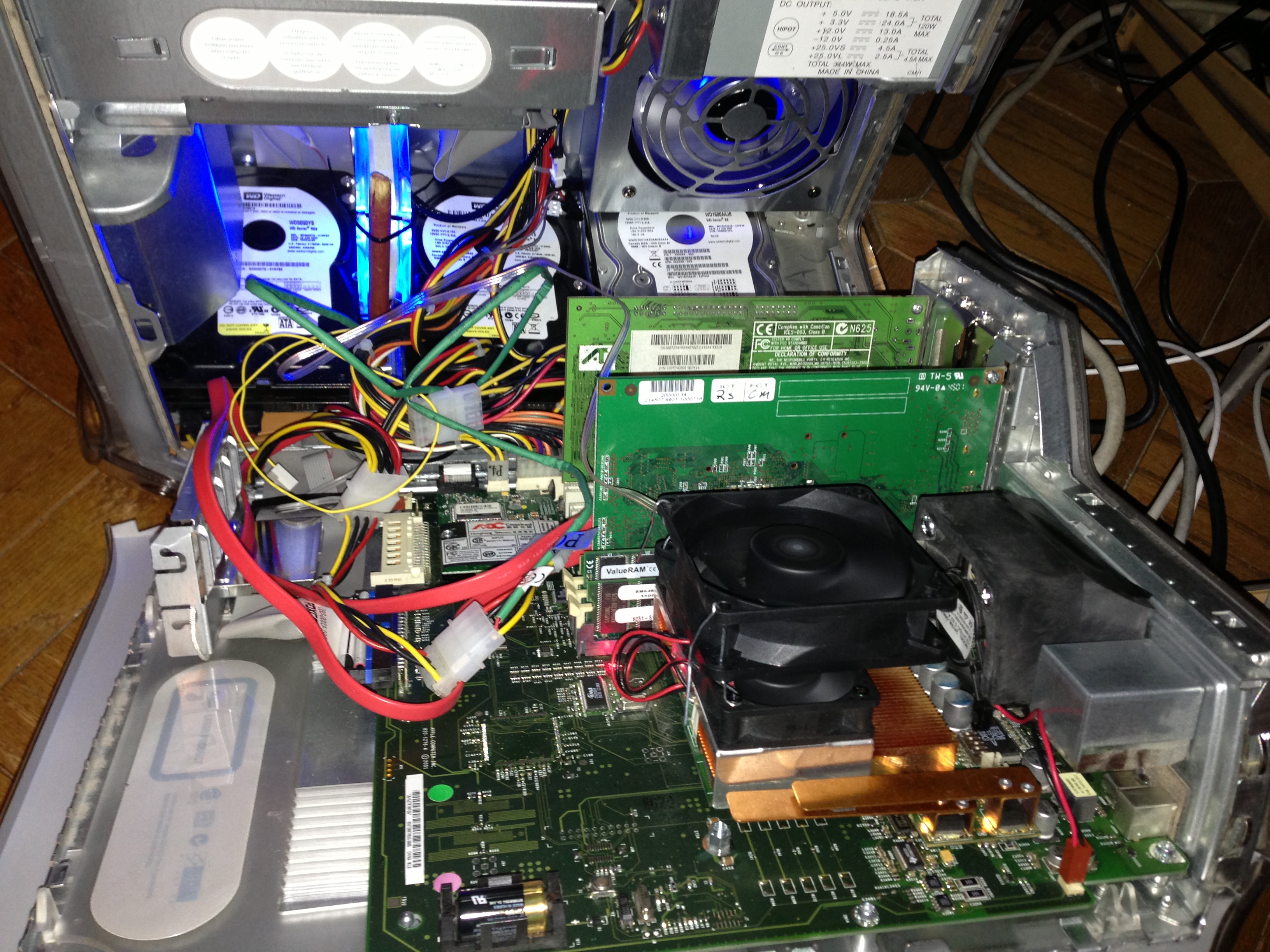

Since someone mentioned they wanted more pictures of the inside of my Mac…
Also, the fans I got today.

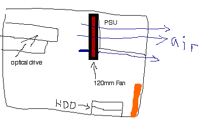

What about searching for a quieter thicker fan, to put in the place of the original case fan that blew backwards out of the case and was connected directly to the CPU-heatsink?
The problem with the heat blowing in the direction of the optical drive - can't you just turn it around, so that it blows onto the Logicboard and slightly out of the holes in the case?
Also, what I did once in my Sawtooth (I may have suggested that on the earlier pages?) is putting a 120mm fan (red) before the PSU. See the picture.
Excuse the kiddy draw 🙂
The orange one is possible in the Sawtooth. 70mm with the lowest PCI-slot free, 80-95mm two slot free, 100mm with three slots free. More than 100mm is not possible. (Though that would not do much, since the most heat is between the CPU und the PSU.)

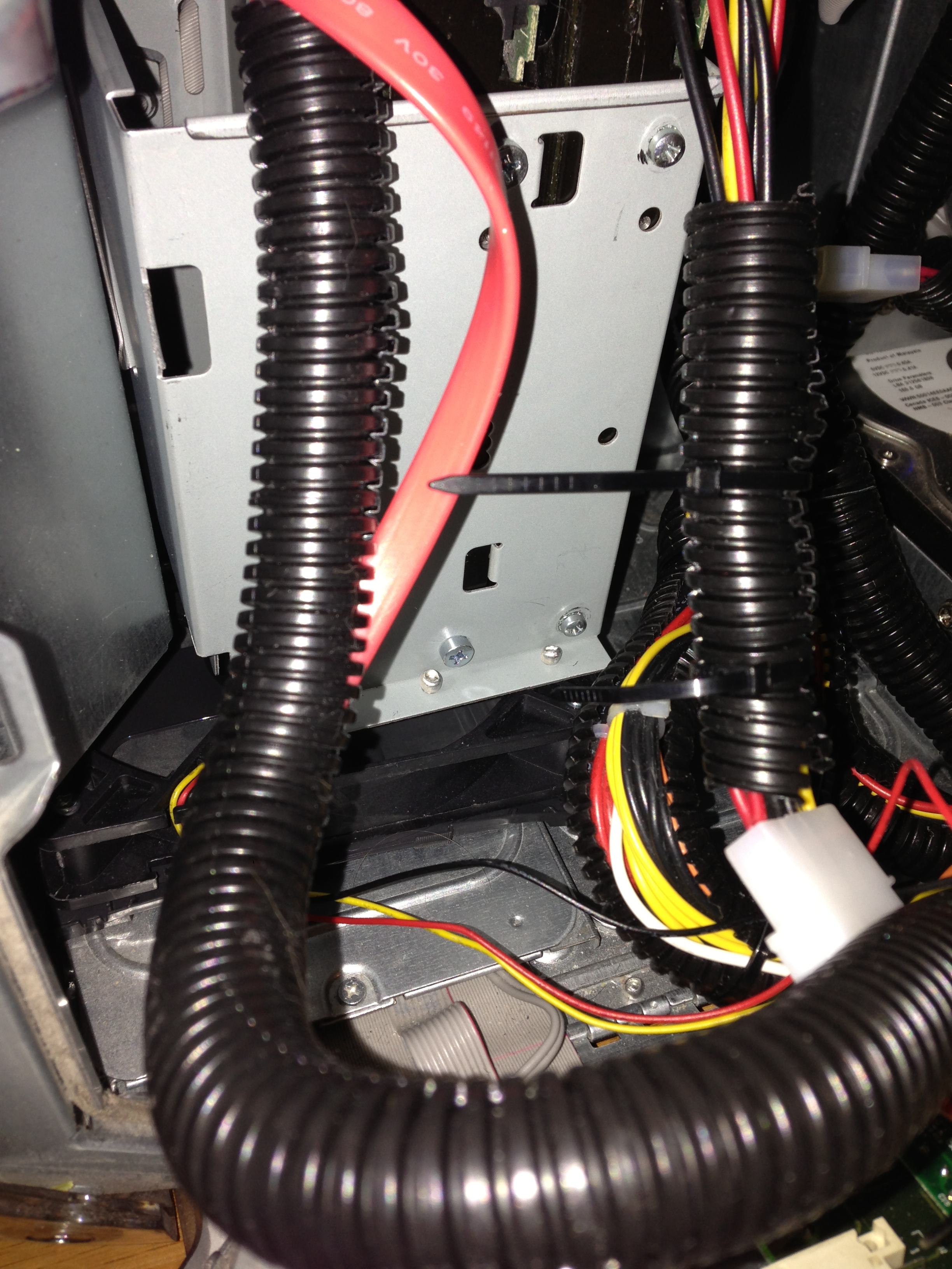

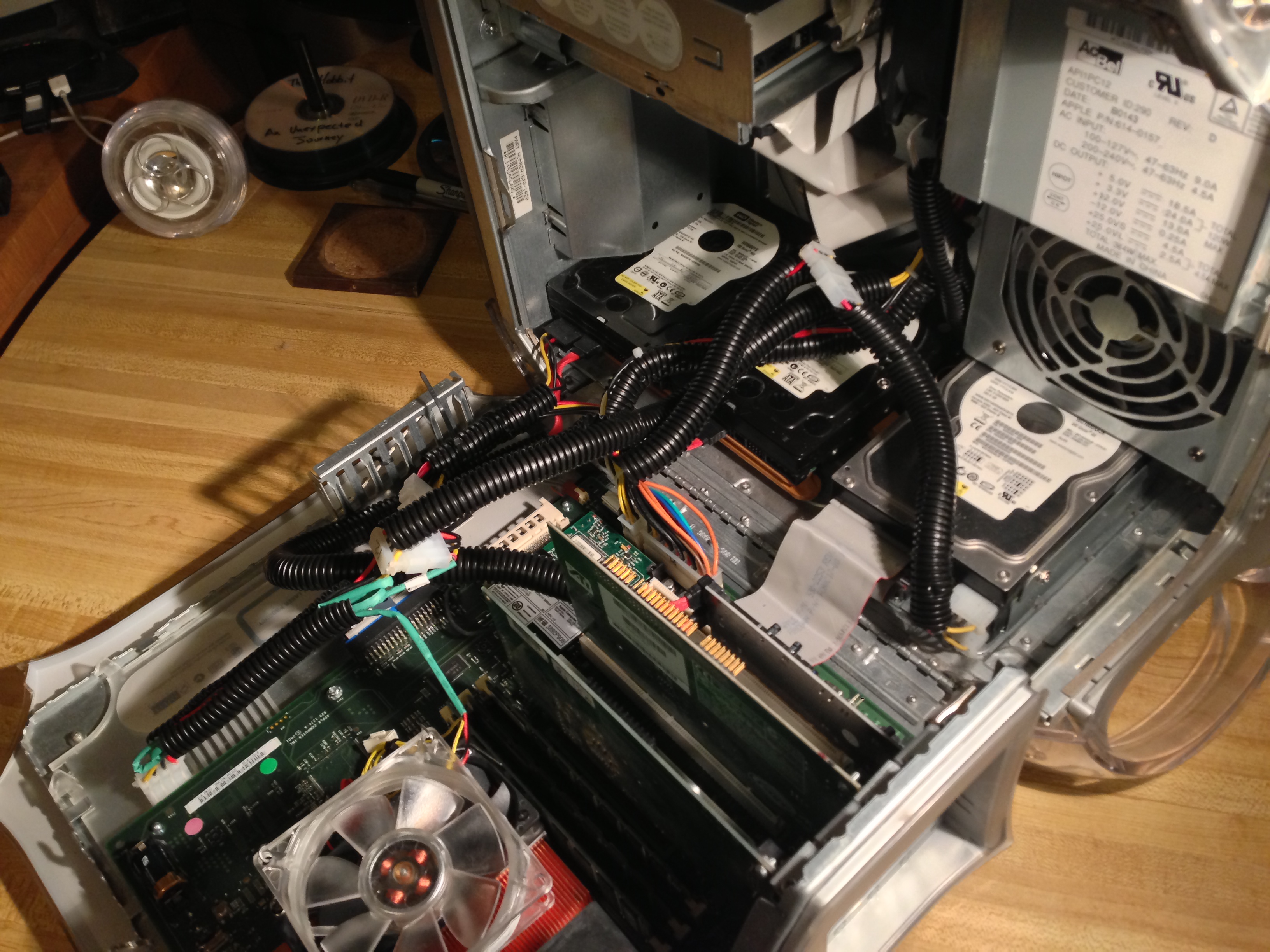

Cleaned up!
OK!

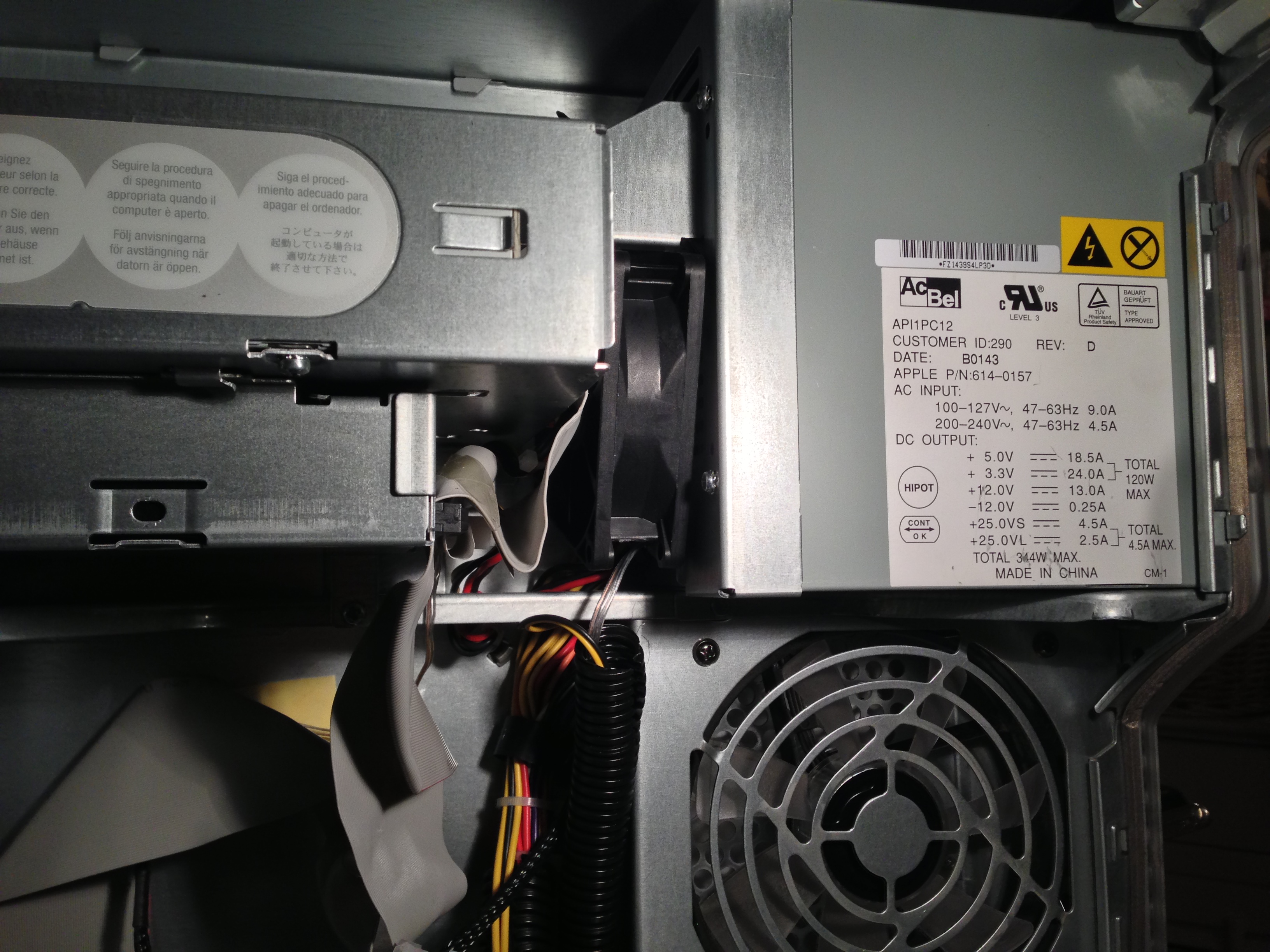

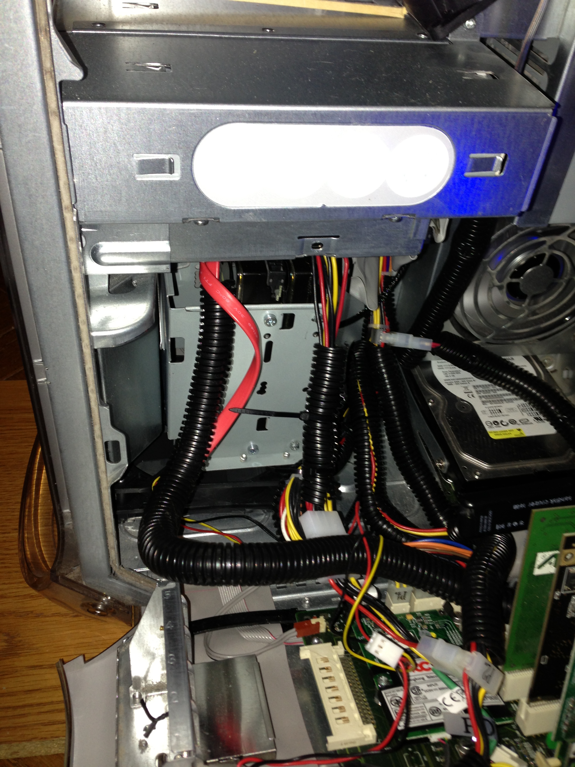

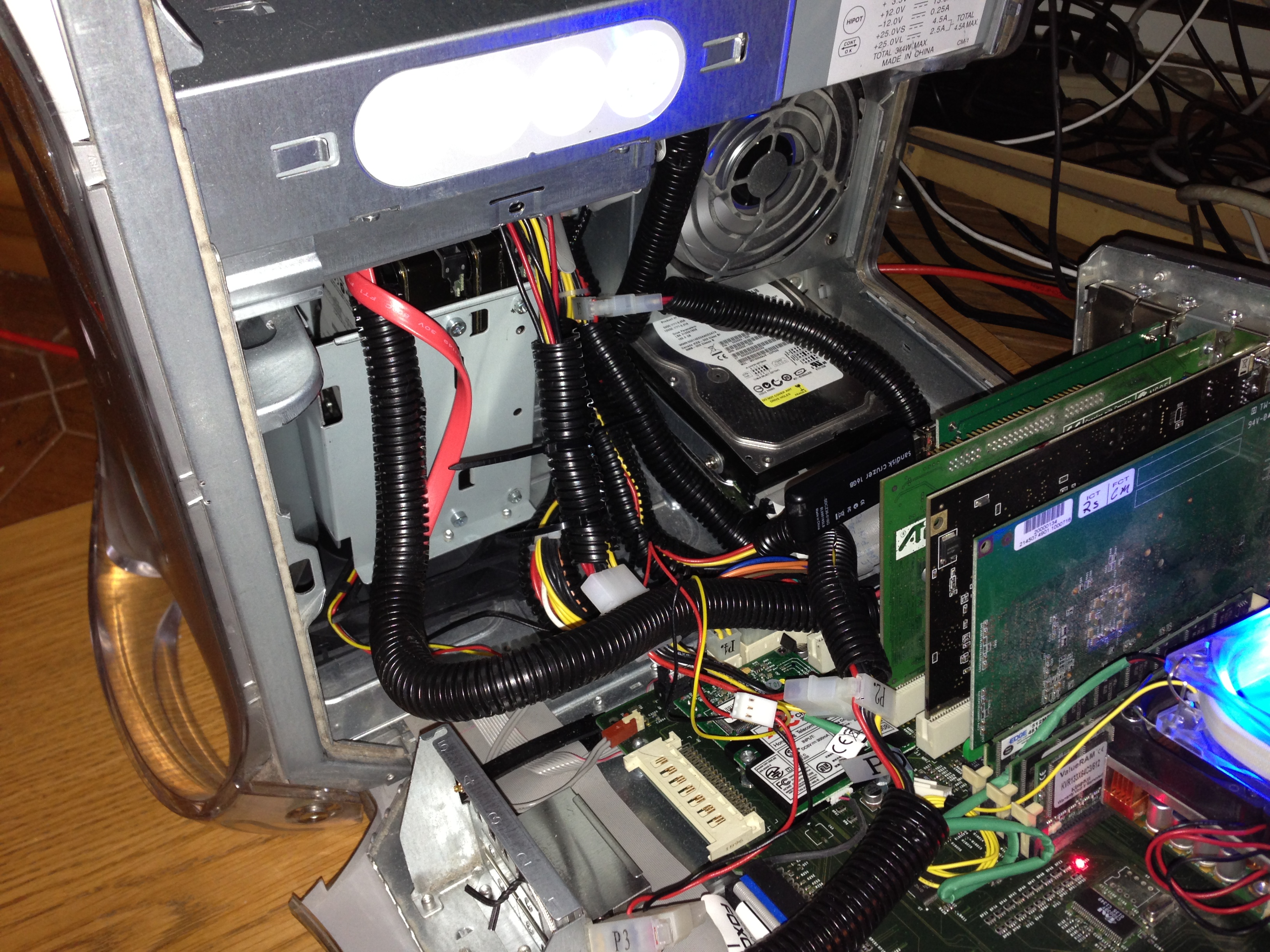

Went and bought another one of the b-blaster80 fans. 80mm, 3500rpm, 62cfm. This is the same one I swapped out inside the PSU.
Took a tip from Cox Orange and placed the fan behind the PSU.
I also took the time to run in tubing to clean up the rats nest of cables. Lastly, I finally swapped out cabling from my cable modem to my router and to the Quicksilver with CAT 6 ethernet cable (yeah, it makes a difference!).
Pics below!

Allright, had to relocate the fan behind the PSU. Guess that ultimately it must have been blocking airflow into the PSU. Got it wedged into the frame so that air is directed down from the top of the case. See how that goes.
Hm, I had the luck, that this "angle" at the top of the PSU is not present, so that I could fit in a 120mm fan. Sorry, it didn't work for you.

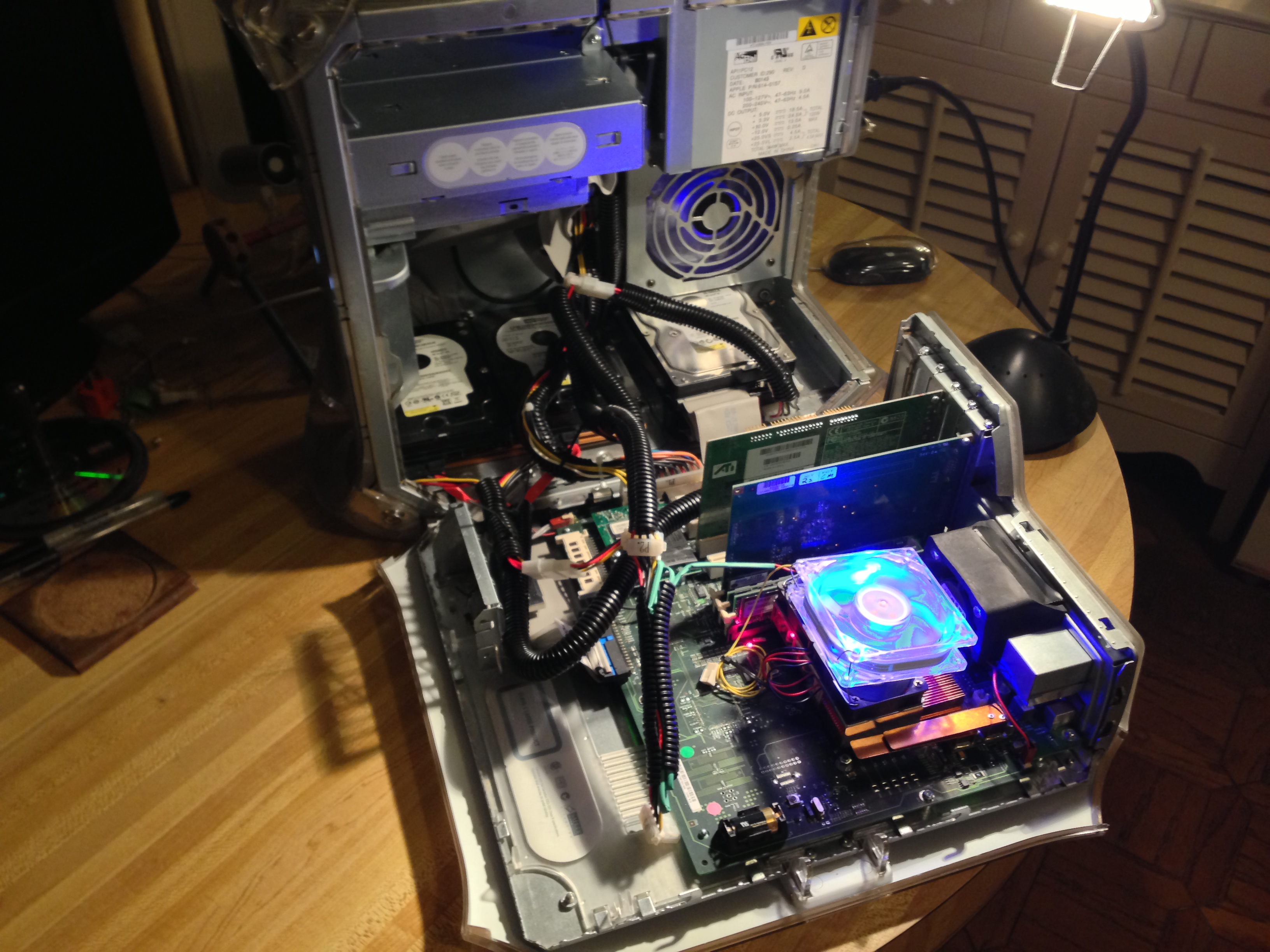

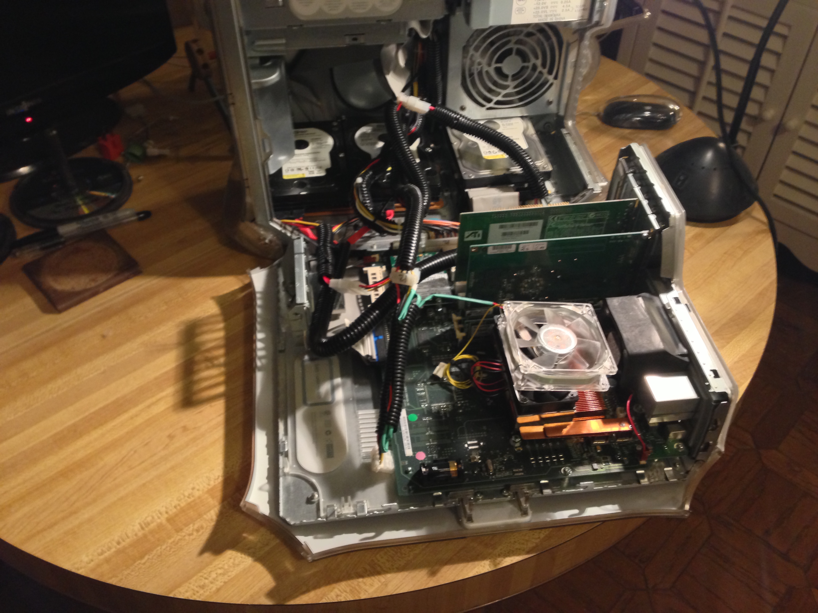

OK, did some more minor work tonight. Borrowed a drive cage from an old PC, put one of my 120mm fans on the bottom of the case and the drive cage vertically on top of the fan. Seems to be working fairly well.
I would have liked to place it horizontally, but there was no way to get the door closed doing that.

Allright. Well, like usual, the latest experiements failed. So, now I am back to just having the drives loose on the bottom of the case again. However, this time they are flat on the metal. Before I had put some risers under them to supposedly allow for air flow underneath the drives.
I am guessing however, that the metal in the bottom of the case acts as some sort of heat sink because without risers and the drives flat on the metal they are keeping relatively cool. I do have a fan on top of one drive blowing towards the back of the case.
So the drives are now hovering in the 106º-115º range which is much more acceptable than anything I had previously.
So, now, ultimately I think until I have the cash and time for a case mod this is pretty much how it's going to be. I do note that in my research travels it appears that as great as I think the Quicksilver is, there is a mention that Apple had heat issues with this case. Considering my issues I do not find this surprising at all and I think that's probably the truth.
A basic QS came with one hard drive, possible two if you had a BTO. Just two drives, a ZIP drive, an optical drive and the standard CPU card (for whatever model you bought) with that giant heat sink and the standard fans and the case is fine. But start expanding as I have and the internal temp balance goes up. Two more hard drives and the case is all of a sudden an oven.
Add in extra cards (particularly better and hotter video cards) and a third IDE drive as I have done and you've got heat issues.
