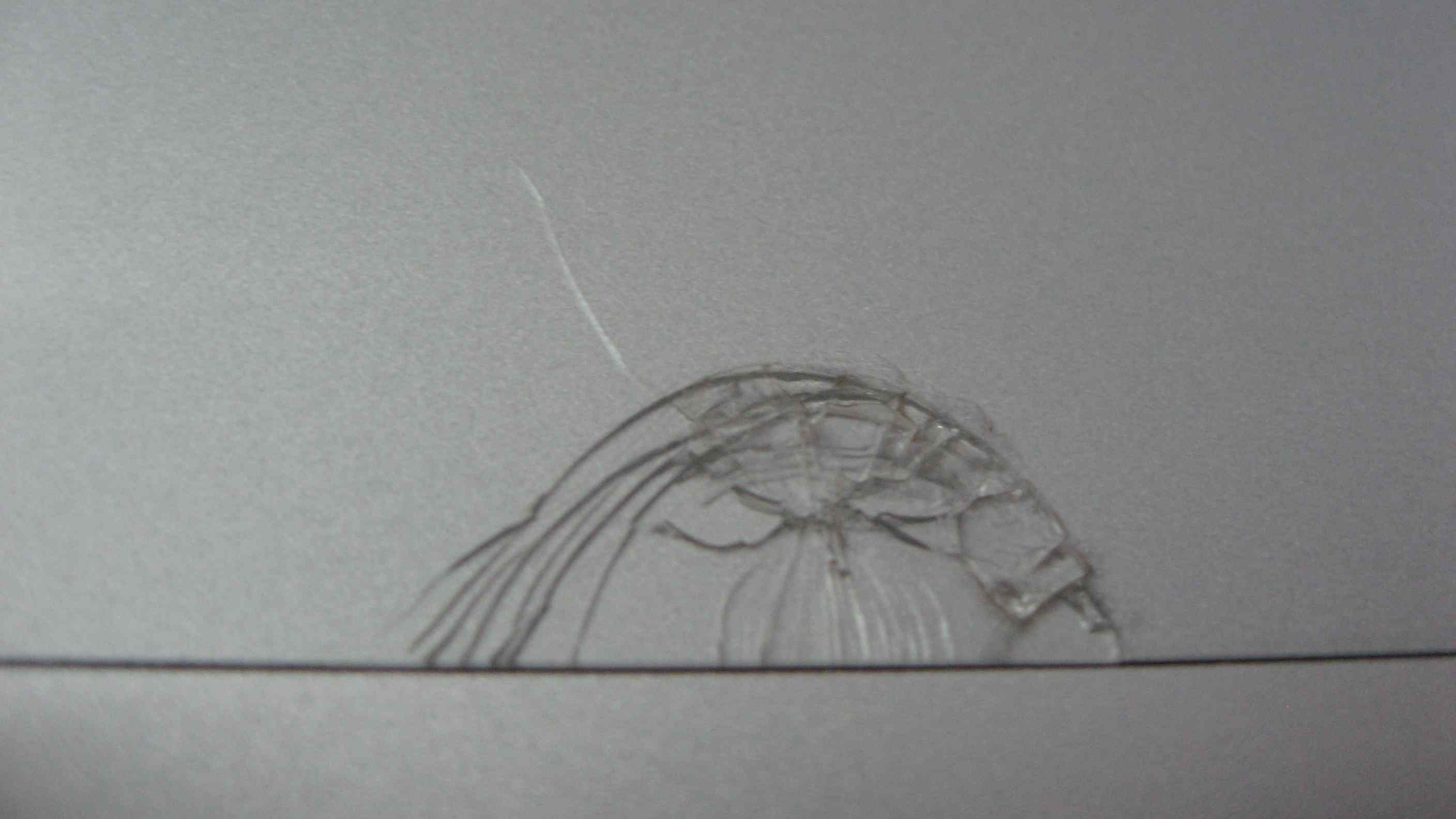

A touch of my human finger, Pal. Nothing more. In the picture you can actually see the finger tip shaped crescent where the crack started.

The glass track pad cracked on my 6-month old uni-body Macbook during normal use--specifically while clicking the lower part of the glass with one finger tip.
Based on what I've experienced and seen so far this is a systematic problem. It looks like there is a weak point in the bottom center of the glass where most of these cracks are happening. Supporting this, the only irregular aspect of my track pad usage was that I clicked almost exclusively at that point in the bottom center. The crack started as a finger tip-shaped downward pointing crescent, and has now spidered all the way to the top of the pad.

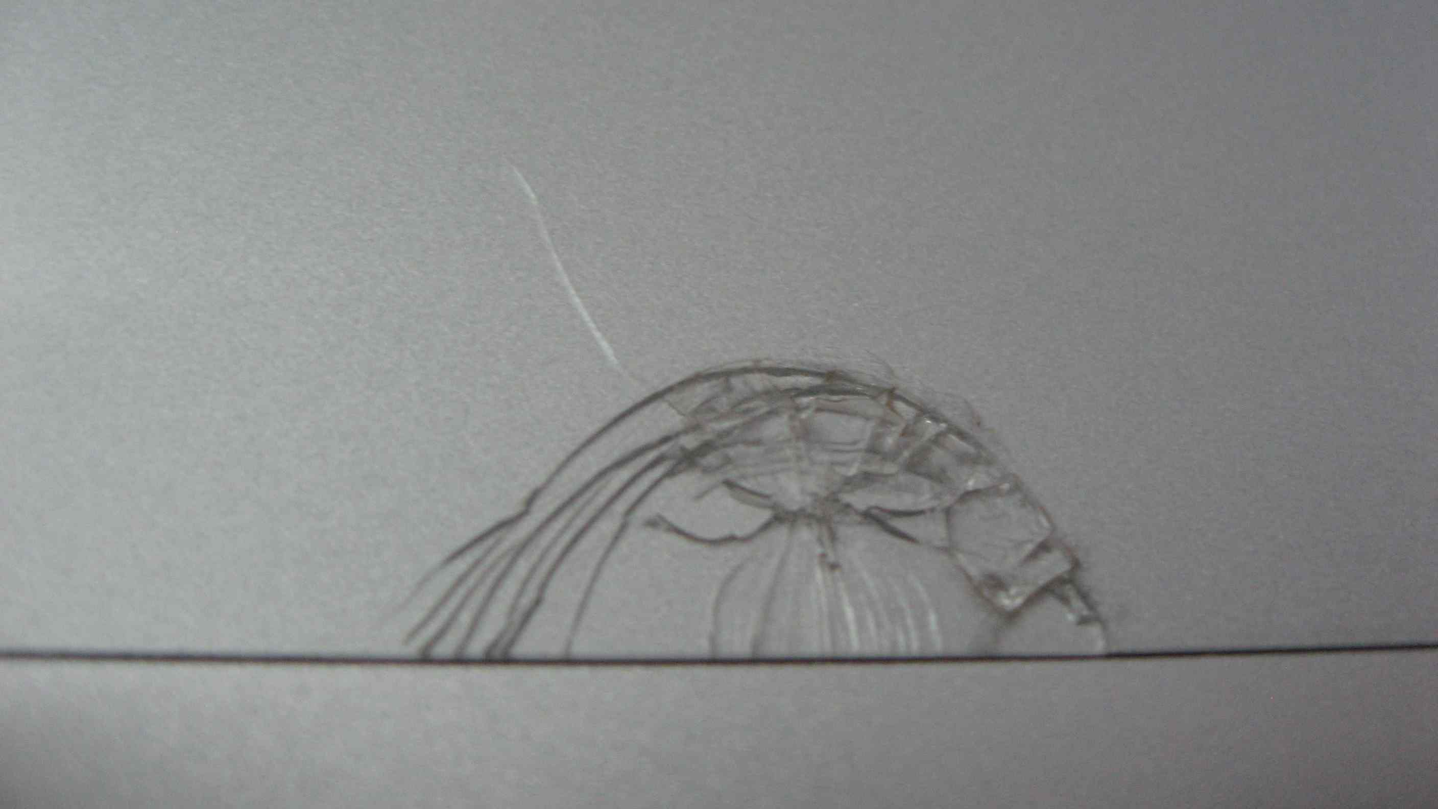

I'm just posting to say that the exact same thing happened to my track pad yesterday. I was doing nothing but pressing down - I have a tendency to use the bottom centre - and a crack formed. It is basically identical to yours except that the long thin crack heading to the top is on the left hand side rather than the right. But aside from that it is basically the same crack. And like yours, the crack fits with the shape of my finger.

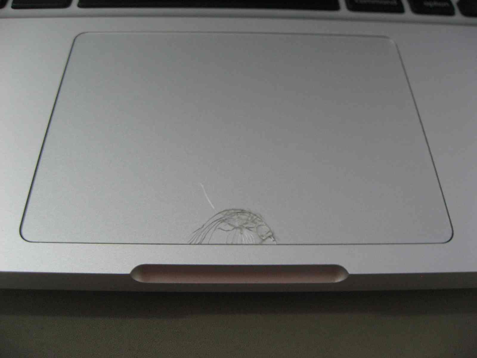

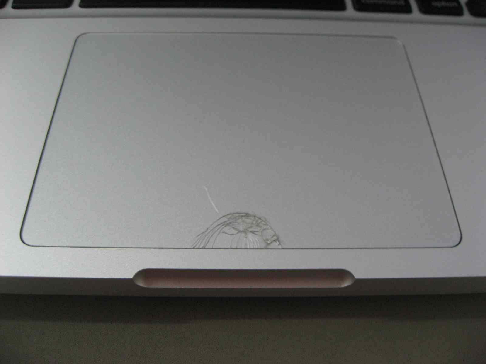

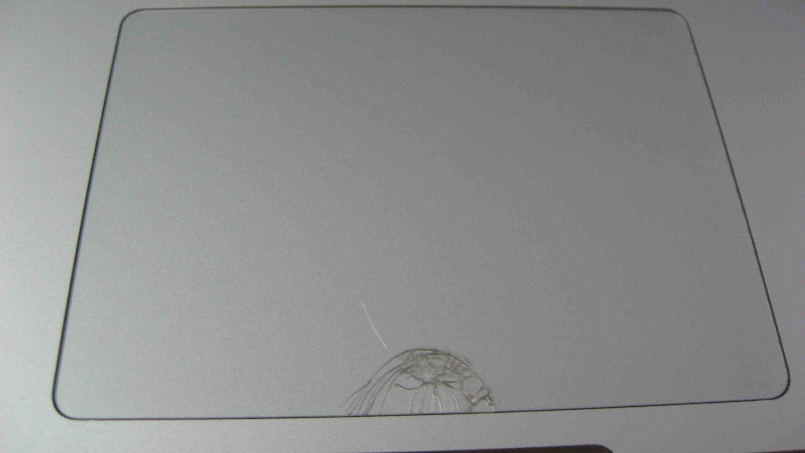

I've been looking around the web to find someone with this problem, so it's nice to see something so recent. I've been having a problem with my trackpad for the last few weeks; it just seems to not react to normal pressing and occasionally lags in response, so I end up with about 5-6 actions after a minute or two delay. More often I've been clicking in the bottom middle portion of the trackpad (right where that screw is), as it's the only place that is consistently responsive.
Late last week I was just tapping away (not agressively or anything) when I looked down and noticed a pretty nasty crack the size of the tip of my finger, with a single looping out. It wasn't there when I started using it earlier that morning, I hadn't moved the laptop, and there was nothing close to drop on it. The cracked area is still responsive, but I really don't want to keep pressing it on the chance it gets worse.
I'm in Thailand, and my closest Service Center is about 150 km away, but the people there are generally pretty understanding, and I've only had this notebook (a black and white unibody) for about 8 months (basic warranty, no AppleCare), so I'll see what I can find out later this week.
The picks should show the crack pretty well. There isn't even another mark on the casing.
