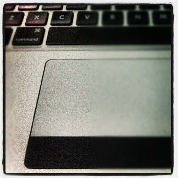

Cracked TrackPad "Cheap Fix"
Hi guys, as you my trackpad gave up just two weeks after I got the laptop, did not had the money to buy a new one, and I'm from Dominican Republic and here we don't have apple care, so I came out with a cheap solution: 3M Vinyl Plastic Electrical Tape. My crack is in at the middle zone of the bottom of the trackpad, so I just put some of the electrical tape from side to side and cut the excess of tape with a Gillette Blade. The result is the picture:
PS: The cool thing about this, the sensitivity of the trackpad is the same as if there was no vinyl at all. 🙂
So, you can find a really wide vinyl tape and use it, or just a thin one like i did to "fix" it.
Hope that this help. 🙂

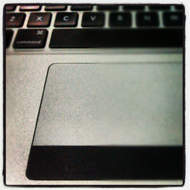

Looks pretty nice. Just looks like a separate trackpad button.

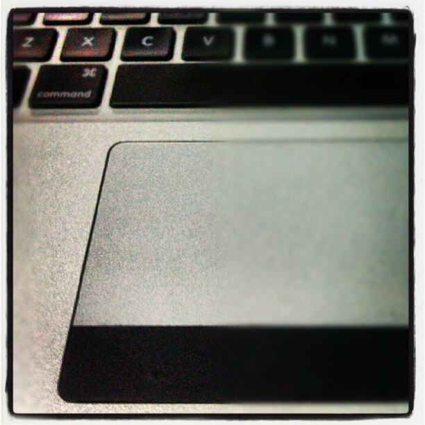

Not serious

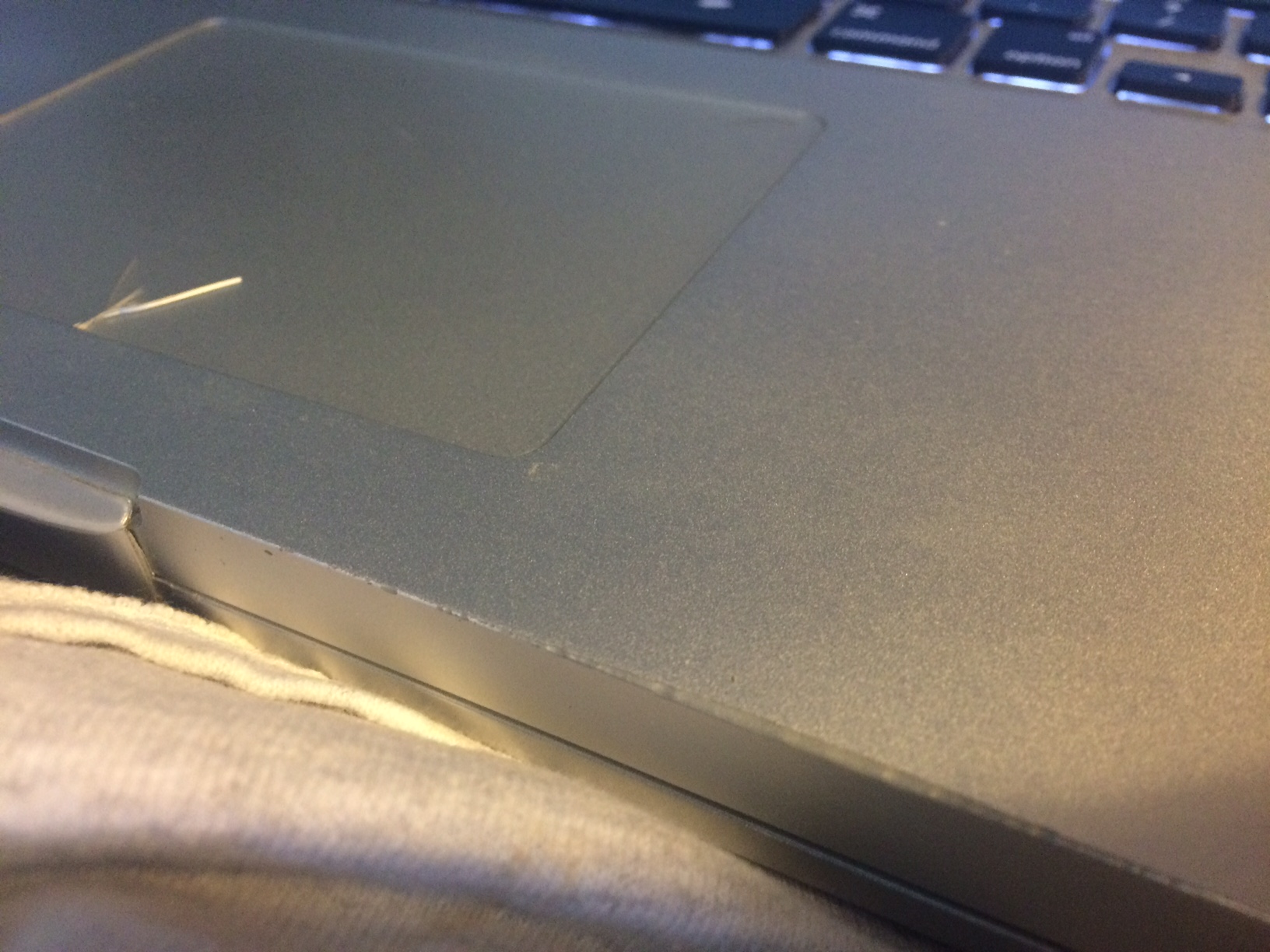

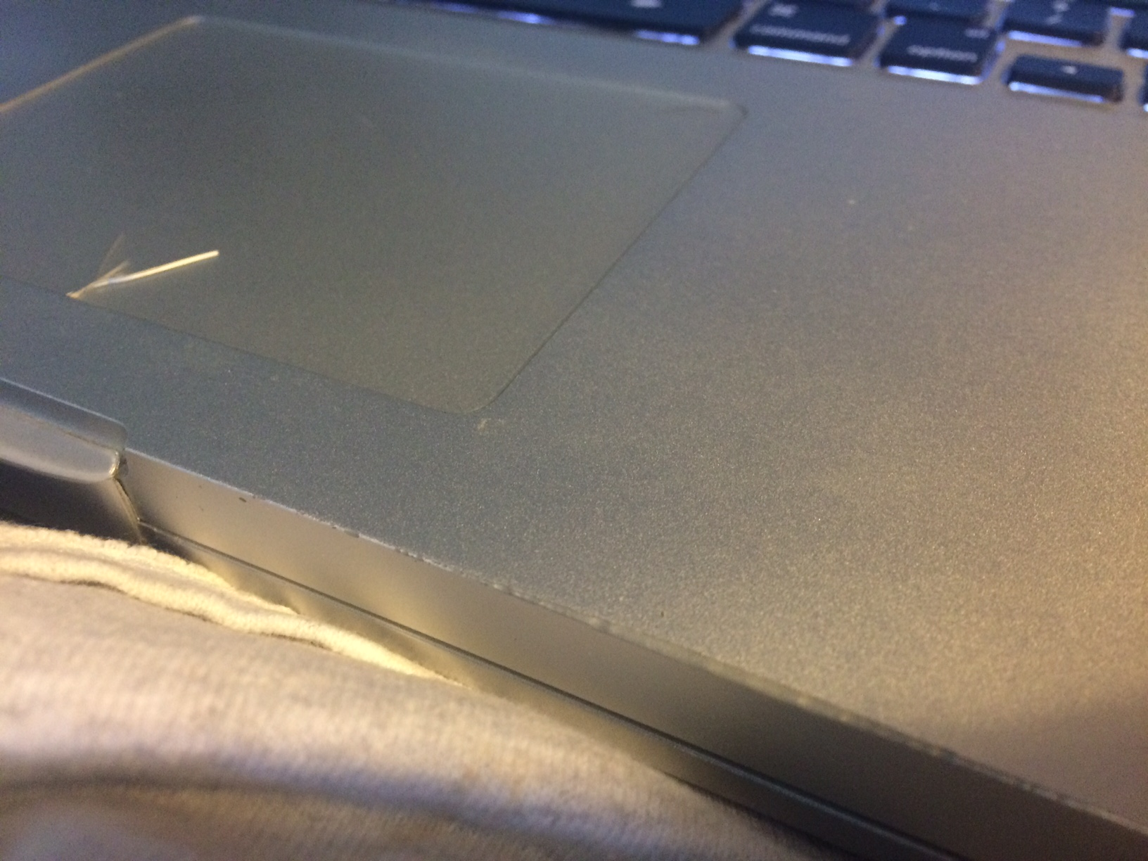

So apparently I have Hulk fingers and acid arms. It happened near the bottom directly in center like everyone else. What is the consensus about them fixing it? I was cleaning the pad with my shirt because it felt greasy and it cracked
