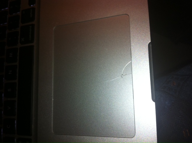

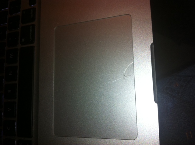

I sat on my recliner and looked down at my 6 month old trackpad and it was cracked. After considerable thought, I believe I know how it happened.
I believe it happened as a result of how I carried it upstairs. I carried it with one hand with my thumb pressed against the trackpad and my other 4 fingers supporting the bottom of the laptop.
I am out of town now but when I get back in town, I will definitely be taking it back to the apple store to be replaced. I do have the 3 year apple care plan.

Not trying to be a jerk, but why would you carry it this way? Its a GLASS trackpad, its not meant to support the weight of the entire machine, especially with all the weight of the machine focused on a such a small spot that your thumb would cover. Next time take the two seconds and close the lid.
Now that I look back that is how I have often carried my various laptops when moving from one place to another close place. i think i do it so my laptop will not go into sleep mode. never had a problem carrying my windows machines this way. i now better now.
