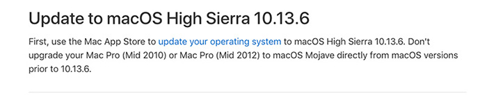

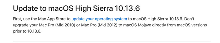

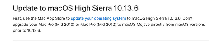

Likely depends on the model of the Mac computer. In this Apple article, the article indicated that you need to have High Sierra installed as required before installing Mojave in a Mac Pro. Probably with newer Macs, it’s not required to have High Sierra installed.
Reactions: aaronraimist
