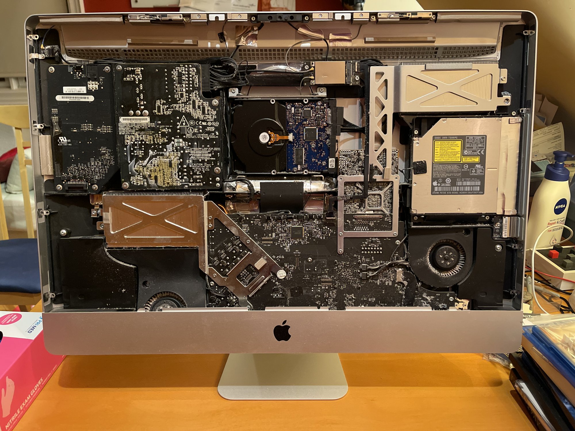

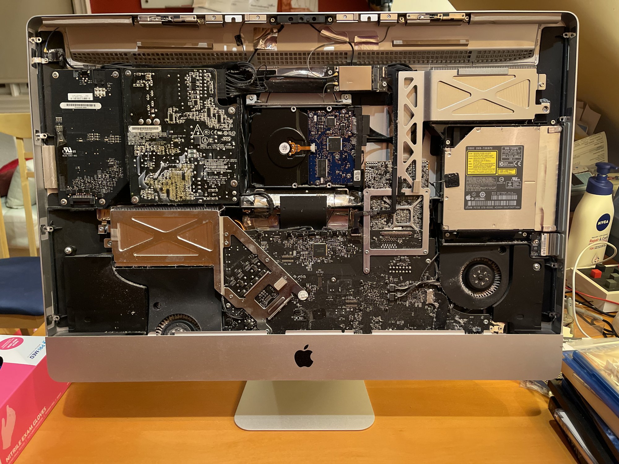

This is a full fat fan inside an iMac (6 years of use) with lots of space Between the blades vs the new display fans which are similar to MacBook Pro fans which get clogged up after a few years. Fans you can’t clean are a dumb AF design.
Holy crap! Where were you using that, inside a dryer duct or something? 😵😉
FWIW, this is my 2010 27" Core i7 iMac after 11 years of usage:
