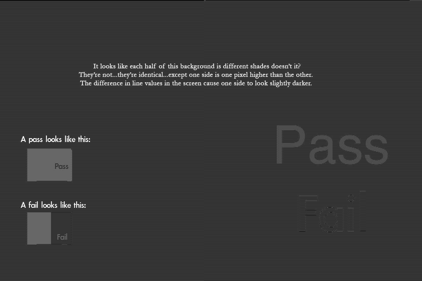

I've attached a png file to set as a desktop background that clearly shows the effect of the lines. The ONLY difference between both sides of the image is that one side is 1 pixel higher than the other. This results in one side looking a shade darker than the other.

Best picture to show the problem so far. Good Job!
Its best to open it in "Preview" and move it up/down one pixel. Also when rotated left or right the lines are continuous.

How about creating an unambiguous test image for Apple, something like this (again, I don't have a PowerBook, so the color of the word "Pass" might need to be tweaked slightly so it doesn't show up on failing PowerBooks)?
Edit: Deleted image, see, Spectrum's post, #1215 for a better version.
A funny idea 😀 - but, as you said, the grey is not quite right...
this tweaked image is closer (on my screen at least) - so long as you use the ColorLCD profile. You also need to move down the Safari window 1 pixel, or set as desktop for it to work best.
BUT: it's too close to see a difference on my iMac now...
HOWEVER! it turns out that if I look carefully, my iMac G4 17" display ALSO shows a difference in the shade of the two sides of the screen! Much less obvious than on the PB, and obviously, I do NOT see lines across images like I do on the PB, but the effect is there nonetheless, and it shifts as I move the desktopsplit image down one pixel at a time..

Spectrum said:
An funny idea 😀 - but, as you said, the grey is not quite right...
Don't get mad about the iMac. Since this images are made by human it is highly possible that they are not completely accurate so the effects on other machines should be studied carefully.
No - that isn't the case.
The lines in the images are ONLY made up of two shades - something like 64%black and 100%black. (I'm not talking about the overlaid text)
The two halves are then shifted by 1 pixel vertically.
If there is no difference in the intensity of alternate lines on the LCD, then both halves of the image should have a constant overall intensity (when viewed from a distance).
This is definitely not the case for the PB, and a difference is also weakly observed on the iMac - and it swaps as you move the image down 1 pixel.
