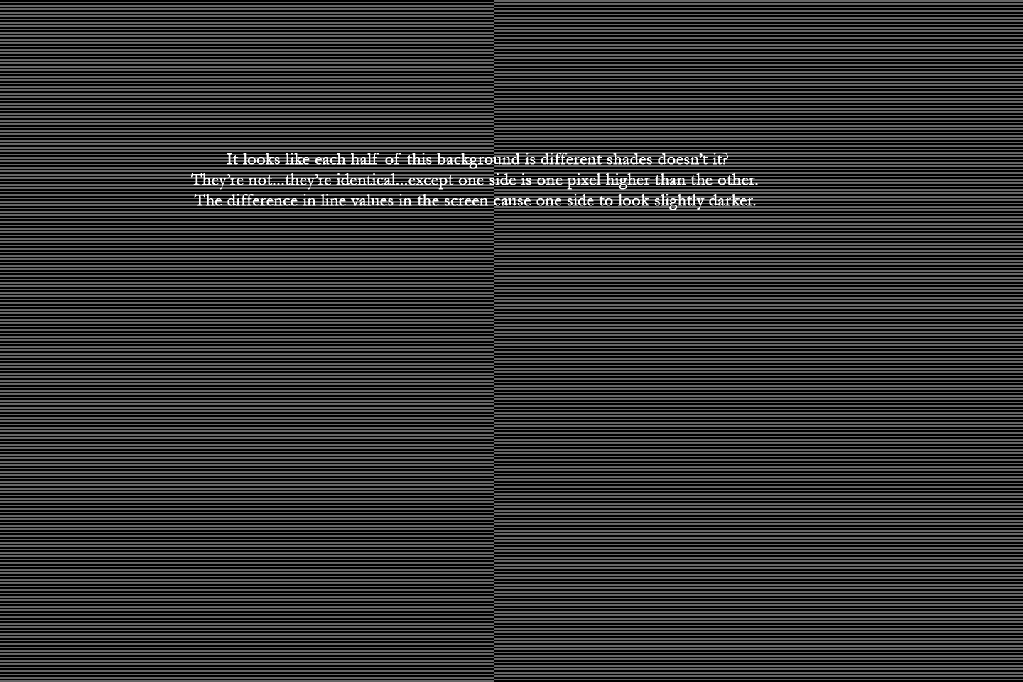

Fresh Illlustration of Line Problem
By the way, you can see even more strange effects if you open that desktopsplit.png in Appleworks in a 'draw' document then rotate it. A 90 degree rotation makes the line difference go away. If you use 'Free Rotate' to play around with incremental changes, you'll see odd moire patterns.
VisualForces said:
I've attached a png file to set as a desktop background that clearly shows the effect of the lines. The ONLY difference between both sides of the image is that one side is 1 pixel higher than the other. This results in one side looking a shade darker than the other.
Not. Pro.

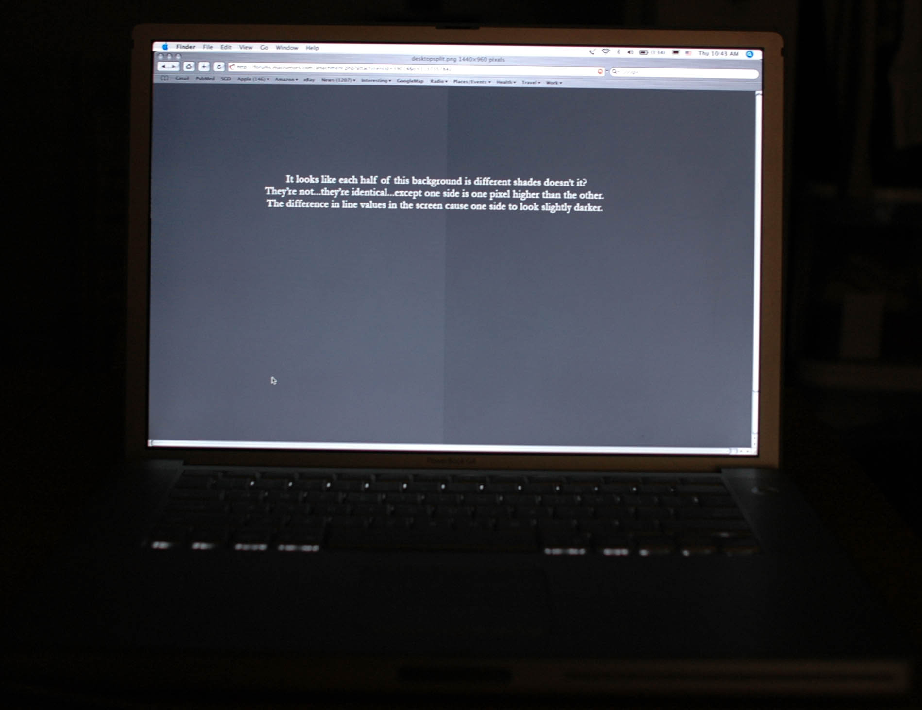

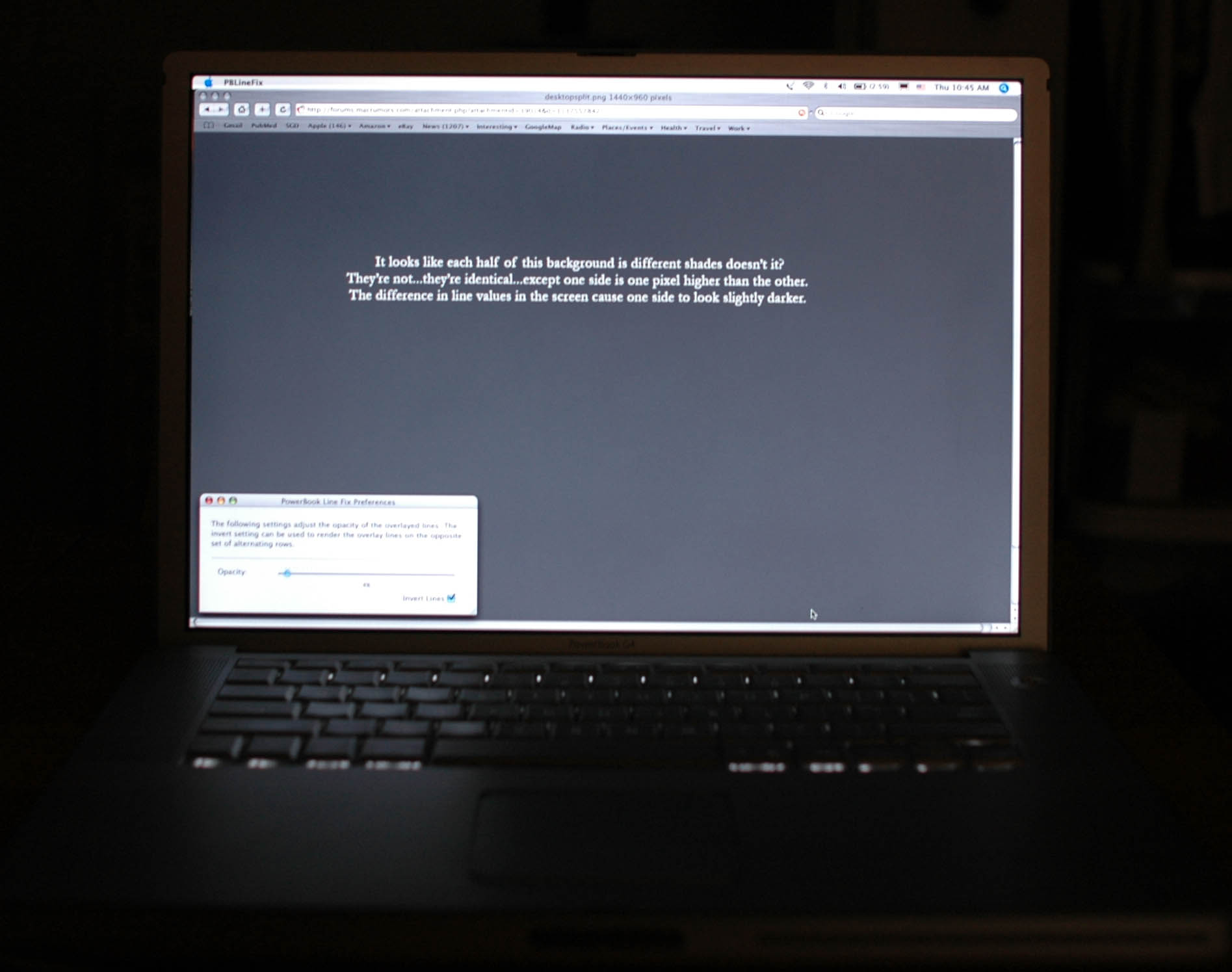

New pics / evidence
So I got spurred on by an Apple Discussions thread
Here are the pics of my screen displaying this image in Safari.
First = at top of screen
Second = one pixel down
Third = at top of screen with software from this thread running (PBLineFix)
As you can see, there is a BIG difference in the intensity of the two sides. If people don't see this, then (IMO) their screen is good. For the interested, my opinion on the software workaround is as follows: A good workaround, but NOT a fix. The required opacity of the overlaid lines depends on colorsync profile, and shade/colour of the displayed graphics. For example, I can make it so that the test image shows no intensity difference, but now I can see dark lines in other areas of the display (mostly in light shades, like the menu bar). It also doesn't work in any application that uses full screen mode, nor during expose.
