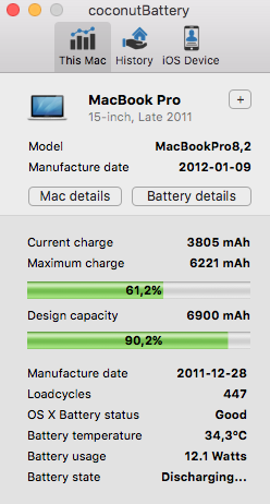

Just use it, don't bother to hassle with stuff like that, you'll properly just end up killing the battery faster. My late 2011 is mostly connected to a charger and still has 90% capacity.

But of course it is good to know, that a battery from 2011 still has 90% of its capacity. Excellent data.

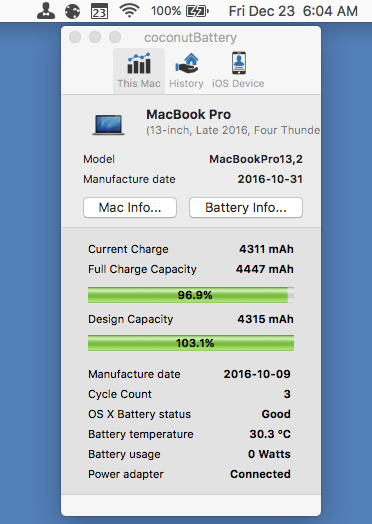

Your MacBook already does this. If you check the actual power numbers in System Report or something like Coconut Battery, you will see that after the battery is fully charged it stops charging and the system will allow it to drift down to around 95% before it begins charging again. You don't see this because macOS fudges the numbers and shows it at 100% when it is not.
Here is mine right now with Coconut Battery showing 96.9% (the true number from System Report) and the menu bar in macOS showing 100% (fudged).
