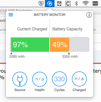

Hm - looks rather exceptional. Mine degraded WAY faster. And Apple never did anything on it despite AppleCare and having the MBP frequently with them (Radeongate). Would be great to have a sw that would regulate charging (e.g. keep at 70% +/- something, as the OP requested).

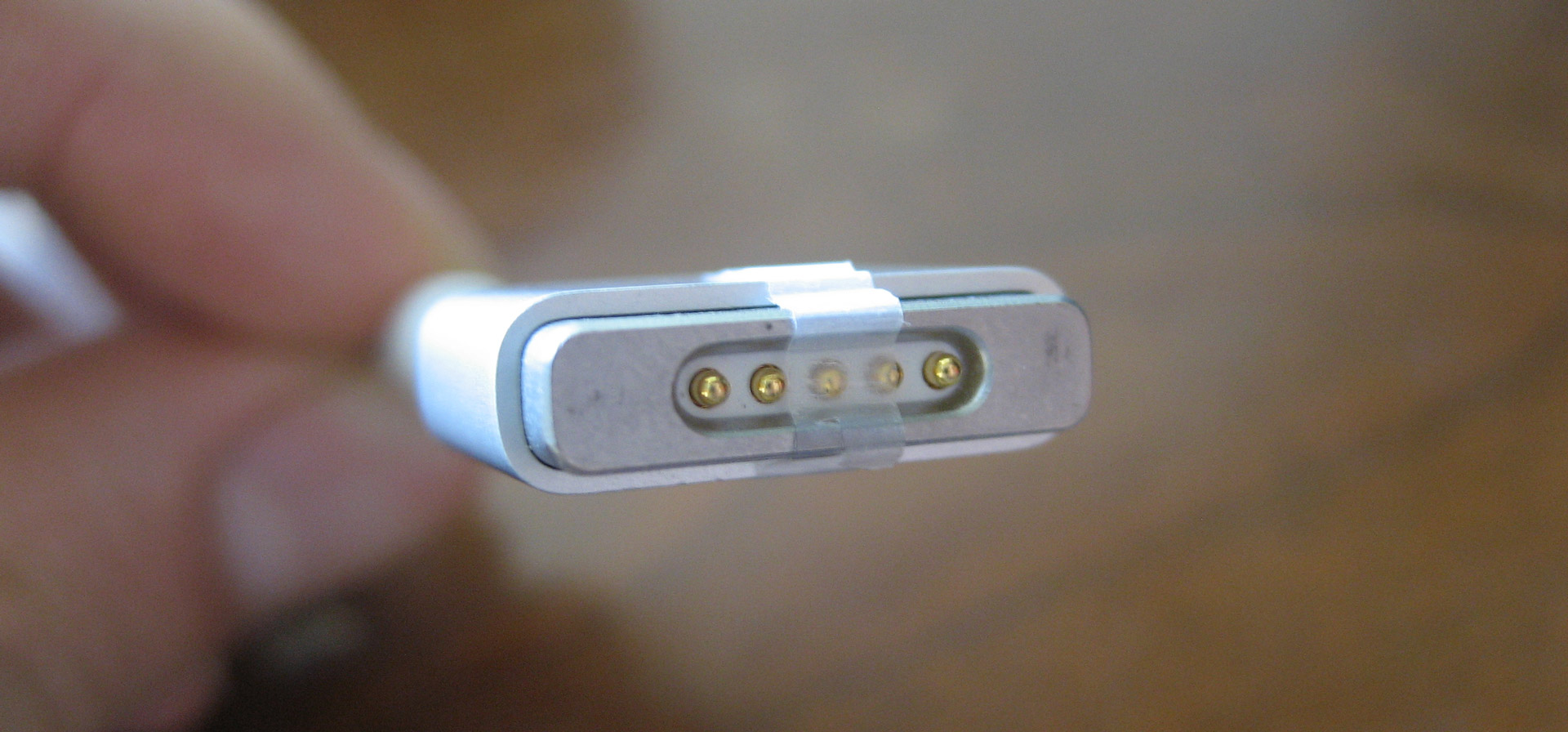

The only solution right now is available for Macbooks that use magsafe chargers. If you put a thin piece of tape over the middle pin, you will be able to have the macbook run off AC power and keep the battery charge stable.
Doing it now and I've been sitting at 71% battery for the past 5 hours.
As for there being a software solution, that is only possible if the hardware exists to cut off power to the battery. The other laptops that have a software solution to limit charge have circuitry to divert power. I don't think Macbooks have this circuitry, though I hope I'm wrong.

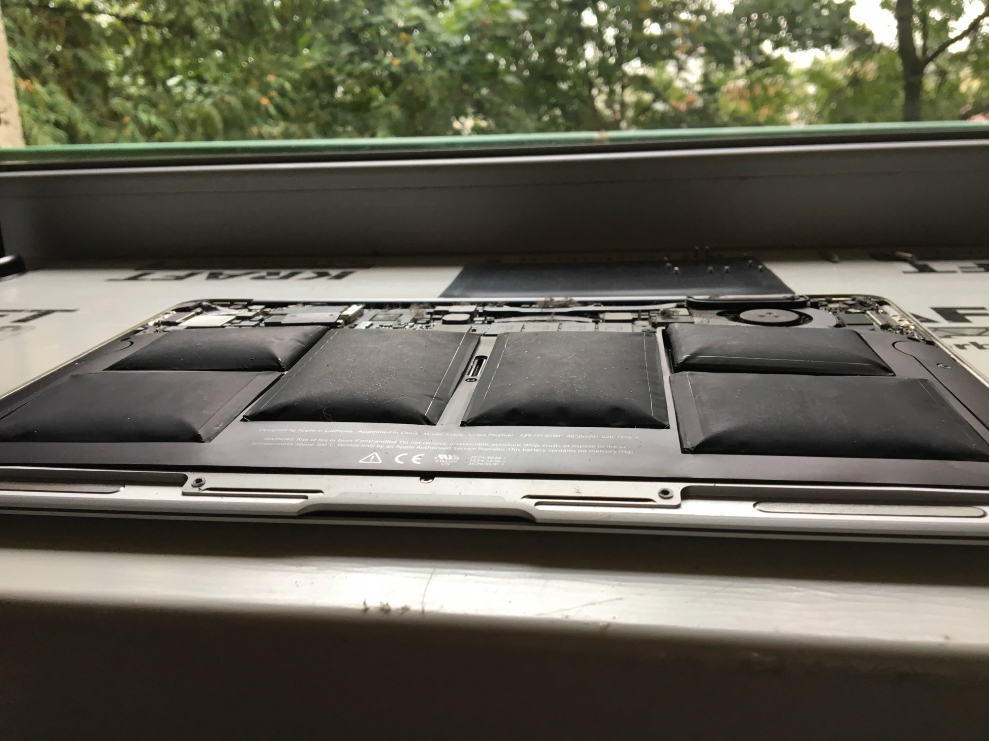

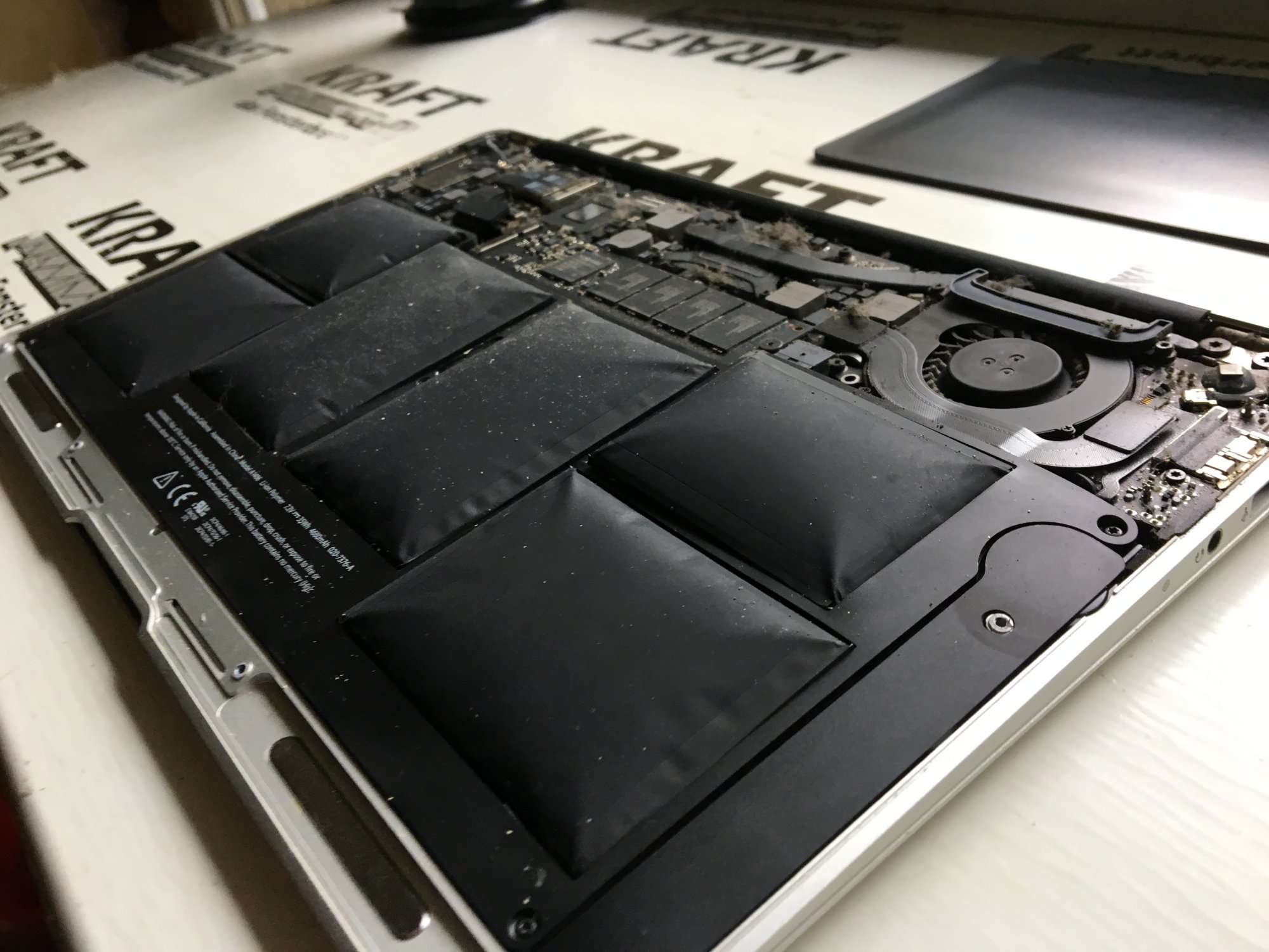

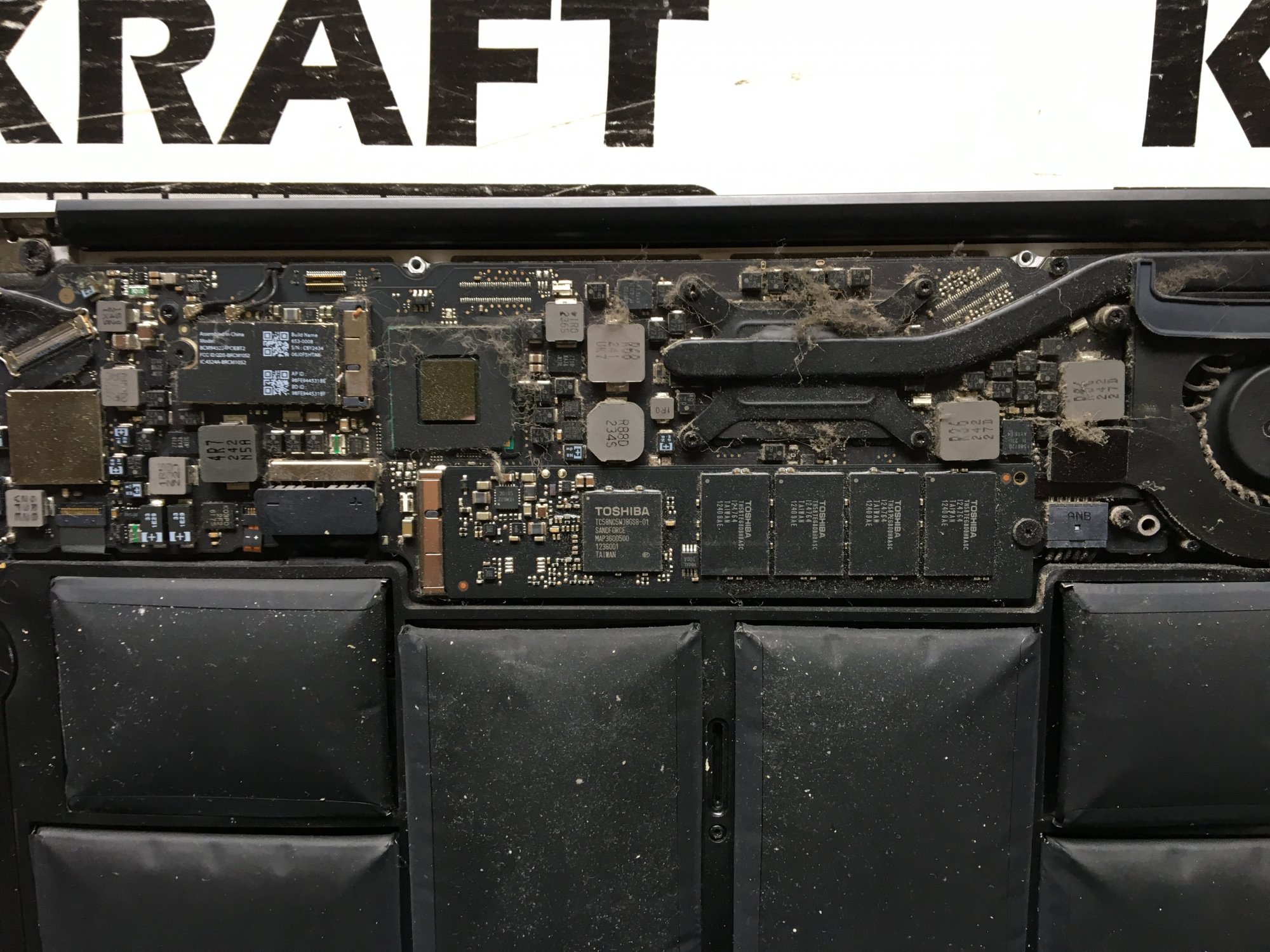

I'd like to share my experience.
I've got a mid-2012 11" MacBook Air. Spends 99% of its lifetime on AC power 24/7.
Mostly light workloads (web surfing, iTunes music playback and a bunch of other programs that mostly sit in background and create no significant CPU or I/O load).
It literally exported under 5 small iMovie projects in the past 8 years of service and that was by far the heaviest workload it experienced.
Went through a couple really hot summers (not Australia hot summers, though). Fullscreen 1080p YouTube videos stuttering hot summers. Or maybe that was bumpy road to HTML5 in Google Chrome.
Anyway, 5 years into the service, battery swelled like crazy.
Gradually, slowly they started to deform aluminium case to the point when the lid wouldn't close tight and keyboard started to look and feel swollen as well.
Never thought it was a thing. Didn't know much about Li-Ion batteries, though.
Additionally, it has never been cleaned in those 5 years.
I didn't babysit the battery. I didn't bother to clean it. Otherwise, I didn't overheat it and tried to use it sparingly in terms of throwing heavy loads at it and subjecting to detrimental ambient temperatures.
Shortly after the battery was replaced CPU fan went out.
Personally, I don't care much about reduced capacity as I know I'm going to use it 99% of the time on AC power. If it can hold out for about an hour on a battery once in a while that's all I need.
However, what I do care about is whether my batteries will get bloated and break other components in my MacBook or, you know, set my place on fire when I'm sleeping.
The first one, a 2010, had the battery bloat badly, warping the case, in about 2 years. The keyboard and trackpad wouldnt work anymore but i had external input devices and kept using it till about the 3.5 year mark and retired it
