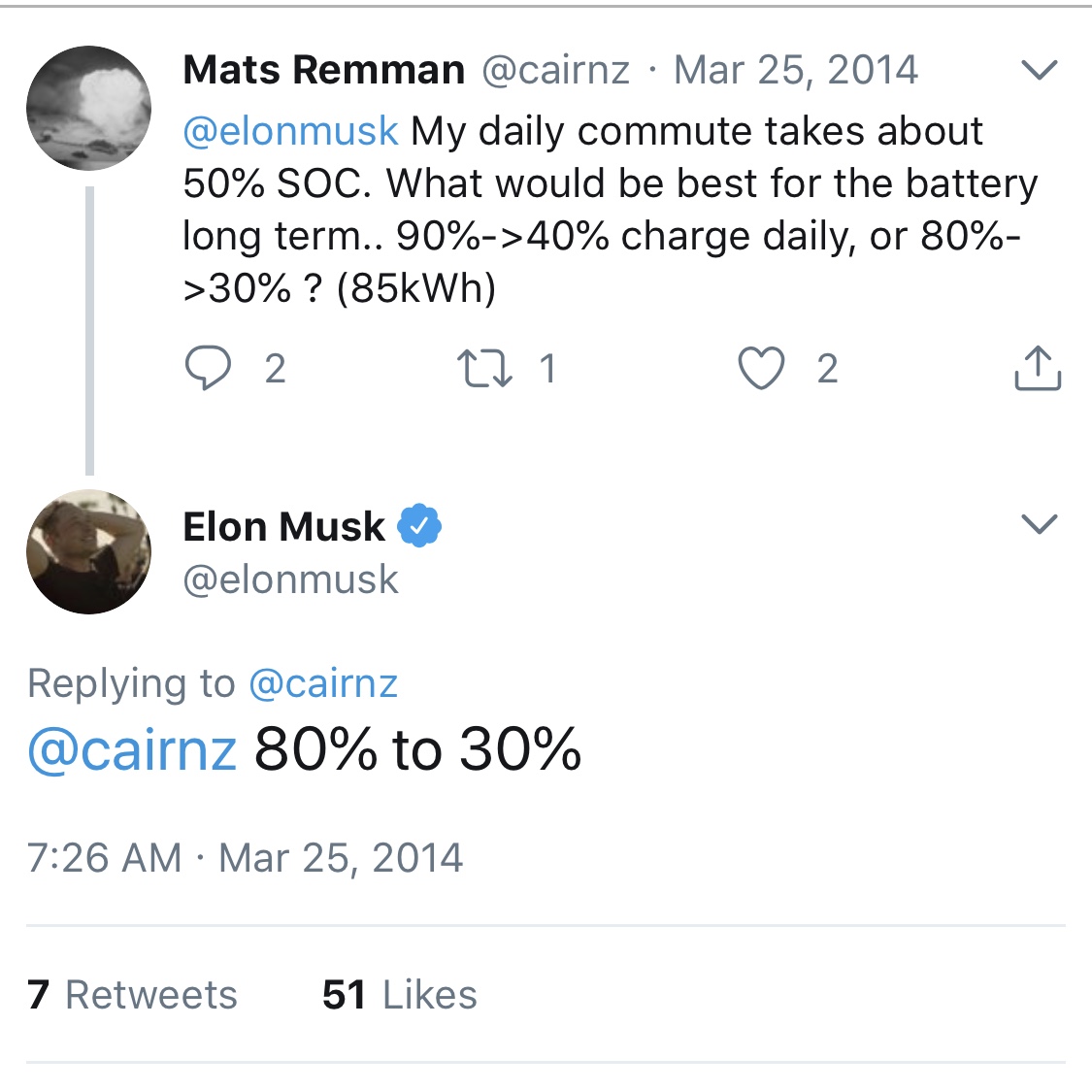

An interesting data point here is an electric car. Here, a lithium ion battery must last through a much longer warranty period. What do they do? Well, they do several things, and guess what? One of them is to reduce the actual SOC at "full charge". In this case, sacrificing range (aka run time) is mandatory to avoid a warranty claim disaster.

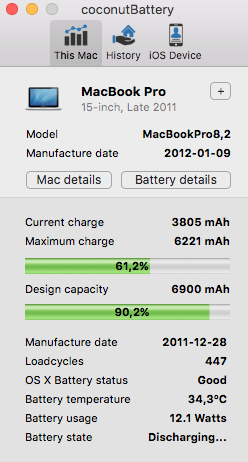

My macbook pro 2011 lived a similar life (between mid 2011 and early 2016) until it died of discrete GPU death (and i didn't bother getting it repaired).
Last i powered it up it had a battery health of about 90-91 percent (what's weird is i can still actually use it via remote desktop 😀)
No battery swelling, etc. I live in a hot climate (Perth, Western Australia) and heat kills batteries as well.

I agree and so does this pot smoking guy below...
