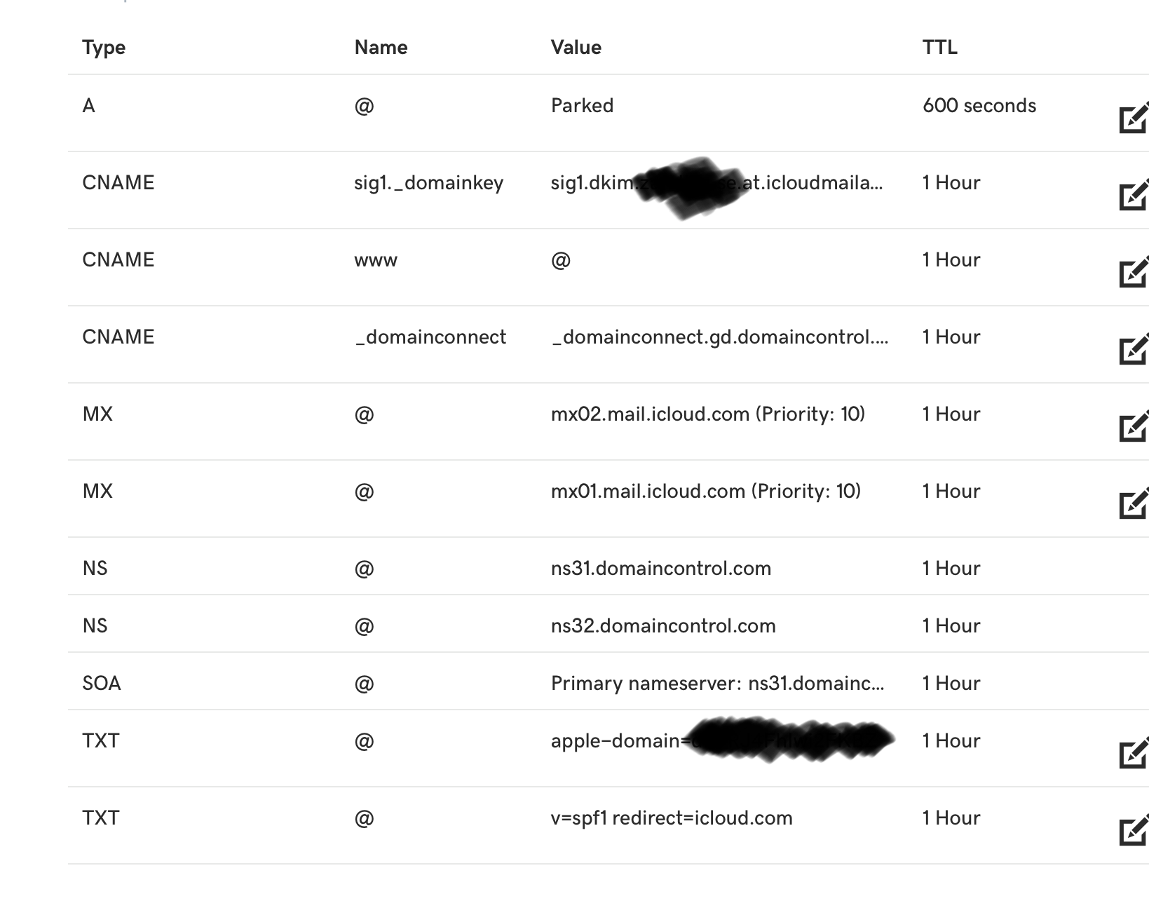

No, you aren’t supposed to setup the MS Service.
Here’s a step-by-step for GoDaddy
  1. Go to https://account.godaddy.com/products and sign in with your credentials
  2. Ignore all of GoDaddys nags and so on about setting up emails etc and scroll down to “All Products and Services“ and under domains find your domain and click DNS.
  3. Now you should see a page with Records. If you don’t, or they say your DNS is managed by them, you need to change so you use GoDaddys nameservers. You can change to the default GD ones at the bottom of that same page.
  4. Under records, make sure you don’t have any other MX entries before you begin. The others are fine to leave.
  5. Then add the ones based on the info you got from Apple. It should look something like this.
  6. After that you are done on the GoDaddy side. It may take a while for it all to populate properly.
  7. Then you setup things on https://beta.iCloud.com and add your email alias.
  8. A few notes: your Apple ID can’t be using the custom domain as the domain you now intend to use.
    Eg. If your Apple ID is papasmurf@smurfhaven.com then you can’t use smurfhaven.com as a custom domain. You’ll have to change your AppleID to another domain or use icloud.com (or me.com/mac.com if you have access to those). Changing your AppleID is done at https://AppleID.apple.com
  9. Also, family accounts doesn’t seem to work yet.
Finally, remember, this is a beta product so things may just be broken. And I wouldn’t recommend using it for your most important email address for now.
  5. Then add the ones based on the info you got from Apple. It should look something like this. View attachment 1823940

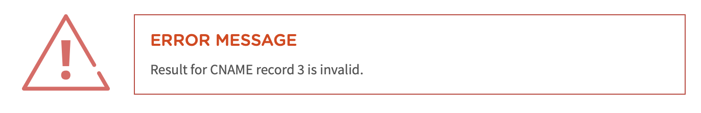

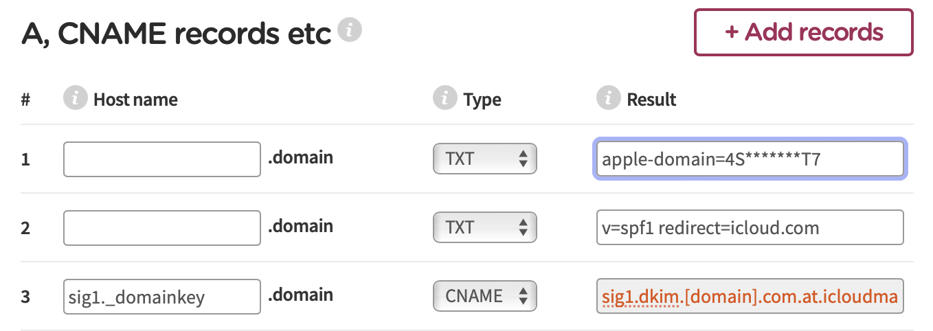

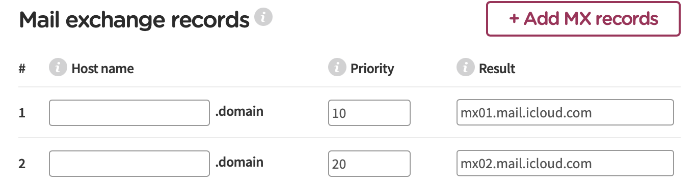

Can anyone help me out with what I'm doing wrong here - my host (LCN) doesn't like the CNAME value, or am I getting something wrong (I've obscured my domain with [domain] below, but it's just a simple word, no symbols or anything)?
Thanks,
Neil

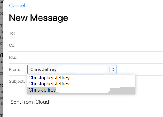

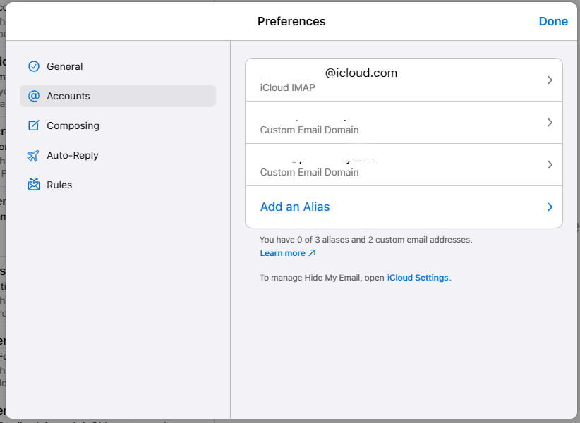

Further to my above reply, when I try to access iCloud mail in my browser, I cannot see anything there that eve suggedts my custom domain exists. I can see options to set up aliases (says 0 of 3 set up) but nothing suggesting custom domains. I can successfully receive mail at my custom domain (comes Through to my inbox) but I have:
- no way to choose sender
- no way to separate inboxes
I used to have these options with aliases. How do I do this with custom domain addresses?
When you go to preferences (gear icon under iCloud Mail) do see the emails listed under accounts?
Also, when you create a new email, you can click the from address and it should give you a list of accounts to send from.
