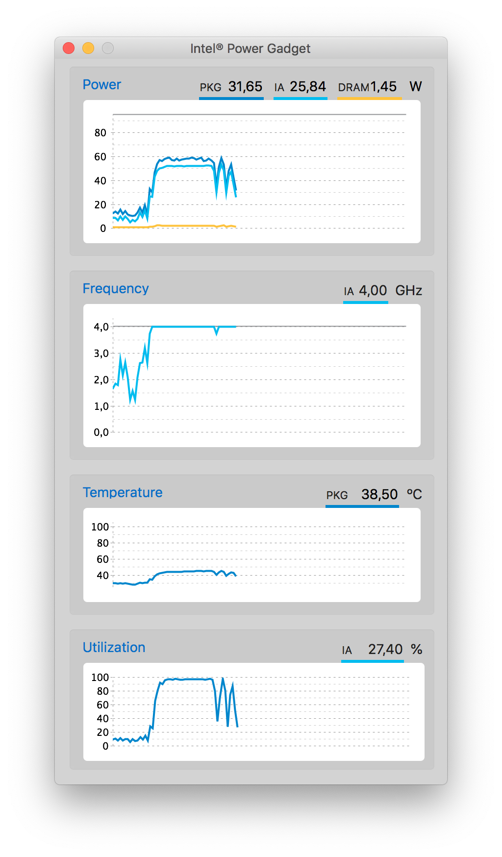

I installed TG Pro and Intel Power Gadget and started a render in After Effects. It's going very fast, but it also gets really hot. At least I think.
After a minute TG Pro reads 100° Celsius occasionally with an average around 95°. The temperature in Intel Power Gadget never gets higher than 95° and gives an average around 92°. Since this software if from Intel, maybe it gets more precise readings?
I'm not that familiar with core temperatures, so I would like to know if these results are ok. I would like to use my iMac for at least 6 years just like my last one 🙂

Thanks that's exactly what I needed to know. If these temperatures are hot, but within limits I am completely happy with it. At this moment I'm only running some lightweight programs and it's running at 33º Celsius.
Did you notice much drop in clock frequency when the temps were max’ing out? On the “old” i7 I’ve found that I can’t sustain turbo boost speeds (4.5GHz) running CPU intensive jobs as you get thermal throttling cycles plus max fan noise, but by switching turbo boost off (4.2GHz) it runs fine with a medium speed fan and slightly lower temps at a sustained pace. Be interesting to see if the i9 can do better as there is a bigger turbo boost effect on this chip (3.6->5.0).
I ran multiple heavy 8K renders of approximately 30 minutes in After Effects and it ran around 4.6 Ghz the whole time. So I am very impressed by this. Also because Max Tech tested it and it was running just above the base clock (3.6Ghz).

My iMac 2019 runs steady on 4.6Ghz on heavy load which is 1 Ghz higher than the base clockspeed. So thermal throttling is no issue on this machine. It is unfortunate you can't clean your iMac yourself, although I never had to with my previous one. And if so, there are lots of places (official and unofficial) which offer a dust cleaning service.
At this moment I'm only running some lightweight programs and it's running at 33º Celsius. I ran multiple heavy 8K renders of approximately 30 minutes in After Effects and it ran around 4.6 Ghz the whole time. So I am very impressed by this. Also because Max Tech tested it and it was running just above the base clock (3.6Ghz).

I ran the same render on both machines and my iMac 2012 stays at an average of 80° degrees. The 2019 heats up to about an average of 92° (showing in orange/red ). Is this what to expect from the new 2019? Just want to double check this is expected behaviour and my model is ok.

This is consistent with all of the other benchmarks I've seen. The new chips run HOT. It's one of the main reasons I've been hesitating to buy one. Will it hurt the machine in the future? I don't know. But I do know extra heat can cause damage to components to computers. Also if the fan has to run more often you can get dust build up, which on an iMac you can't clean out.
As for recommendations to keep it cool. I've seen people report success with Turbo Boost Switcher to turn off Turbo Boost. You take a slight performance hit, but it may not be noticeable in real world testing. You can also manually turn the fans up while running intensive tasks (rendering, gaming, processing sound, etc.) using Macs Fan Control. Of course you have to be careful when adjusting settings, and running the fan more could increase the chances of dust accumulation.
Other tricks I've seen people mention are to put a fan under the "chin" of the iMac to force cool air in or put it on the back vent to help draw hot air out.
For me, I'm just not certain I want to buy something I have to jury rig cooling solutions for.
