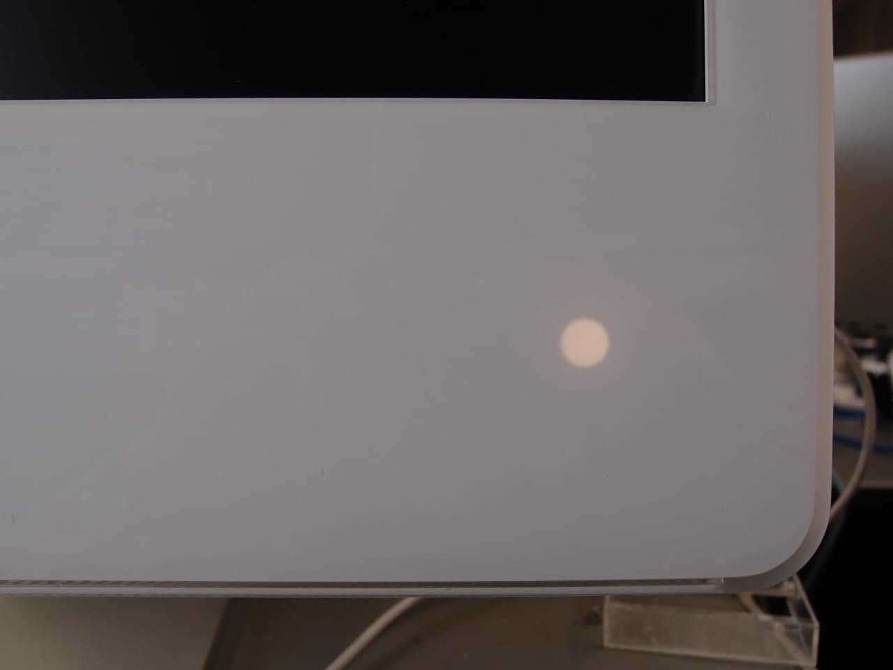

So one thing I've just noticed in my original video uptop, the bottom right corner, white LED light does not illuminate.
Some of the iMac's i've seen online have it on, indicating the unit is turned on.
Would mine be broken or just somehow disabled?
For what it's worth, I have a 17" non iSight model. My white LED is only on when the unit is sleeping. It fades in and out. Otherwise, it's not on at all.

It is supposed to go on at boot, then fade out right before the screen kicks on. It will "breathe", like on other Macs, when in sleep mode. This is the same for the iMac G4 and eMac.

Great, thank you for the clarification.
