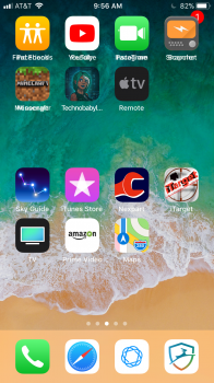

The glitch that bothers me is tapping the Calculator or Timer button on Control Center doesn't take me to the app, just goes to Home, almost like it overloads the memory and it can't bear it. This happens on my iPod Touch (the latest one). I can't believe this actually happens, and I haven't seen it mentioned. Is it just iPods?
