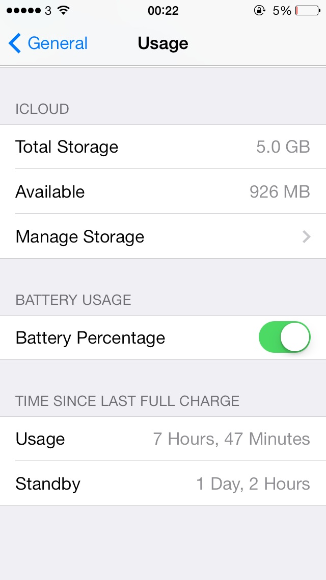

Would you guys consider this good? I have felt I have had awful Battery life ever since I got iOS 7. My iPhone 5 is only a few months old, I got it in July. I was even thinking of going to an Apple Store and seeing if they can do anything. I guess this is just the way it is.
As a sort of test yesterday I drained my battery dead and then charged it up. I have not plugged it in since at all, even over night which I usually do. This is the result as of this morning. My usage is mostly internet, some videos and a lot of audio like podcasts. I have background app refresh on but only for maybe 4 apps.
For those of you who try to set your device up as new to alleviate battery issues, do you set it up new and KEEP it that way or restore a back up after? I just don't have the option to do that. I have apps with data I could not start over on. How do you manage not restoring all your stuff?
Your battery behavior is fine ...

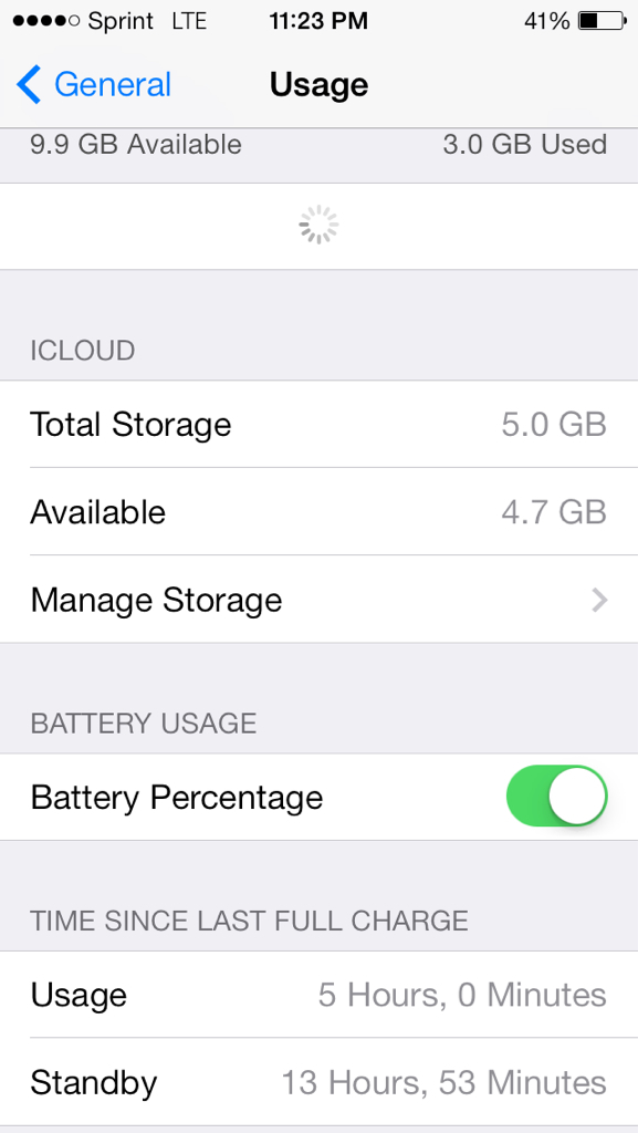

Right now I'm at 2:20 usage and 8 hours standby and I'm at 45%
That will average about to about 5 hours of usage. If 5 hours is good then I guess the ppl getting 8 or 9 are just lucky.
