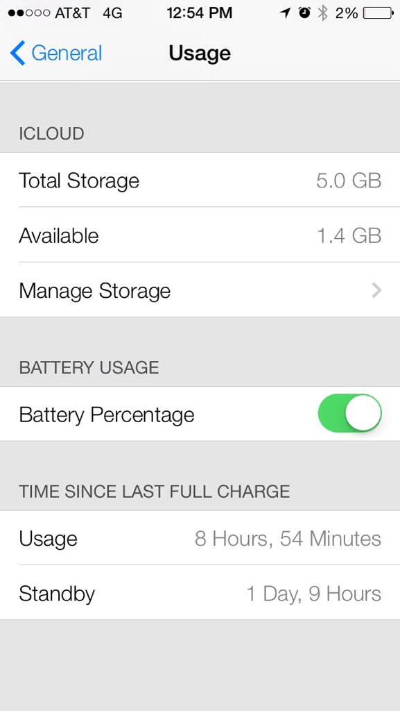

I updated my iPhone 4S to iOS 7 without restore too. Battery was utterly horrendous until I disabled Background App Refresh and Automatic App Updates and reset my network settings. Battery drain is as normal now.

I charged it last night before I went to bed. Used it slightly, it was at 86% when I went to bed and when I woke up it was at 60%. It is currently now 1.5 hours later at 37%.
In the past 1.5 hours all I did was go on tapatalk, facebook quickly, reset network settings, downloaded an app!
Settings are no app refresh, frequent notifications off, motion on!

Battery declining 2% every 10 minutes lol so I guess my clean install didn't work

great so far 28 minutes of usage, 38 minutes of standby and im still at 100%

Wow that is awesomeness lol it's like I'm losing 1 % every 3 min it seems! With everything turned off haha
