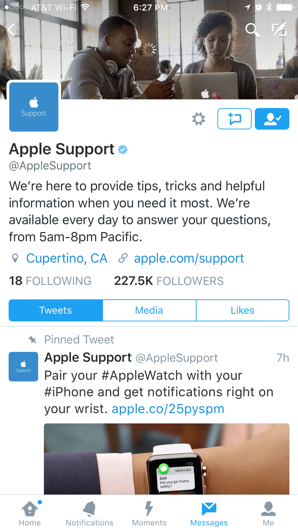

If you have a Twitter account you can message Apple directly about this issue.
Seems to be a lot more customers impacted.
