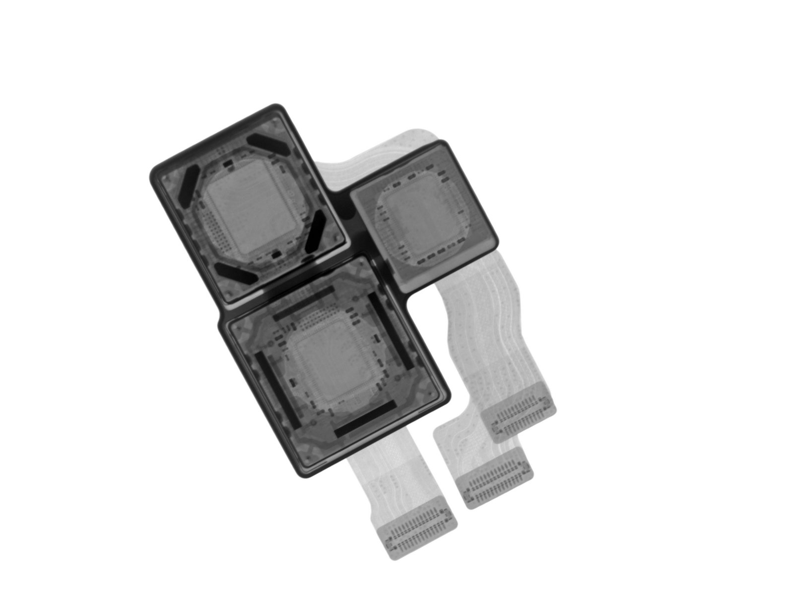

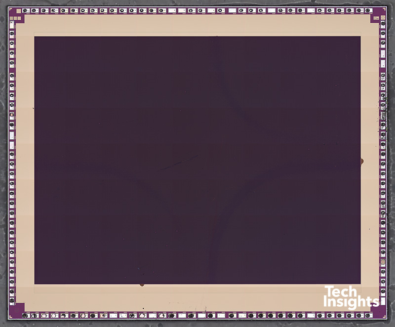

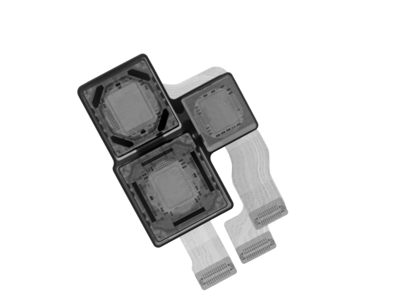

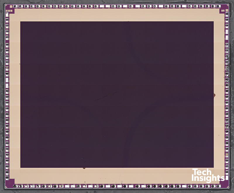

There are plenty of full teardowns of the camera. There's no data processing in the sensor. Your argument reminds me of posters who believed Apple somehow stuffed 2GB RAM inside the iPhone 11 Pro camera module for a total of 6GB RAM.
View attachment 976504View attachment 976505
You're showing me a 12 thousand pixel image of a 12 million pixel sensor to prove there is no data processing on the camera module? You understand that you can't see the logic at that scale, right? This is the part of the device that truly is microscopic, without hyperbole.
But I'm not sure why we're even arguing that point as I never said there was any processing happening on the camera module in the first place. In fact, I think I said that there were a ton of callibration parameters that need to be handled by the phone itself, and perhaps learned through the neural engine, to support the computational photography in iOS which is one possible reason why you can't just swap modules and expect it to work.
The harder you argue that the module itself is dumb, the more credence it gives to my suggestion...
They also said 'essentially' and I am well aware that T2 is a Mac specific chip. I am assuming they were referring to this article wrt t2, and are drawing a comparison to this scenario with the iPhone
Again, what are you arguing about here? I said there is no T2 in an iPhone as a few words at the end of a much longer comment to someone else. Do you think there is a T2 chip in the iPhone? If you do not think there is a T2 in an iPhone then it seems like one of the few points we actually agree on, so why are you now linking me to 2018 Macbook repair articles?
