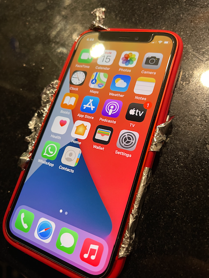

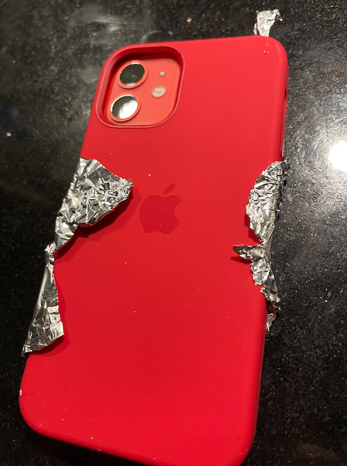

Same problem here... However, here's my temporary fix. It could be just me, but it also seems that this fix made 4G much faster, too!

With this work around, you shouldn’t need to use tin foil on the side of the case or touch the camera circles.
