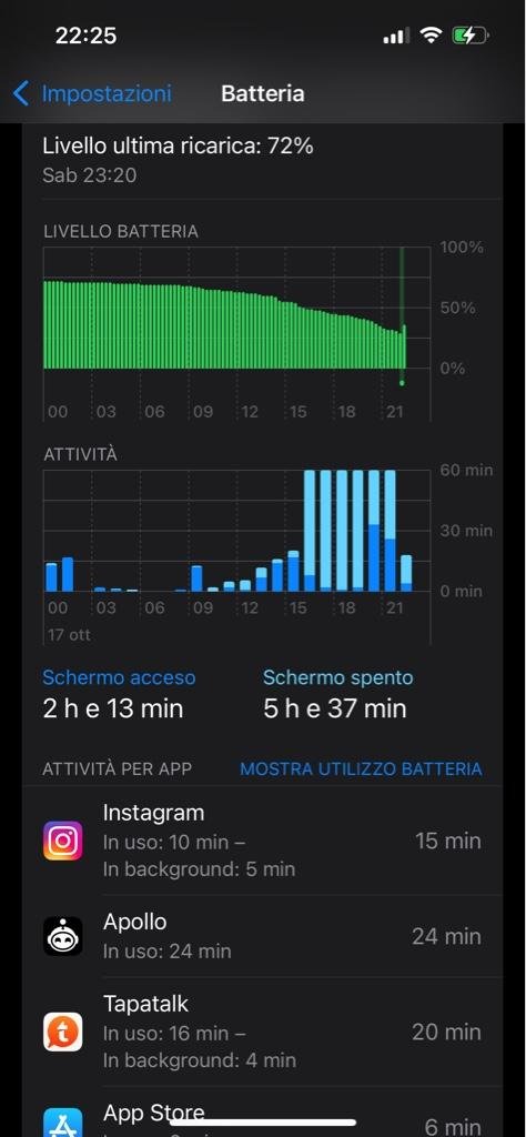

Indeed. Anyway for what it’s worth, here it is. Last charge almost 24h ago, very light use. The high off screen use today is since I activated AdGuard Pro DNS VPN filtering. High use but actually consume very little battery. Big offender is also scrolling fast and using often the full 120Hz
It looks like you had about 7 hrs 51 mins (about 471 total mins), about 44% battery usage. You last charged to 72%. Am I getting this correct? If this is all correct, you have not been getting good battery life, you have been getting incredible battery life.

Screen off time of 337m should not be added up with Screen on time of 133m
Recharged at 30% means SOT of each % is 133/42=3+mins
If I'm getting this correct, then those apps running in the background are the drainers

I don't add screen-on time and screen-off time together, I compute manually each bar of the battery usage chart, starting after the battery charge has completed. And those apps that are grouped into the screen-off time consume battery. Those screen-on and screen-off times are calculated even when you are on the charger and using the app.
The OP had a total of 471 mins of battery usage total, off the charger.
So means I have a total of 624mins of battery usage total, after deducting the charging time
It looks like about 612 mins between your first and second battery charge, used 32% (80%-48%). battery it looks like. I would count the battery life after the second charge separately as that charged back to 80%. And I don't include app times that are during charging because is not really using battery on its own.
Pardon me but how did you see I recharged the phone at 48%? Such a precision
