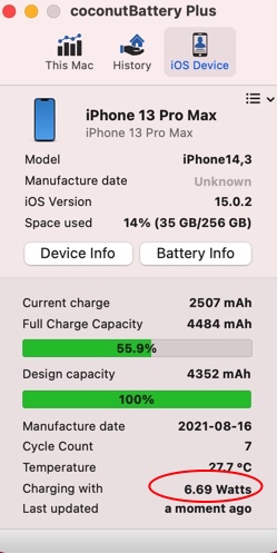

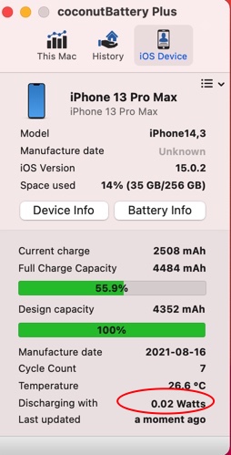

Sorry if this is basic, but what did you look at in CB to see the idle battery expenditure? Just logging history for the battery? I wasnt aware you could use CB in real-time. Thx.
Where I marked it. For example right now with the phone idle. It’s expending .02 watts. Practically nothing. It is a real time number and changes. You can also see charging rate. Very useful if you want to test different chargers.

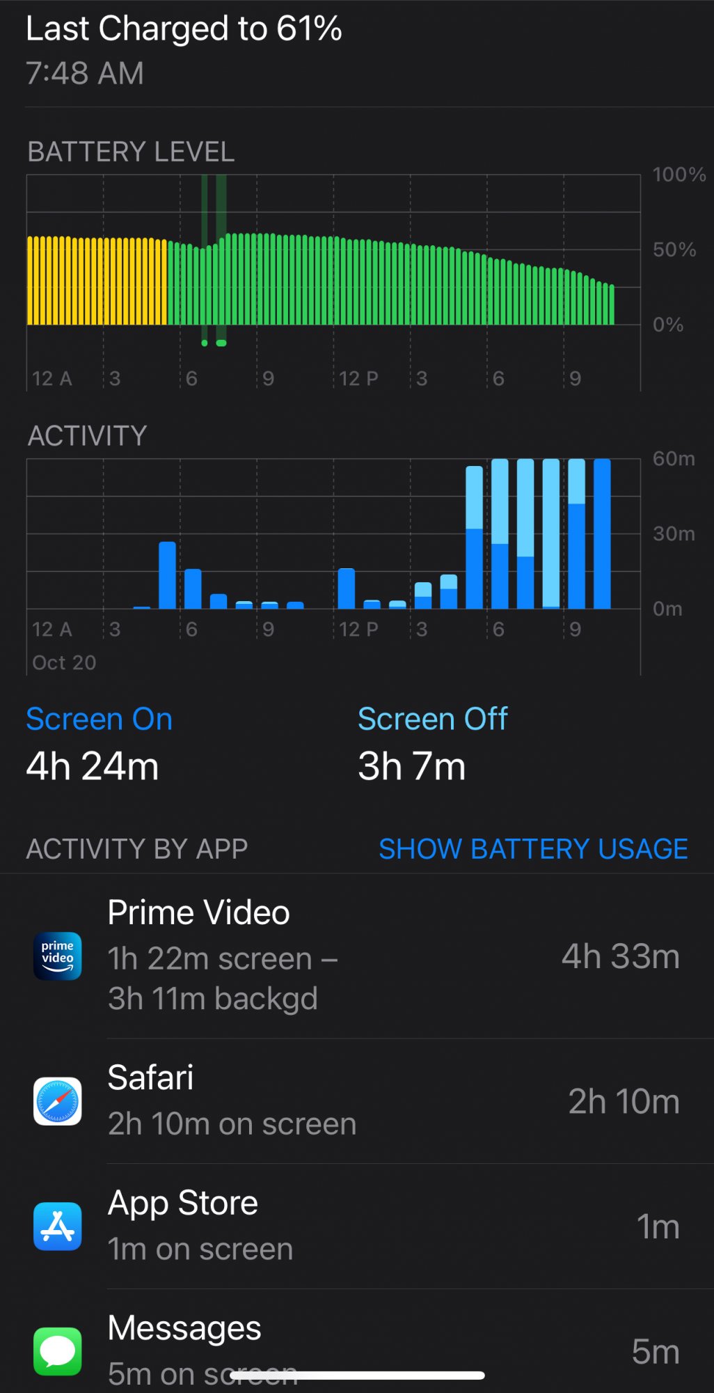

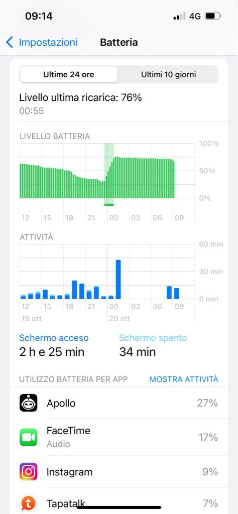

As you can see, during night my phone discharge constantly and I want to know if yours do the same. If not what should I check? I have low signal but I have wifi on and I never close apps in background.

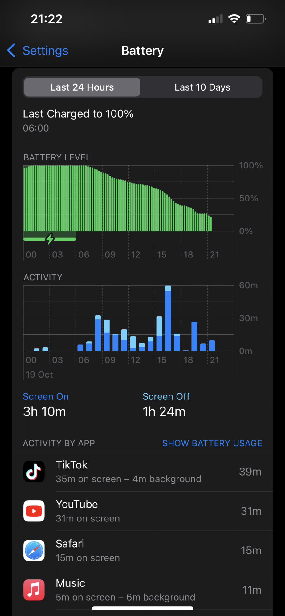

It looks like you got about 5 hrs 3 mins, 80% battery used. Estimate to 100% battery usage, 6 hrs 18 mins. Not great battery life, more on par with what the 13 Mini would get. Is this what you are seeing for battery life consistently? If it is then maybe you want to try a couple of different things that might help;
  • Reset All Settings. This won't erase any data on your phone. It will just reset all the settings back to factory. I would try the phone for a few days after doing this to see if it helps.
  • Connect your phone to a Mac computer, backup the phone to the computer, do a DFU, restore while in DFU and restore from backup stored on the computer.
Thank you for your reply. I'm getting this kind of battery life pretty consistently. I followed your advice and I have reset all settings. Will try it out for a couple days and see if that helps. Thanks again!

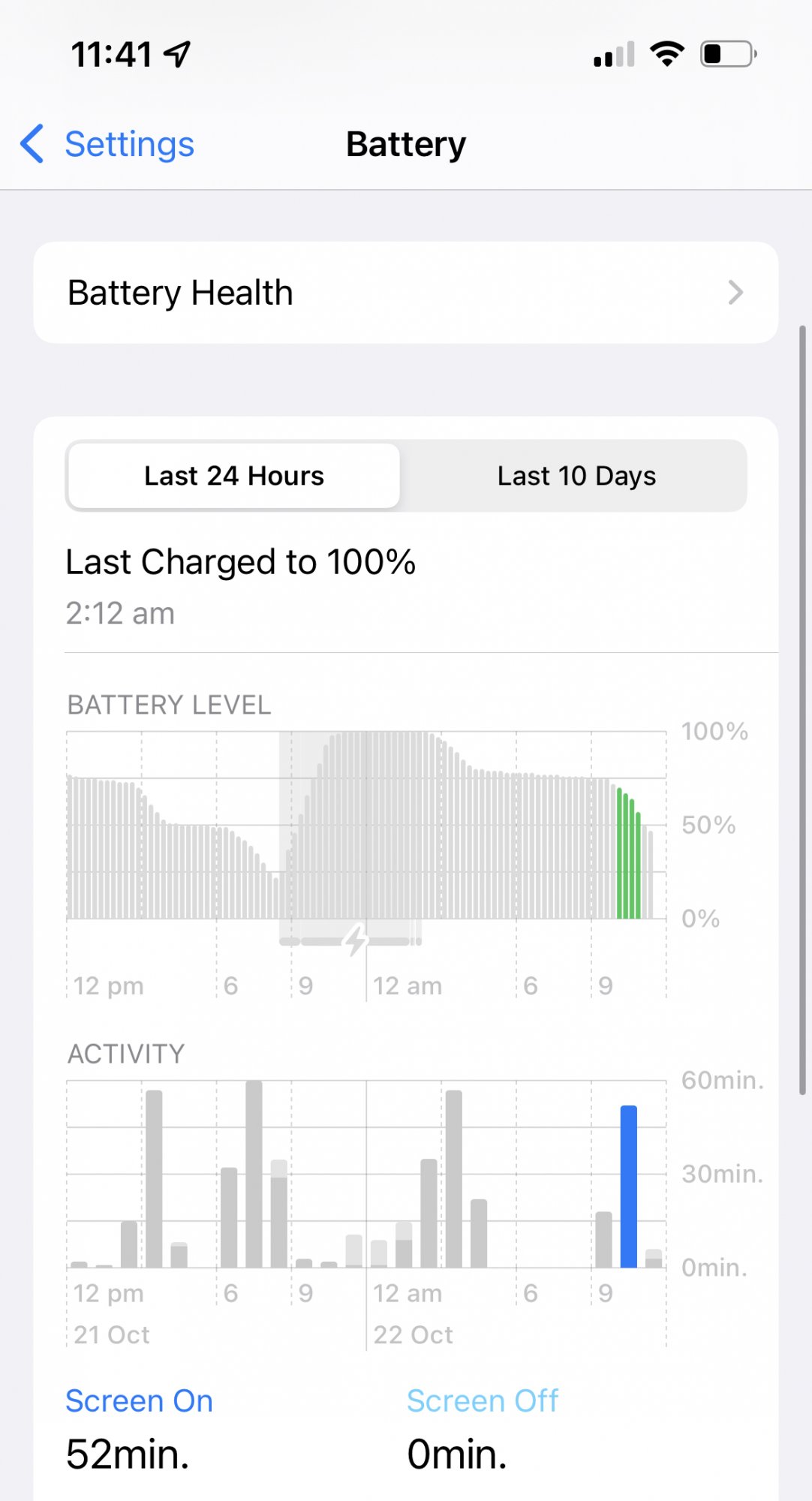

I think it’s normal as you also have some background activity. My 13 Pro is similar and I also put in in airplane mode. 2/3% loss anyway
I’ll try to put in airplane mode, then I’ll tell if something changes.
Woa. I am confused. When I plug in I get "Discharging with..." whatever value was last shown as "Charging with..." Then after a moment it shows "Charging with..." and gradually goes up to 5W or so.
- How do you get "discharging" without the iPhone charging from Mac?
- How can you test a charger? I'm missing something here...
Ok, after plugging in, unplugging, plugging again, I briefly saw "Discharging with 0.42 Watts"... is that it?
Edit: Duh. Wifi.... With cellular ON discharges about .13-.23 Watts. Will Cell Off about 0.03-0.04. Very cool.
Maybe I need a shortcut to turn off Cell when I get home, and turn on again when I leave.

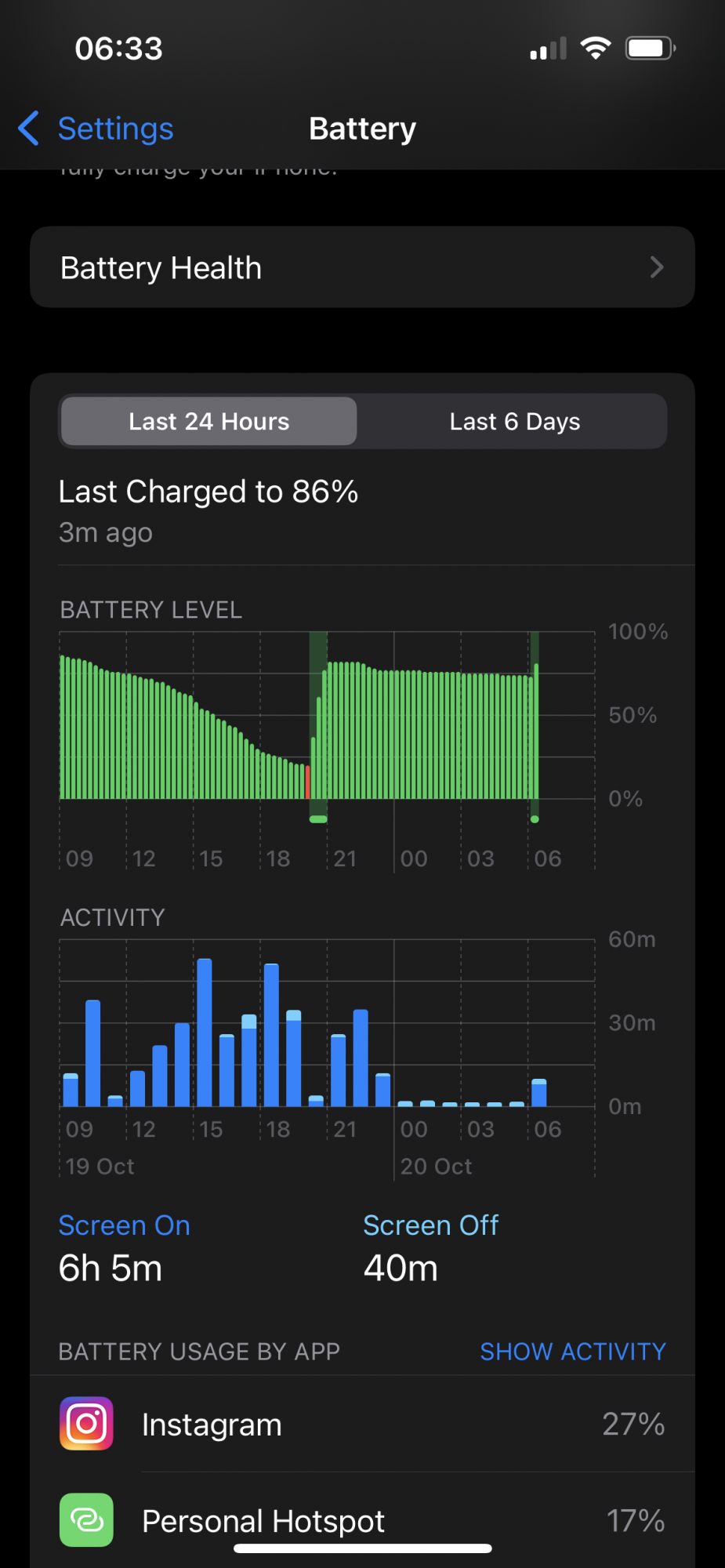

Attached the screenshot of the battery usage on day one with my iPhone. I was left with 73% before plugging in around 10pm. I guess this is pretty solid?
iOS 15.0.2
iPhone 13
Today I started with 80% and lasted until 5:30 pm to 20% and I had a pretty bad cellular coverage that I think influence a lot. Not only on cellular data but also wifi.
iPhone 13 Pro Max
iOS 15.0.2
6 hrs 51 mins, 35% battery used.
Estimate to 100% battery usage, 19 hrs 34 mins
It looks like you had about 4 hrs 45 mins, 27% battery used.
Estimate to 100% usage, 17 hrs 35 mins. Looks like you had 0% battery loss in standby, which is outstanding considering it was 8 hrs in standby. You have really great bonkers insane battery life.

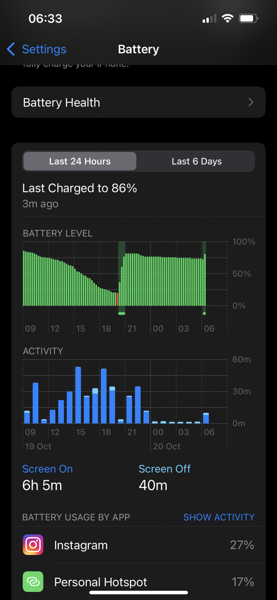

What’s with mine 😂
Only 4 hours of screen time today and already down to 32%
Should I reset and restore? Can’t seem to find any rogue app.
