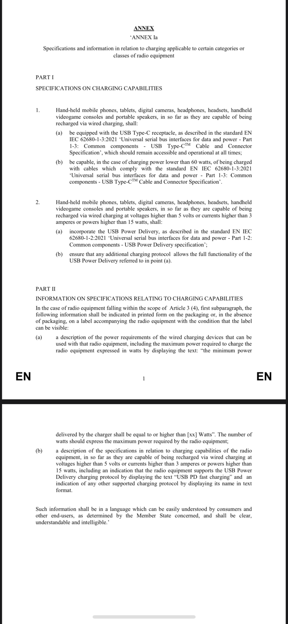

Yes the annex is, and while it defines charging standards for the device, nothing in the law limits cable design; which was my original point.
Hand-held mobile phones, tablets, digital cameras, headphones, headsets, handheld videogame consoles and portable speakers, in so far as they are capable of being recharged via wired charging, shall:
(a) be equipped with the USB Type-C receptacle, as described in the standard EN IEC 62680-1-3:2021 ‘Universal serial bus interfaces for data and power - Part 1-3: Common components - USB Type-CTM Cable and Connector Specification’, which should remain accessible and operational at all times;
All this requires is a physical plug design, the USB spec allows for a variety of connections and customization of the pinouts.
(b) be capable, in the case of charging power lower than 60 watts, of being charged wi cables which comply with the standard EN IEC 62680-1-3:2021 ‘Universal serial bus interfaces for data and power - Part 1-3: Common components - USB Type-CTM Cable and Connector Specification’.
Even more interesting, devices do not have to be capable of charging at the lowest specs and thus not be compatible with those cables, only if thy have a low charging mode. The rule for power labelling also provides for showing what the minimum charging power required by the device, which if all devices had to support <60W would be unnecessary.
Then we get to PD requirements:
Hand-held mobile phones, tablets, digital cameras, headphones, headsets, handheld videogame consoles and portable speakers, in so far as they are capable of being recharged via wired charging at voltages higher than 5 volts or currents higher than 3 amperes or powers higher than 15 watts, shall:
  1. (a) incorporate the USB Power Delivery, as described in the standard EN IEC 62680-1-2:2021 ‘Universal serial bus interfaces for data and power - Part 1-2: Common components - USB Power Delivery specification’;
  2. (b) ensure that any additional charging protocol allows the full functionality of the USB Power Delivery referred to in point (a).

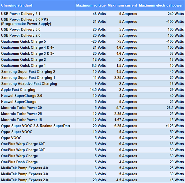

Which allows different charging protocols as well. So while there is a standard, it does not ensure every phone can use any cable to charge at any specific rate.
The rule has a lot of exceptions built in, beyond fully exempting wireless only charging from requiring a plug.
Well actually they do, it’s specified in the USB standard. Such as when you use a USB-c to usb-a outlet, they are limited by the specification. And to be in compliance USB PD includes a range it can operate in.

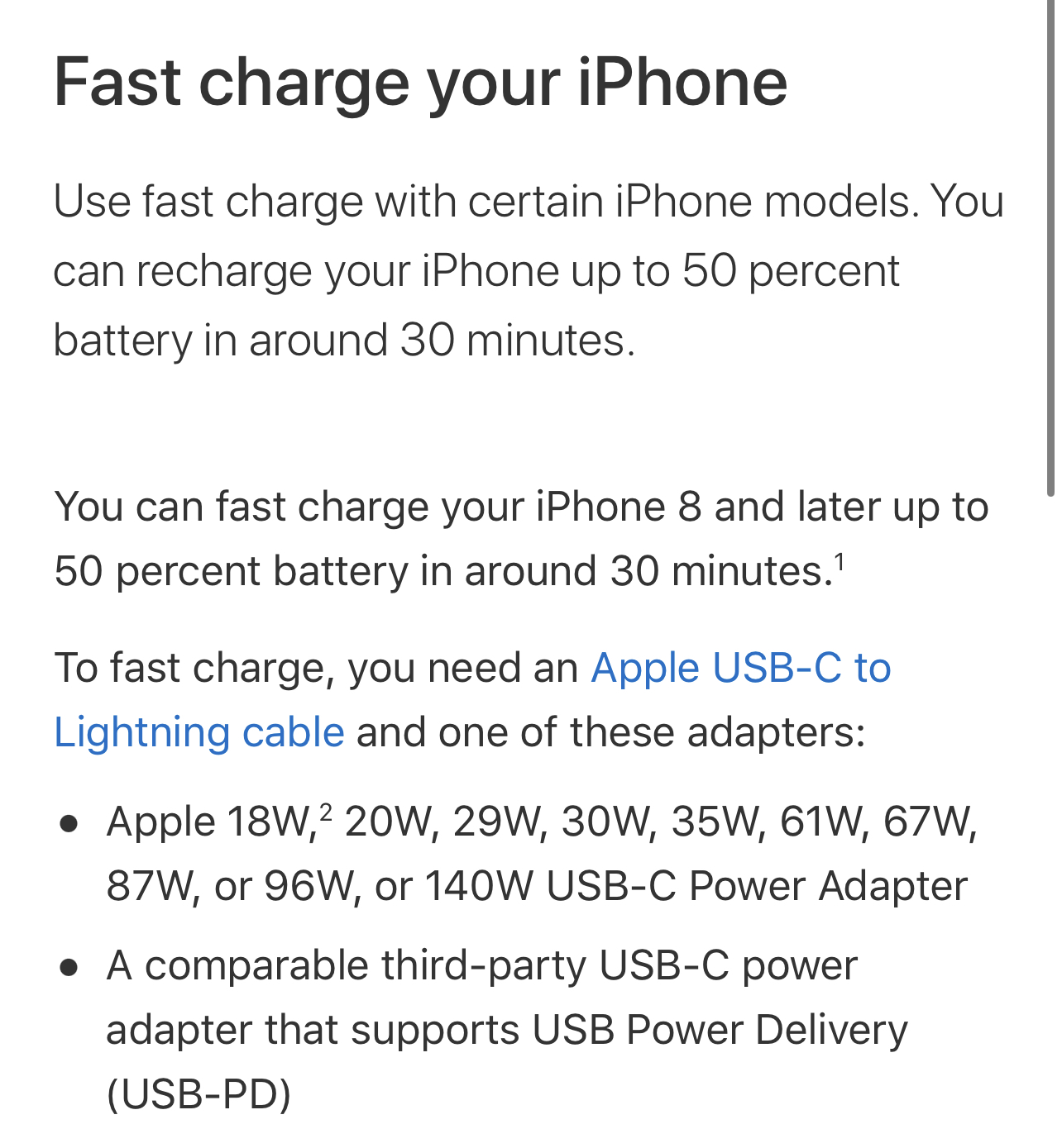

Of all my Apple products sitting on my desk, all are being charged by 3rd party chargers and USB C cables (6-10ft 100w Anker USB C cables).
I would put $ down on the table that these same cables will charge the next iPhone (or 2024?) no problem ... because they charge my iPad, my MacBook, and other Apple devices no problem.
I wouldn't exactly be shocked though if Apple released a 30W USB-C Power Adapter Pro/Max/Ultra to charge new USB-C iPhones at that rate - and/or licensed such new charging protocol to third-party MFi vendors. ;)
