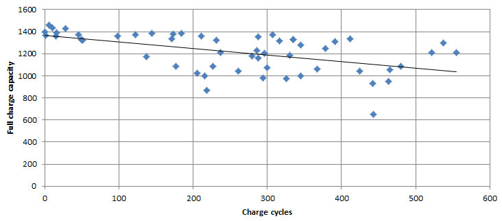

Merkie here had a great plot. Its a plot of all the posted data in this thread by forum members.
It shows a clear trend with cycle number...and scatter in the data results, but still a trend.
Why there scatter? Here is my guess. The program used here is passive. It only reads a file within the iOS. How does Apple make that file? It probably measures the hours it takes to charge the phone to 100% ( # of hours x 1Amp charge rate of Apple charger = mAh). That is your Full Charge Capacity
But the correct answer depends on the internal battery meter being accurate and calibrated. That is what is done when the phone is taken to 0% and then charged to 100%. Since we all don't do that at the same time...that could explain some of the data scatter. How you use/charge/discharge the battery would explain scatter too.
But you can see from Merkie's plot, a number of data points on your phone will give you an idea on your battery condition. So take more than one.

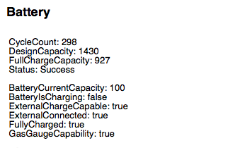

Mine is like this, but I don't feel it is good enough. If I leave it without charging overnight it loses usually 10~15% without any use, with ou without jailbreak, restored as new or from backup...

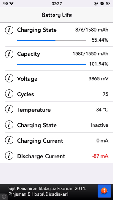

This is my current jailbroken iphone 5s battery capacity. Quite weird the capacity...
Batterylife from modmyi repo...
Nothing bad about your battery capacity, but a 10-15% overnight is not normal at all. It should be around 2-3% (on mine about 1% in 7 hrs).
It is something related to your software ....

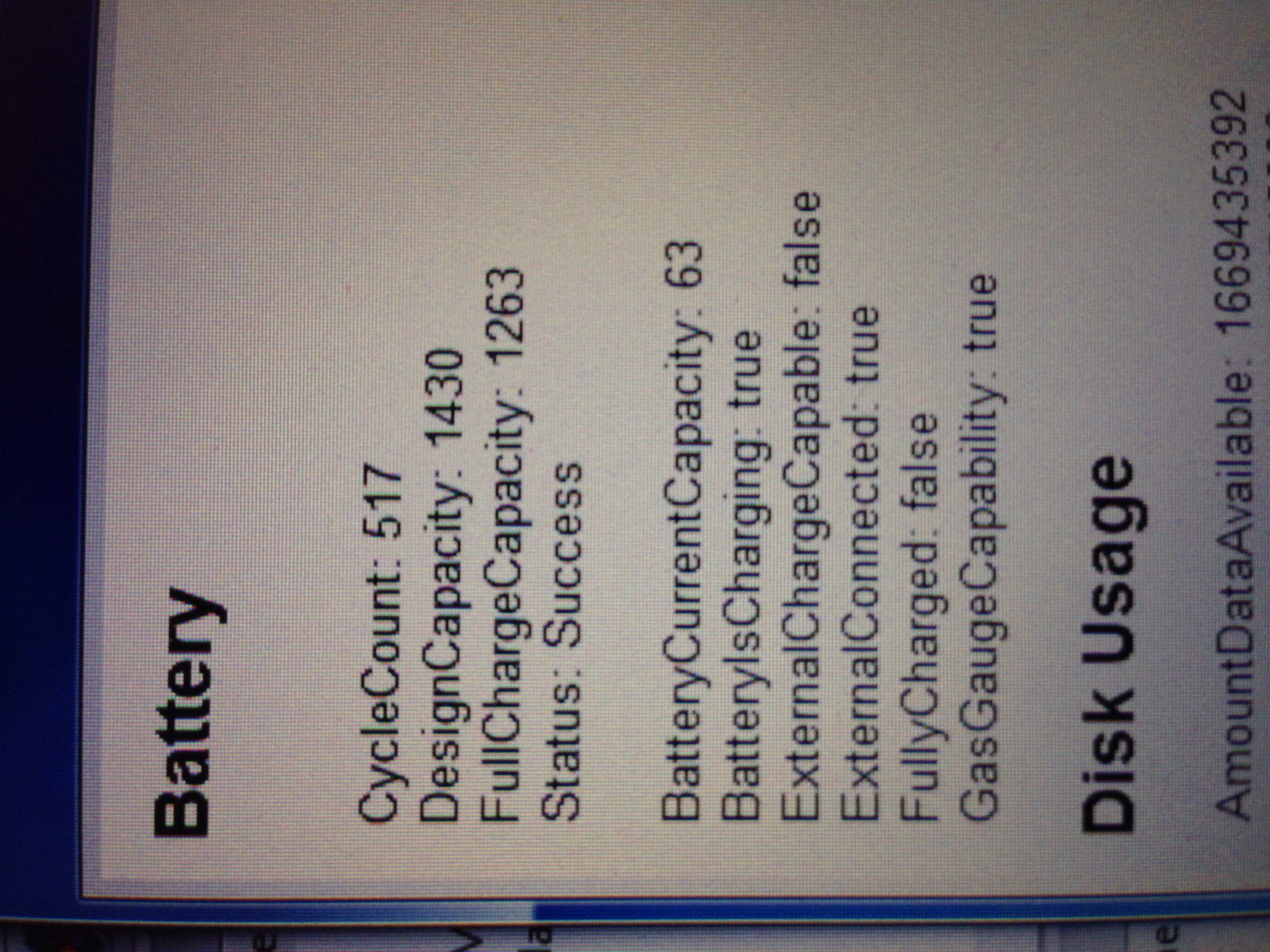

This is my battery now after 517 cycles. Think it still appears to be pretty good.
