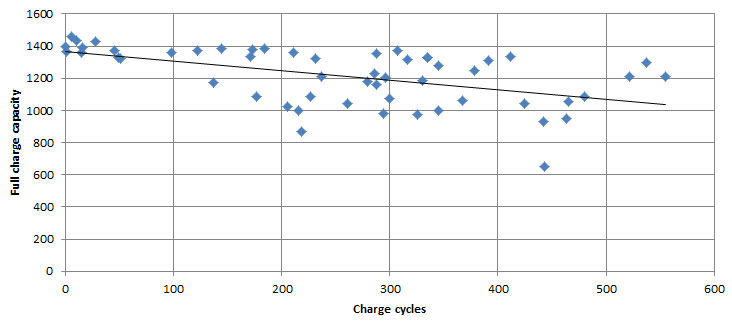

Yeah, so? Use as many data points as you can gather and plot capacity versus age and you'll have a pretty general view of how battery capacity degrades over time. Every data point is useful.
I think it's not really linear ... And again I warn about the grossly accuracy of this software.
It's probably not the software that is inaccurate, but the battery reading itself (if I had to guess internally done by iOS itself).

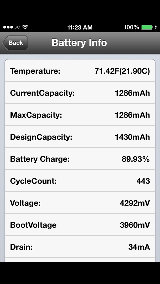

Mine is showing pretty good capacity yet for 443 cycles. I've put the phone though it's paces also! I've drained the battery gaming many times and I ran a lot this summer with it using nike gps while streaming radio on hot days. Also I was jailbroke on ios 6.1 and I themed and had tweaks and the phone was great. Was still getting 6-8 hours of usage.
Enter ios 7.0.4
Right away I had weird percentage drops while using LTE but it was mostly unaffected when I was strictly using wi-fi. The meter would drop in 8-15% chunks then sit there a long time or just shut off then I'd power it back on to find it at the previous percentage. I've seen countless posts about this exact same thing. I've gone though a few full cycle charges now and it's gotten a little better but when I'm out and about using cellular data it still tends to do it once I'm under 50%. Funny thing is it lasts the same as before if I'm only using wifi. I get on average 7 hours of use if I'm at home on wifi and doing light things with the brightness between 25-50%. Light things meaning web browsing, Twitter Facebook and a few apps. When I'm out and about I can get maybe 3 hours on LTE doing the same things before things go haywire with the percentage drops and/or it randomly shuts down. Never had this problem on ios 6.1! I don't think I have a defective battery. Also my phone was one of those first refurbished ones from AT&T. Got it for 99 bucks. I figured it was one of those new ones that had a nick in it. Sure enough it had a couple in it! Big deal! So anyways I'm back jailbroken on ios 7.0.4 and still getting good battery as long as I'm near wi-fi!! Standby is same as ever too. Drops 3-7% overnight sometimes less or a little more.
