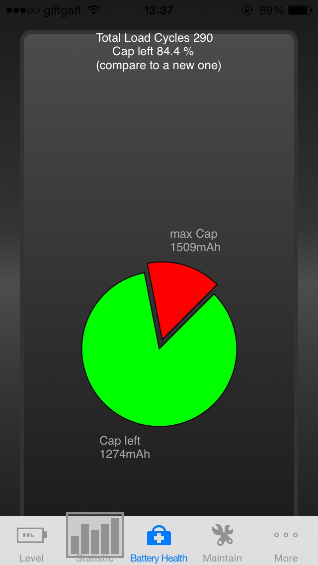

iPhone 5 Battery degradation - Does it look right?
My 5 is 15 months old. I'm at 270 cycles and 1250 mAh according to battery doc.
That's about 86.7% of new capacity. Not bad, but I definitely notice the missing 13.3%!

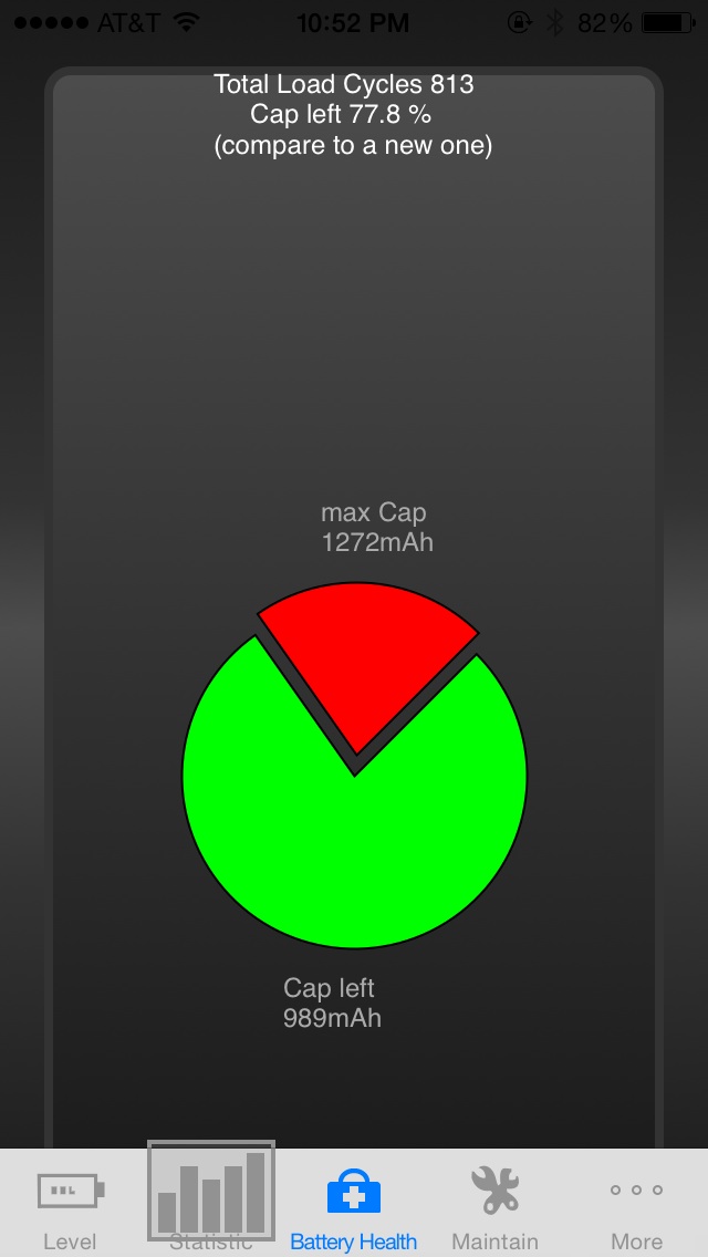

After 20 months of use I'm at 813 cycles with 1272 capacity still left on my iphone 5. Battery still dies after 1% surprised it has held up this well and still going.

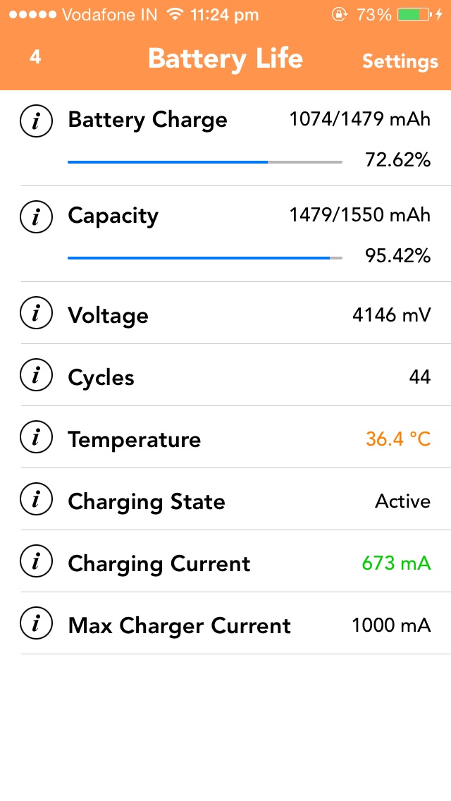

Battery degraded much in just 44 cycles?
Is this normal?
I think you guys worry too much about numbers. The important question is does your battery last as long as you like? Can you get through a day without having to charge? What's your usage patterns like?
That's fine. 95% is expected. Out of the box it could have been already at 95%
I get 4 hours of usage on 3g while using whatsapp on lowest brightness level. And apple quotes that the battery will give 9 hours of usage!
