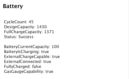

iPhone 5 Battery, this is replacement iPhone and it is 5 months old. Charged almost every day
CycleCount: 122
DesignCapacity: 1430
FullChargeCapacity: 1373
Status: Success
BatteryCurrentCapacity: 49
BatteryIsCharging: true
ExternalChargeCapable: true
ExternalConnected: true
FullyCharged: false
GasGaugeCapability: true

My charging habit:
- Charge it whenever convenient unless its above 50%, but try not to keep it at 100% for too long.
- Don't always charge it when I go to bed to avoid keeping it at 100% for too long.
- I find it ok to unplug above 80%
- I would top it up on the move with a mobile battery
Charging when the phone battery is not zero is ideal. You don't want to go to 1% or zero more than every few months. And when you do, let it charge to 100% and then some. That is how the battery meter is calibrated.
But there should be no worry leaving it at 100% overnight. The Apple charging circuit prevents overcharging. I found that on the Apple web site somewhere.
Here is my iPhone 5, a refurb model from a few months ago. I leave it on 100% overnight, but rarely let it go below 30%.
So if this app is valid, I'm at 96%

Li-ion batteries lose permanent capacity with cycles...and also just sitting around on the shelf
It really does not matter what this software reports your battery as because Apple has their own test which they determine of it is defective or not. There will be some degradation after one year.

Actually is a very correct and not unexpected report.
New batteries need a little time to calibrate.
