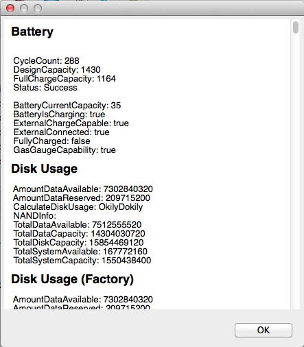

iPhone 5 bought on Launch day 2.11.2012
Cycle Count 294
Design Capacity 1430
Full Charge Capacity 984
oh I guess it's time to go and change my battery or my phone. I still have 1 year guarantee from my network provider Orange. Wanted to change on the 1 year of guarantee from my Apple but i wasn't sure if it's the battery thing or the IOS 7 and right now i've lost the apple guarantee. you think they will change my phone or my battery?
Few weeks ago had 267 cycles and battery full charge capacity at 1100 or something like that.
And now it's only 984. I think it's bad :(
With 3g on is draining like crazy. If i close 3g and working on wifi everything is going well.
In my opinion the App that we are using is not very precise, just like the battery percentage indication in your iPhone.
The first time I used it, the result was that my battery was at 93% health. One week later it was around 80%. So it is not very reliable...
That's also my case.
But even if the app it's not accurate i think it's close to that result.

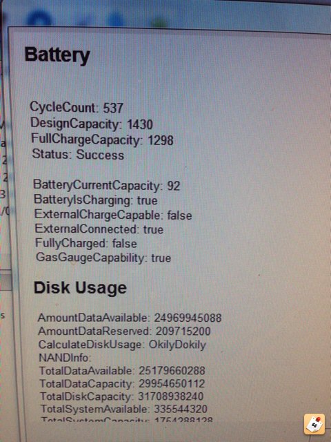

I think I need to get my battery replaced. I've had my iPhone 5 since September 2012
CycleCount: 442
DesignCapacity: 1430
FullChargeCapacity: 931
Status: Success
BatteryCurrentCapacity: 82
BatteryIsCharging: true
ExternalChargeCapable: false
ExternalConnected: true
FullyCharged: false
GasGaugeCapability: true
We don't really know how accurate the reading of iBackupBot is ....
In my case variations are all around 1100, so I think it's the real value.
I suggest to check it when the phone is almost full charged and then when it's below 20%.
