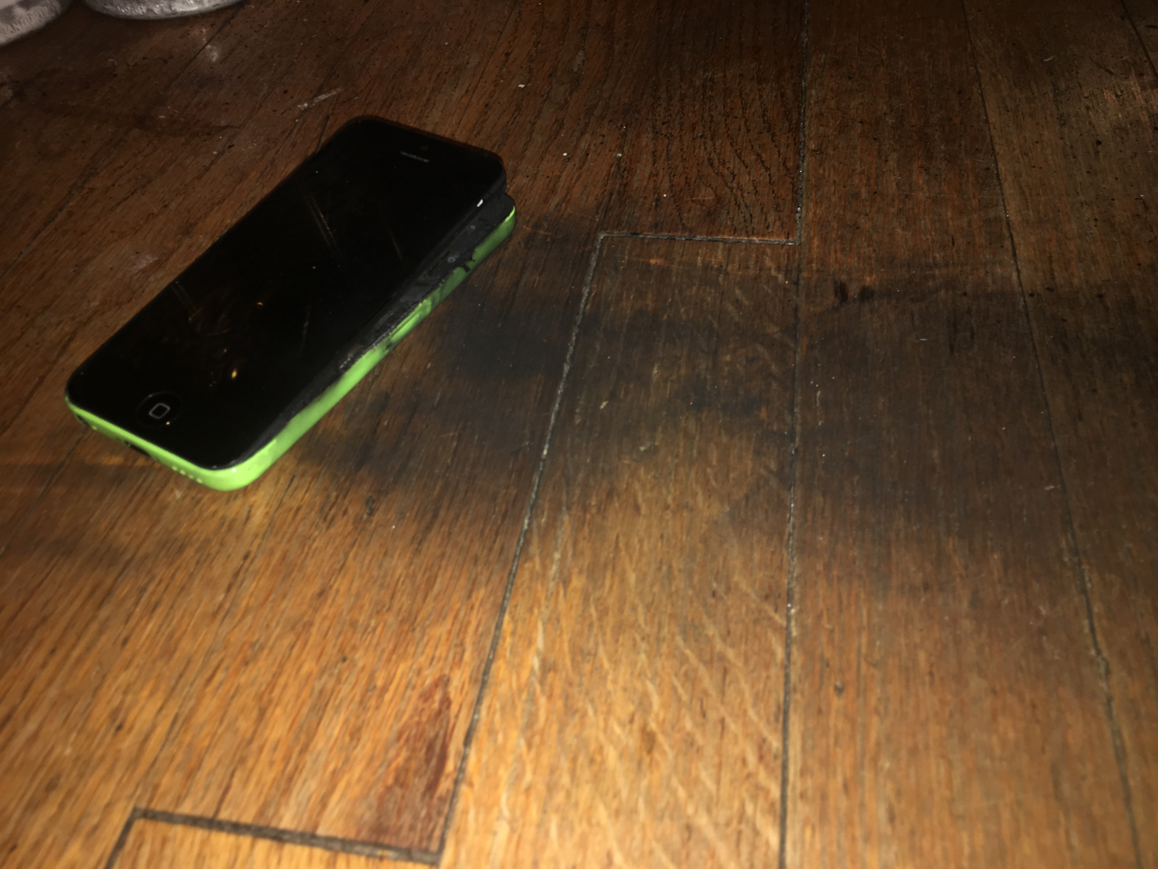

BE CAREFUL! MINE CAUGHT FIRE!!!
I just had to add to this thread to hopefully prevent this from happening to someone else.
My wife's 5c popped out of its case (the corner) once before about 2 years ago. I followed the instructions in this thread, placed it face down on the table, pressed and it popped back in. It was fine.
Last month she dropped it and it happened again. When I tried the same fix it BURST INTO FLAMES!!!! I heard the same pop but a second later SMOKE AND SPARKS SHOT OUT FROM THE SIDE!!! I quickly swiped it off of the table onto the floor where it BURNT AND SMOKED LIKE FIREWORKS for another 10 seconds!!!
I called Apple, freaking out, and even though the phone was a year past it's AppleCare protection plan, Apple replaced it! They said when customers use the phrase 'caught on fire' they take it very seriously and wanted to do an autopsy.
So if you are anywhere near an Apple Store PLEASE don't try to snap it back in yourself! Either way, do a backup before you try anything. Luckily, I had just done one 10 minutes before! Phew!

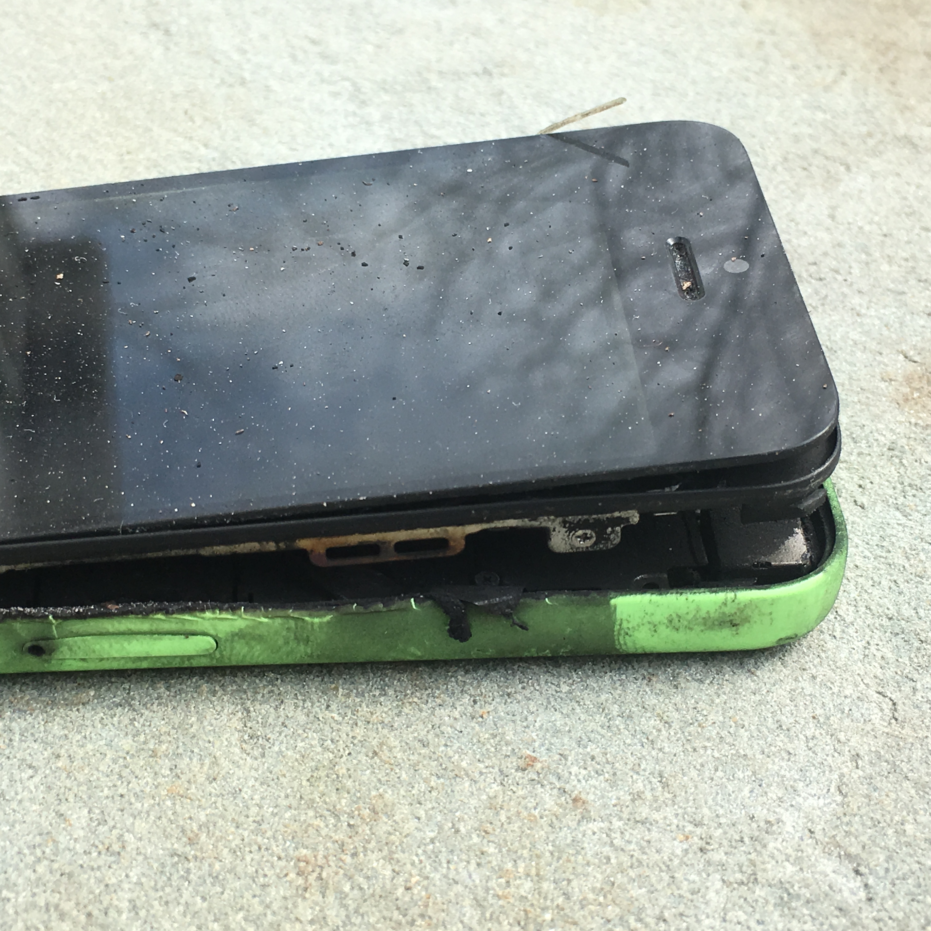

View attachment 696970 View attachment 696971
You're lucky that you didn't suffer any serious damage to yourself or your home. Lucky that Apple replaced it for you too.
I suspect that you may have damaged the battery when you tried to squeeze it back together. Perhaps something got stuck between the case and the battery and when squeezed, it punctured the battery and caused the fire.
Either way, glad you're ok
