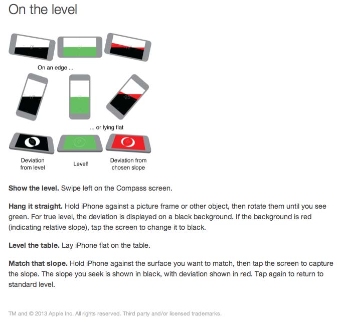

I'm just concerned they may try to feed me the same info as th GB today and basically say that the phones are fine and you need to 0 it everytime so the phone knows the correct level.
The iPhone users guide is VERY clear how the level should work:
http://help.apple.com/iphone/7/#/iphb5af8af5e
If a genius or online advisor says otherwise refer them to Apple's own documentation!
