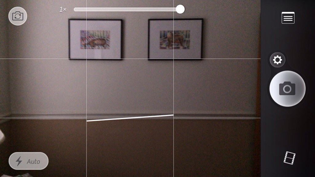

Camera+ horizon line is still noticeably off on my phone and no, my house is not slanted.
