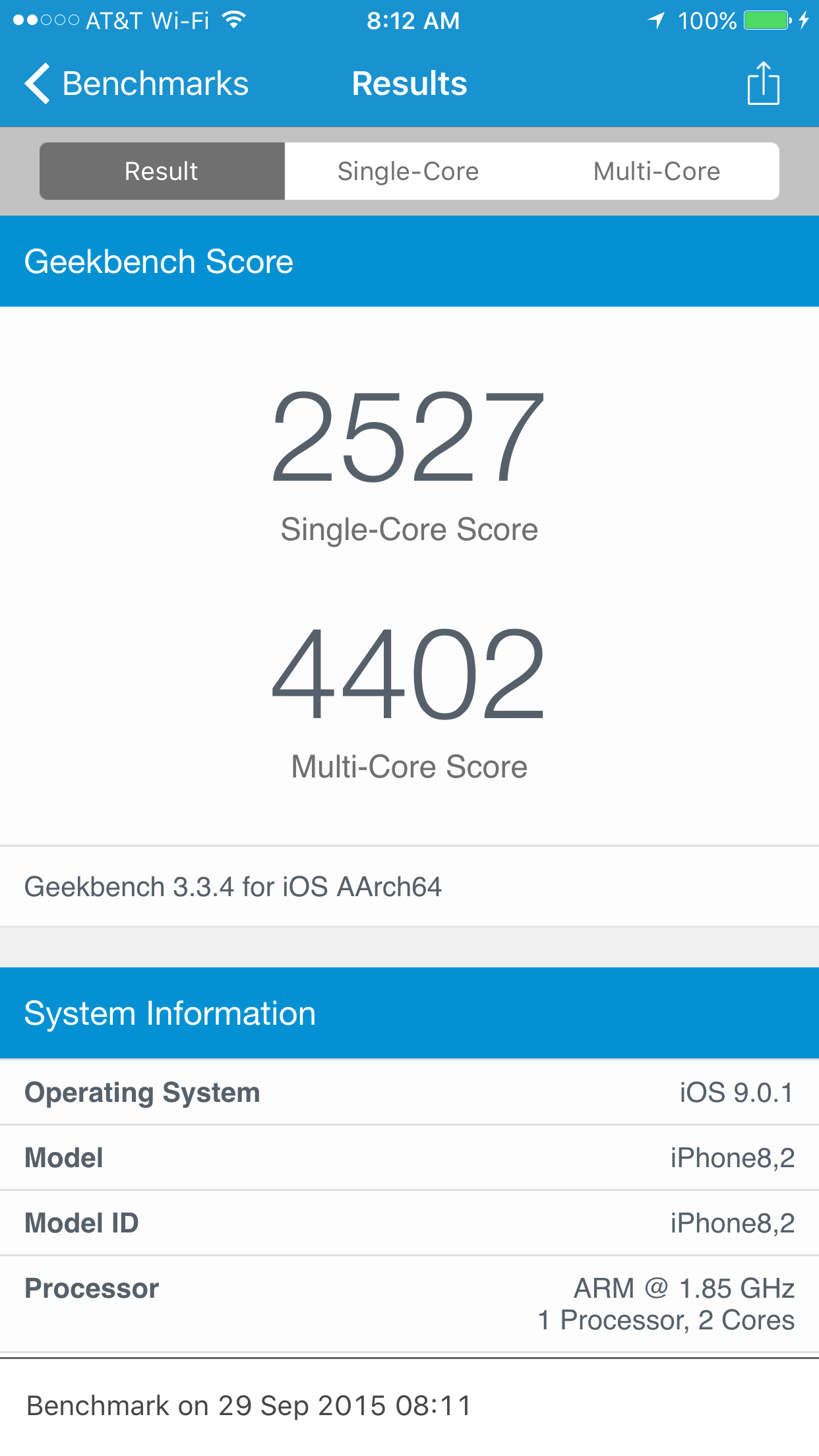

I have the TSMC chip in my 6S Plus. Happy with it as they really know their stuff. If you all want some benchmarks, let me know.

That TSMC chip son! 🙂
