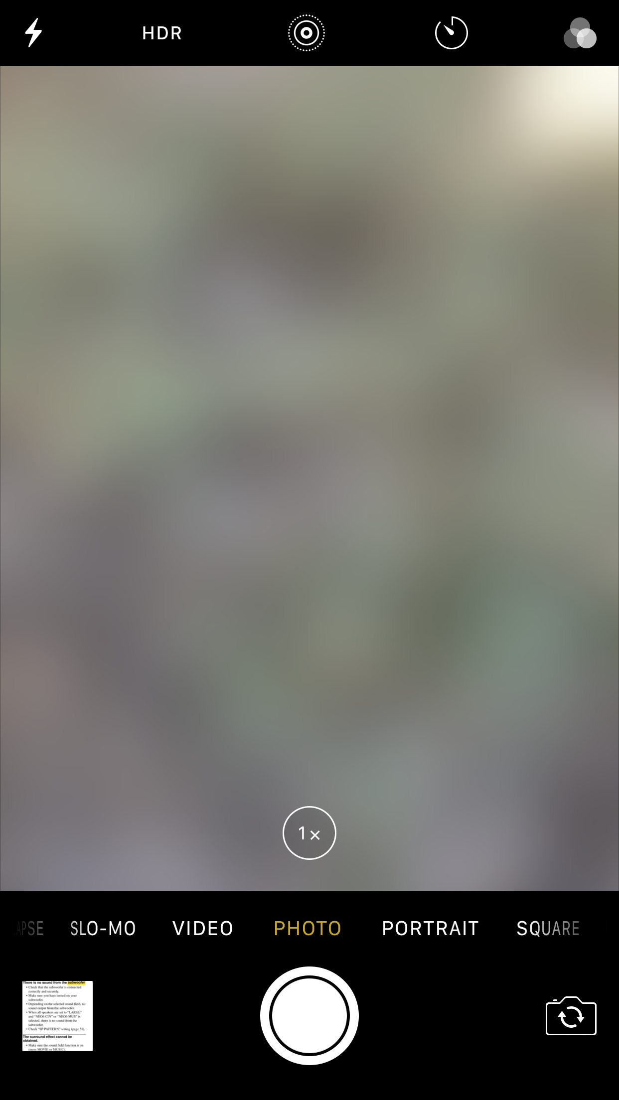

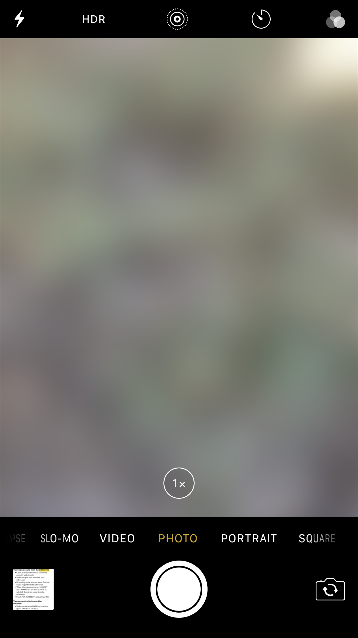

I was hoping that iOS 10.1 would solve this once and for all, but I'm still occasionally having this camera issue, e.g. camera app opens and it has trouble focusing (yellow square comes on and off) and switching cameras doesn't help.

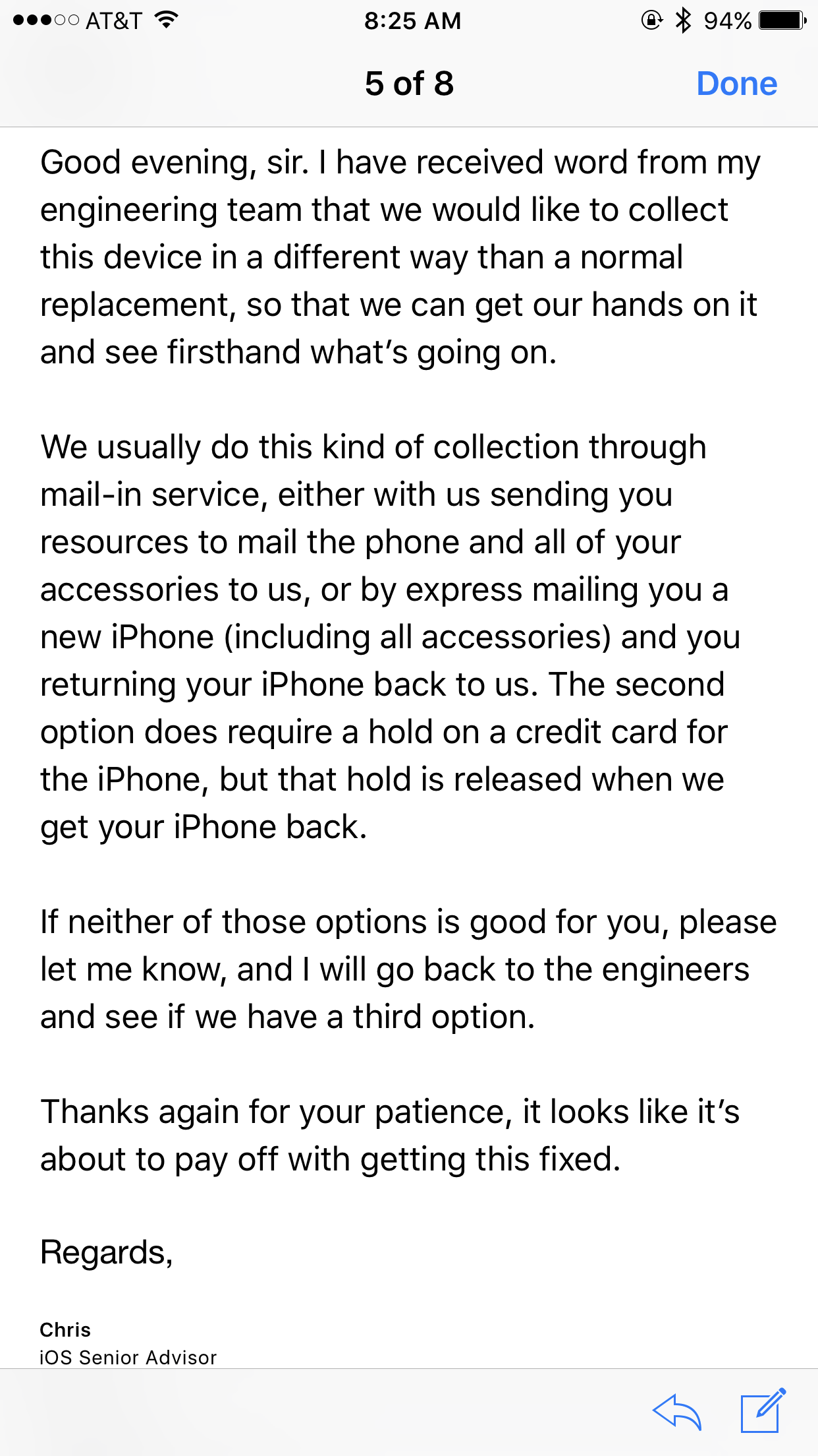

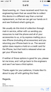

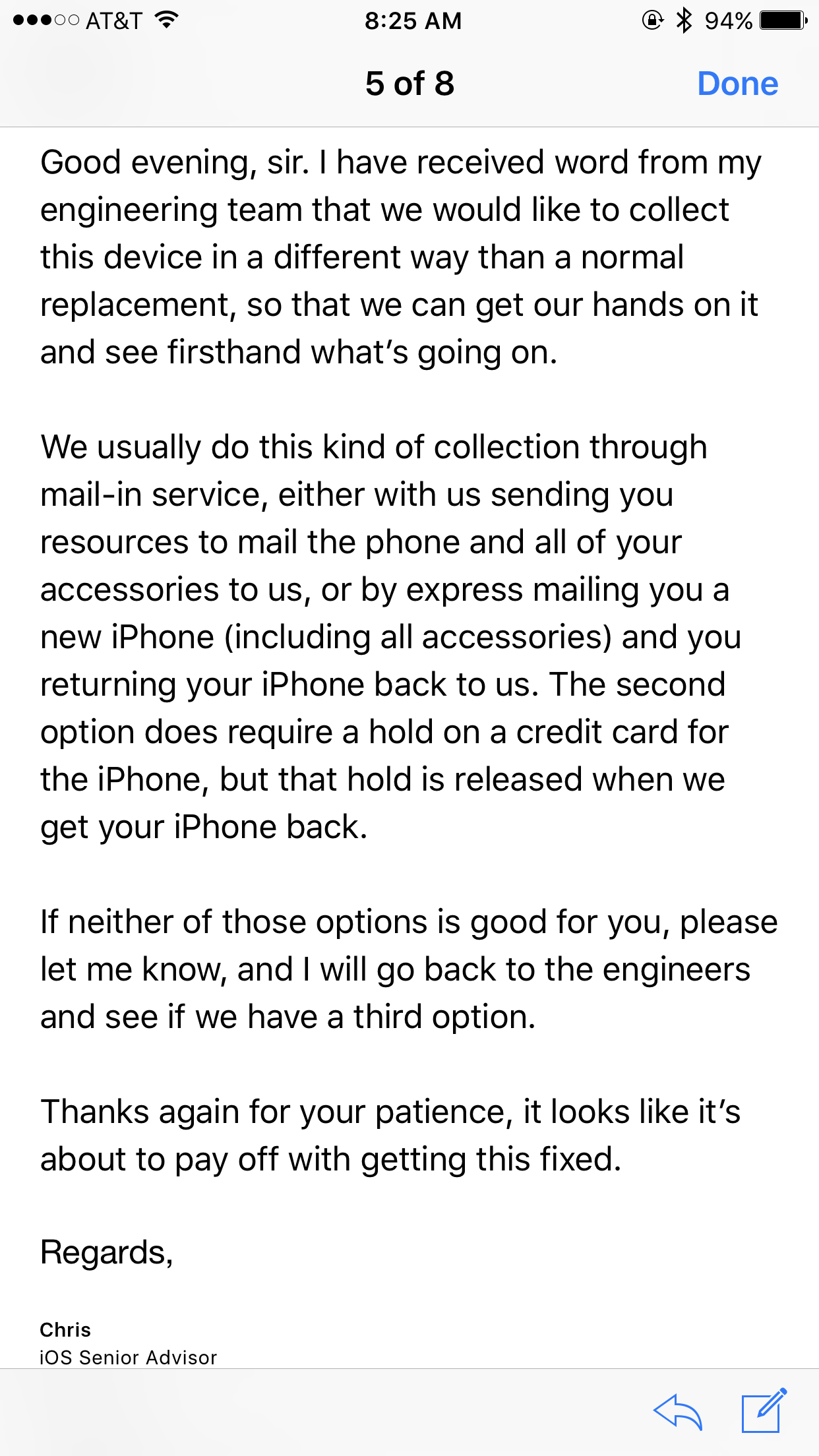

I am on my third phone (all having this exact issue) even after 10.1 update (all phones set up as new). An apple senior advisor had me log some files so he could forward them to the engineering team. This is the response I just got back.
Wow. This is crazy three new phones and you've done what I was told e.g. restores and setup and new and running 10.1 and still having this issue!
Thank you for sharing the reply you got.
I wonder if I can contact Apple Support again with my case number and see if they will do the same thing. I've spoken to them twice already and they kept saying they have not heard similar complaints.
It's all well and good that they look at your phone and provide you a new one, but I hope this fourth phone doesn't have the same issue.
