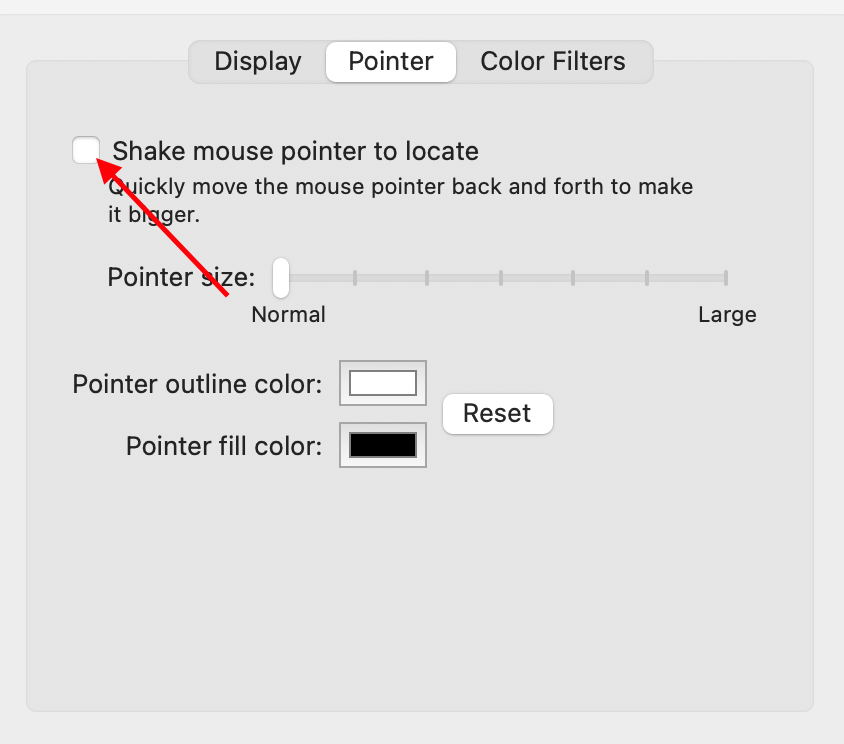

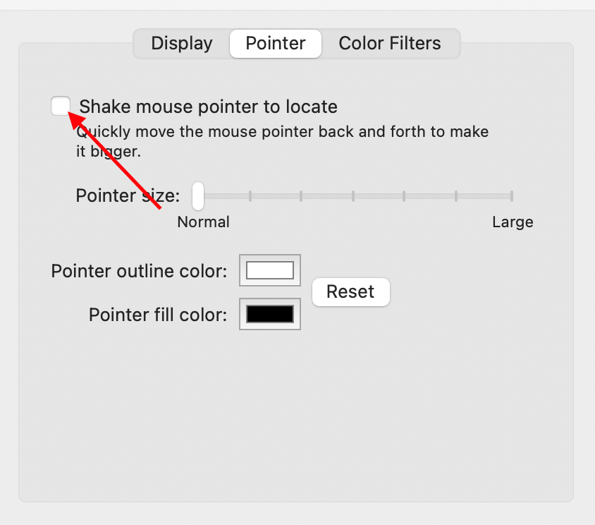

This is a relatively known issue, due to Apple's way to scale UI.
Turning this option off to end this cursor behavior. It's under Accessibility -> Display
Reactions: onelove4everu
Hi thanks ! But even with this option turned off, I still have some lags (rarely). It seems that killing the bluetooth process solve tempolarily the problem. This is why I think it's software problem.

I have the exactly same problem!
Magic keyboard 2 and AirPods 3 both working fine!
But the Magic Trackpad 2 is exactly how you described (the mouse cursor is sometimes « jumping »).
The cursor kind of takes a few milliseconds to respond and then jumps.
Just bought mac mini m1 16gb 1TB, MacOS Monterey.
If I connect the Trackpad 2 using USB-A, then the « jumping » disappears.
I have disabled the "Shake mouse pointer to locate", turned on and off the trackpad, but nothing has solved the issue.
